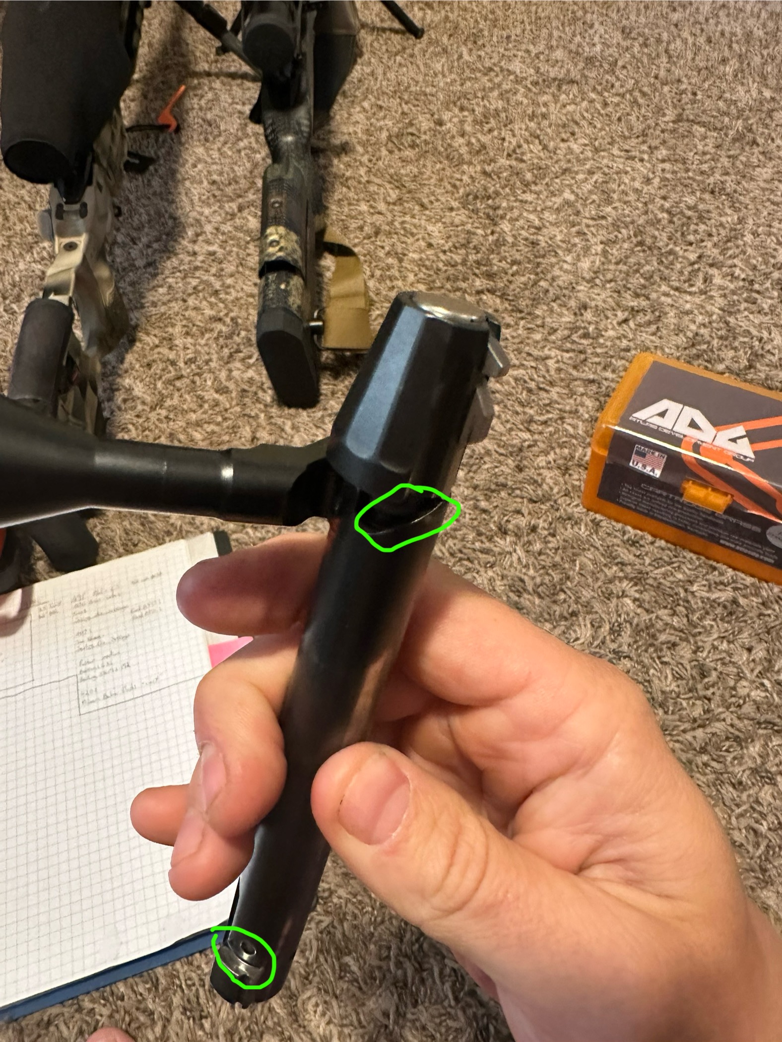

No picture but the main area is the rear of the bolt lugs. You could place a dab on the cocking piece. Borrowed from MDT.

I put LB 8012 on the back of the bolt lug and the rear cocking area. Additionally, when cleaning the bolt body I will wipe “Free All” penetrating oil on the body and wipe it off. Found that trick out by accident a few months ago.

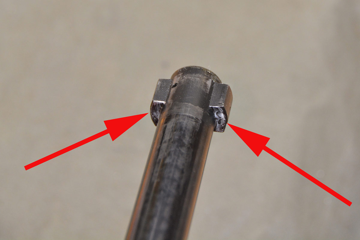

In the old days, it was well known that XP100 bolts would gall without a slight dab of grease at the back of the locking lugs. Always worked and never an issue UNLESS,
In my mind, if you did not clean them often, they would pick up grit and grind away the action as you worked the bolt. (We shot a whole lots because our loads were light and barrels simply did not Seem to ever wear out)
I still follow this practice but as said, I make it a practice to throughly clean the outside of the bolt body, lugs and action to rid all of the old grease before applying fresh.

This is Mil-Comm high-temp lithium gun grease, it's made for barrel nuts on machine-guns and stuff. Works great. Like was said before... Just a little on the back of the lugs, a little on the threads of the firing pin shroud after you remove it from the bolt body, and a little bit on the cocking piece if you want?
