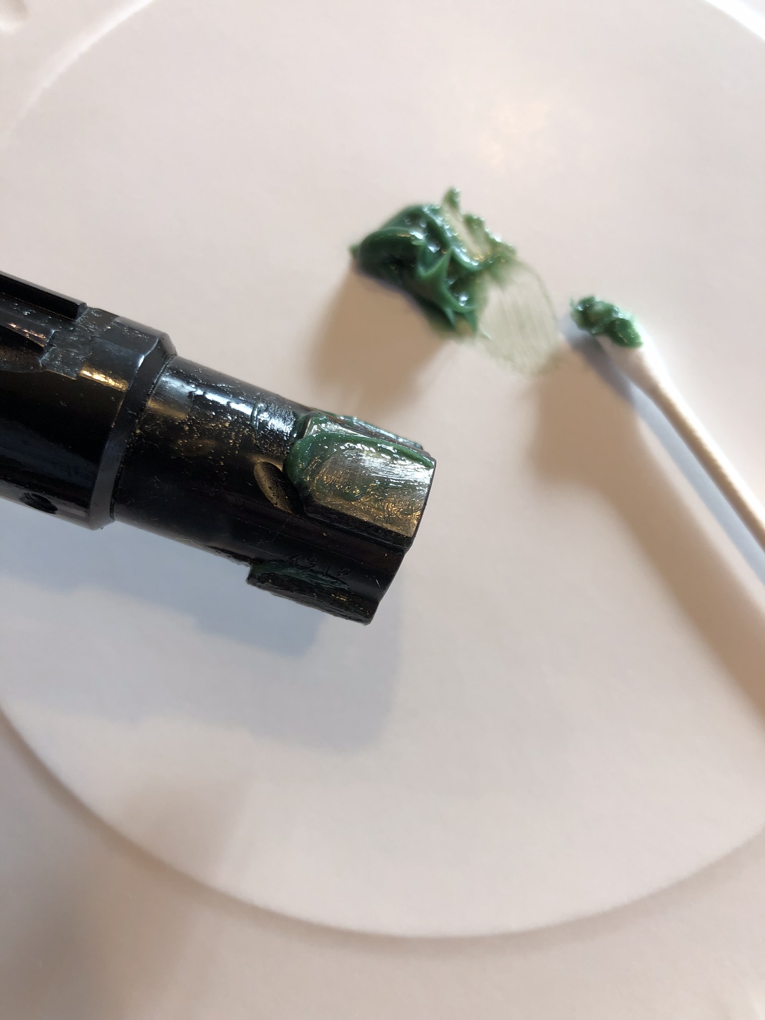

Pretty much any grease on the bolt lugs and cocking surface will work. For an AI or any coated bolt, the body shouldn’t need much of anything but at most a very thin film or oil or grease. By thin I mean a couple dabs spread over entire body and any excess wiped off. There shouldn’t be any visible build up of grease on the body. It actually makes the bolt slower in my opinion.
If were talking cocking cam and threads into the bolt body I use Loctite C5-A copper anti-seize lubricant. Also use this stuff on the barrel threads when installing a barrel (AI excluded).
Copper in the grease really helps slick up some of these more high friction parts and smooths out the bolt throw.

I have some gorilla grease that's non-toxic and biodegradable. A very, very thin coating works even in the cold.
Mobil 1 is my go-to for oil. If I need a lighter oil then the Lucas stuff with the needle applicator works well and it doesn't flash off with heat.

Mobil 1 synthetic red grease on the lugs, wipe the bolt body with FP10 or some similar thin film lube, and keep the bolt stop channel clean. Should make the bolt feel very nice.

The oil and grease seems to work well. Will this be something I have to do before every match or something that lasts a while. My hornady HF extreme spray normally gets used once a match bc it does wear down and feels gummy. I wipe it off and re apply.
It should last longer than the Hornady stuff. But your results might very
However my favorite gun oil is the Lucas stuff. However I got some “bolt lube” from swannys comp gear and been trying it out. It’s super slick. And be careful when you apply it. It gets everywhere and then you drop the glass bottle. Thankfully it didn’t break or spill when I dropped it.
