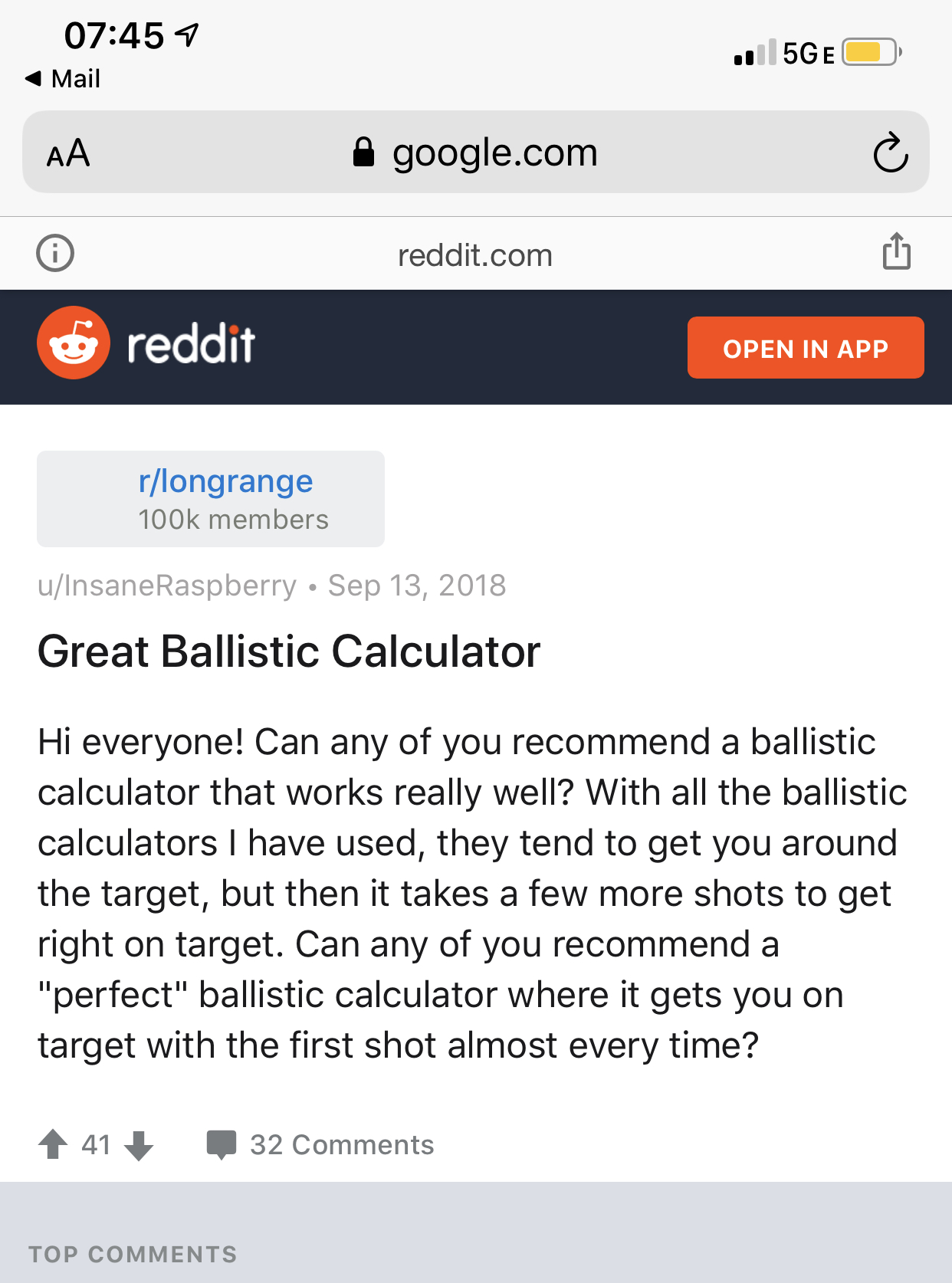

So, would you like to admit now to be a scammer and leave, or shall I ban you?
