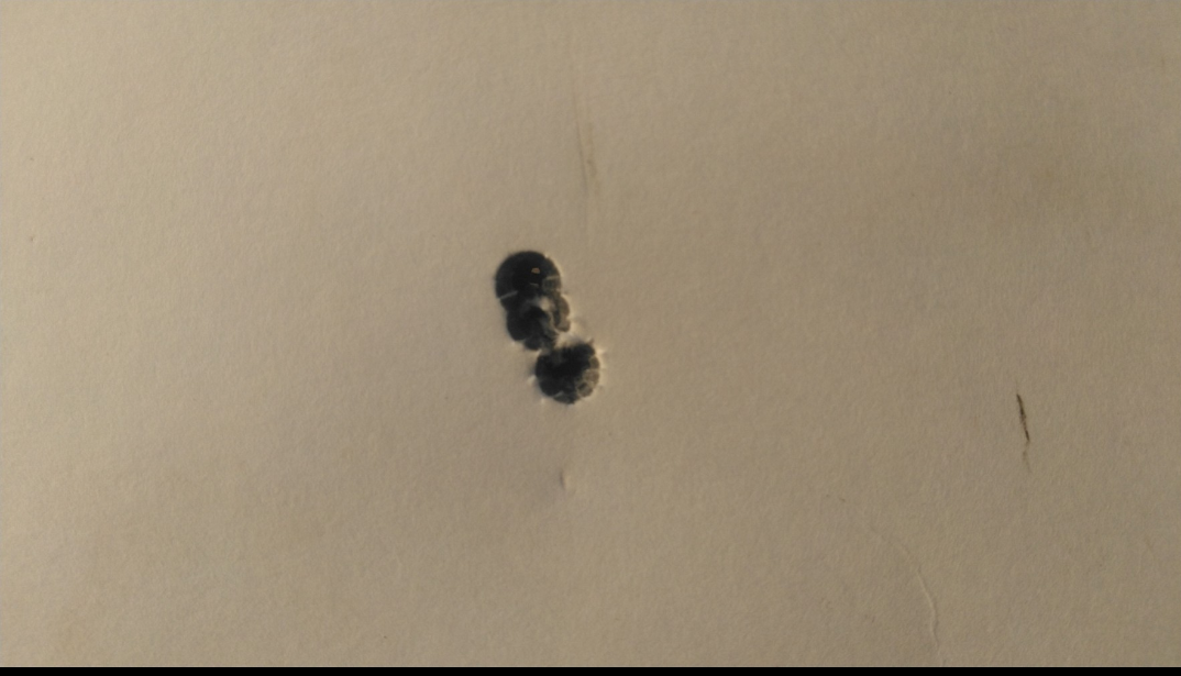

I've had really good luck with Vihtavuori N555 in my 6.5 Creedmoor. This is three shots @ 200 yards. 2760 fps 136 grain Lapua Scenar L.

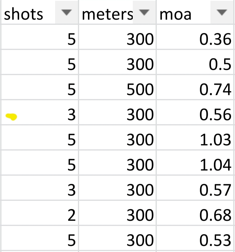

I'm using 43.5gr of N555 with Lapua SRP (CCI #400), Lapua Scenar-L 136gr, COAL 2.854, with great results. I've shots multiple 0.7moa group at 300 meters with a Tikka T3x CTR, factory barrel. Basically, I love the powder, it's very clean and got greats results at very varying temperatures.
