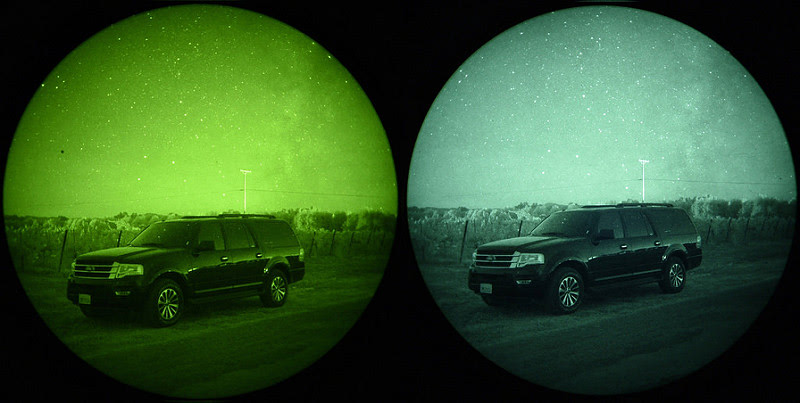

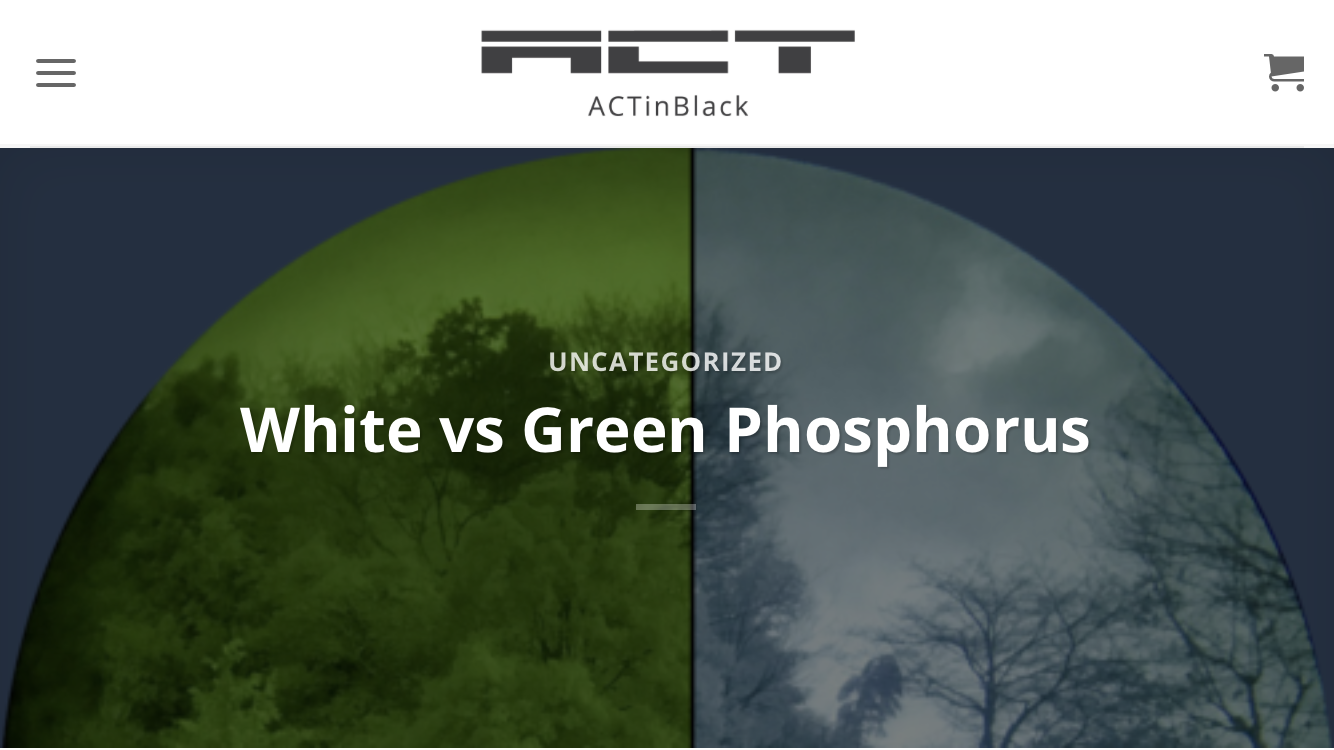

White looks better, green is supposed to show more. It's green in the first place because the human eye sees more shades of green than any color as well as movements in the green spectrum (survival shit from back when were on the menu).

I’m new to NV. I’ve played with green with my friends setups, and I ultimately went white. White just seems so much more pleasant to look through. Green just made me not want to wear them that long. White, I can’t wait until the sun goes down.
I’d never buy another set of green tubes again.
