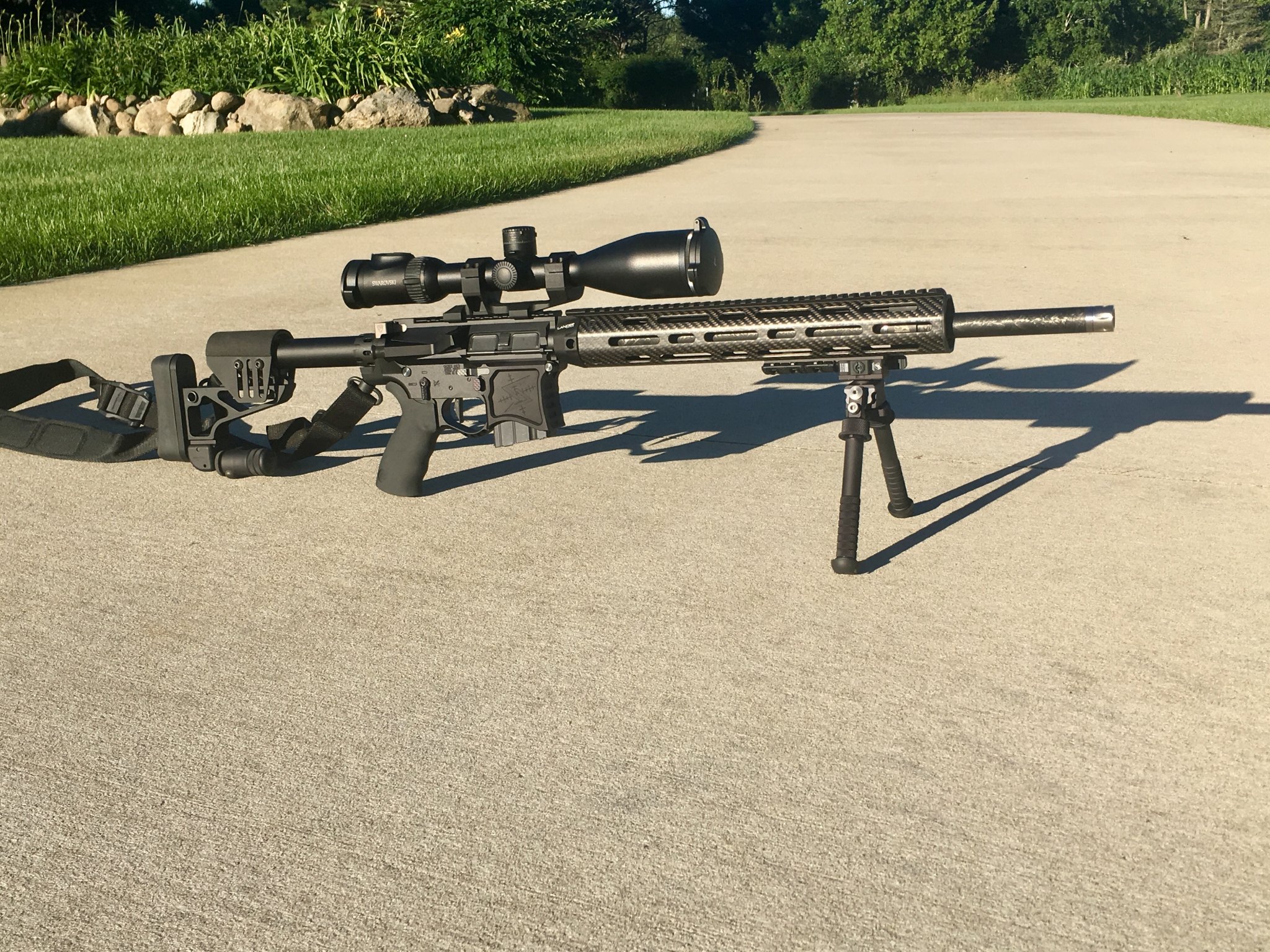

I have a Grendel too and it wears a Tangent Theta:
With Meopta, if memory serves me right, the MeoPro scopes are assembled in the US, while the Meostars in the main facility in Czech Republic. The company is US owned though. Of the other two scopes you mentioned, VX-5 is indeed made in the US, while the Trijicon Accupoint is made in Japan.
WIth the 3-12x56 Meostar, the R1 model has FFP reticle, while the R1r has SFP reticle. Pick what works for you.
