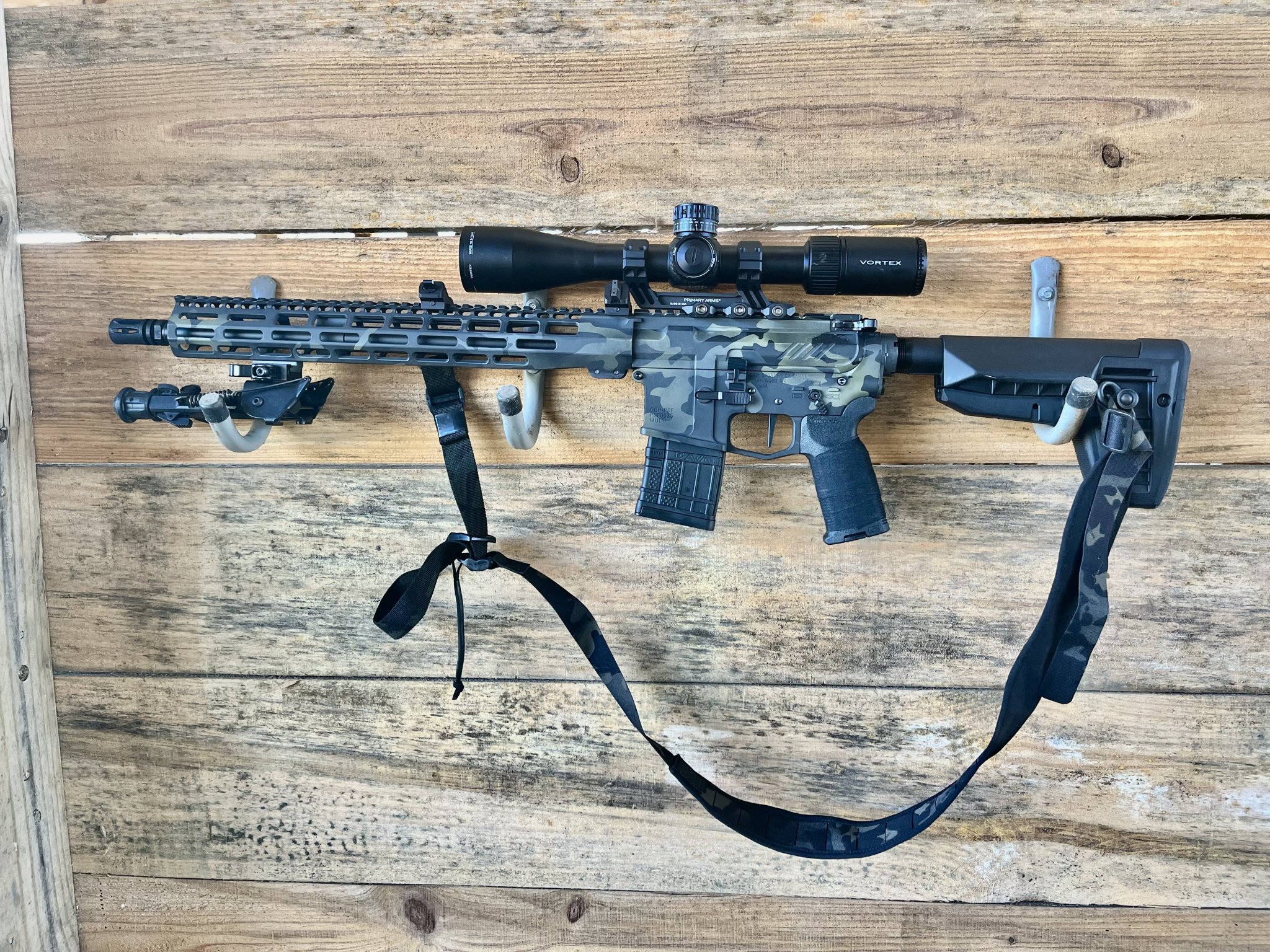

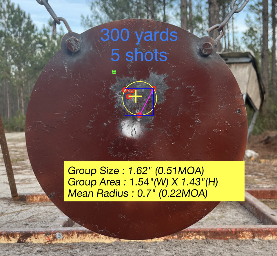

Finished this one up the other day. Wanted me a shorter and lighter SPR’ish 5.56. Couldn’t find much on the Douglas barrels by CLE in the Tactical/Recon profile so figured I’d share. Btw another member on here I did talk to that had great results with his barrel. I just finished a light break in on the barrel, cleaned, fouled, and started load work up with 1x LC brass, I think it’ll be a hummer. Going to test it out a little farther with this load shortly to see if it’s repeatable. Oh and the gun is extremely flat and smooth shooting with the Vltor A5 system even being a mid length gas system I really like it!
I will possibly swap out the optic to a lower power & smaller package.
1-10 lpvo (open to suggestions) or 2-10 (Trijicon credo). I’m trying the trigger, wanted to give it a spin.
Build list attached
  • BCM Mod 1 sopmod stock
  • Cmmg zeroed lpk
  • BCM .750 gas block
  • Grey Ghost Precision MK ii multicam cerakote builder kit
  • CLE Douglas 16” barrel
  • Blackout defense 3lbs flat (replaced now with Larue mbt2-s)
  • Magpul k2 grip
  • Toolcraft premium bcg headspaced to barrel
  • BCM mk2 extension
  • Vltor A5 Buffer and spring
  • Bootleg gas tube
  • Bootleg A2 Flash hider
  • Breekarms warhammer mod2 charge handle
  • Vortex Viper PST ii 3-15x44
  • PLx 30mm 20 moa mount
  • XS XTI2 DXT offset irons
  • BCM quick detach mount & swivels
  • GGP SD Mega GT sling

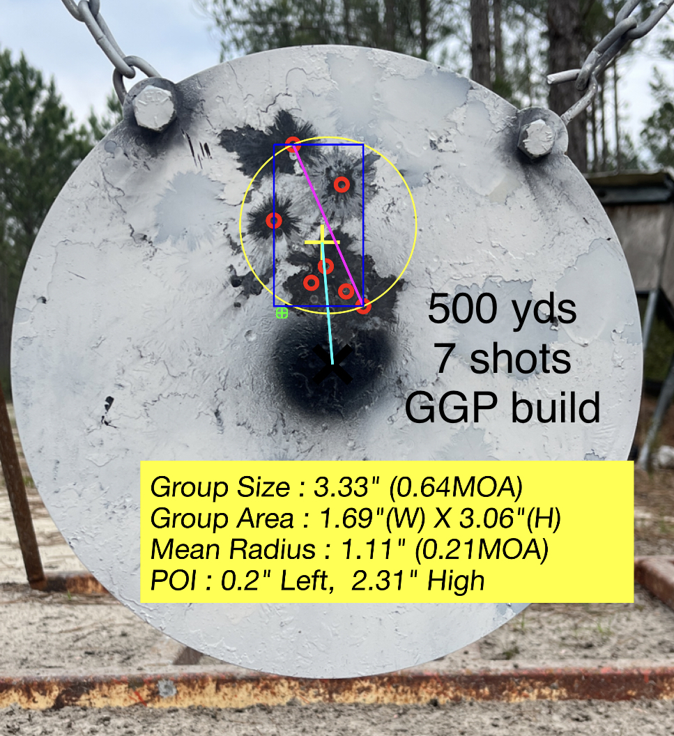

I built a 6 ARC with 18” Proof off of a GG set. It’s 1/2-5/8 MOA with Hornady Black. Just completed the large frame GG build but haven’t shot it yet.

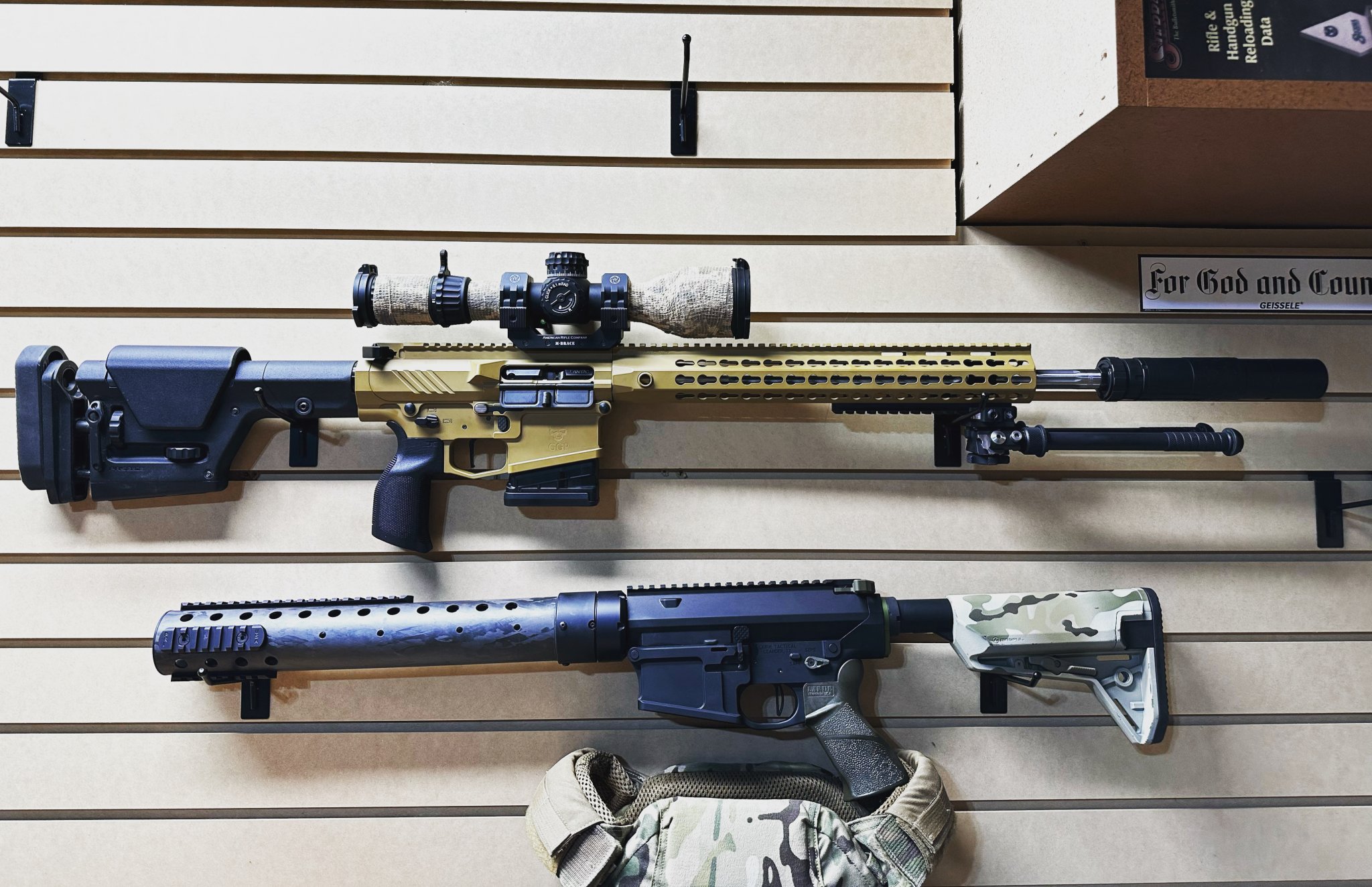

Ive got a couple TriggerTechson on order now, really looking forward to testing the new Single Stage AR15 Diamond in a 20" CLE Match Bartlein build Ina Seeki s Receiver Set I'm working on now. I helped @impactaddict with a similar setup, looking forward to his results as well.
Those 16" CLE Douglas barrels are a great value and solid performers.
