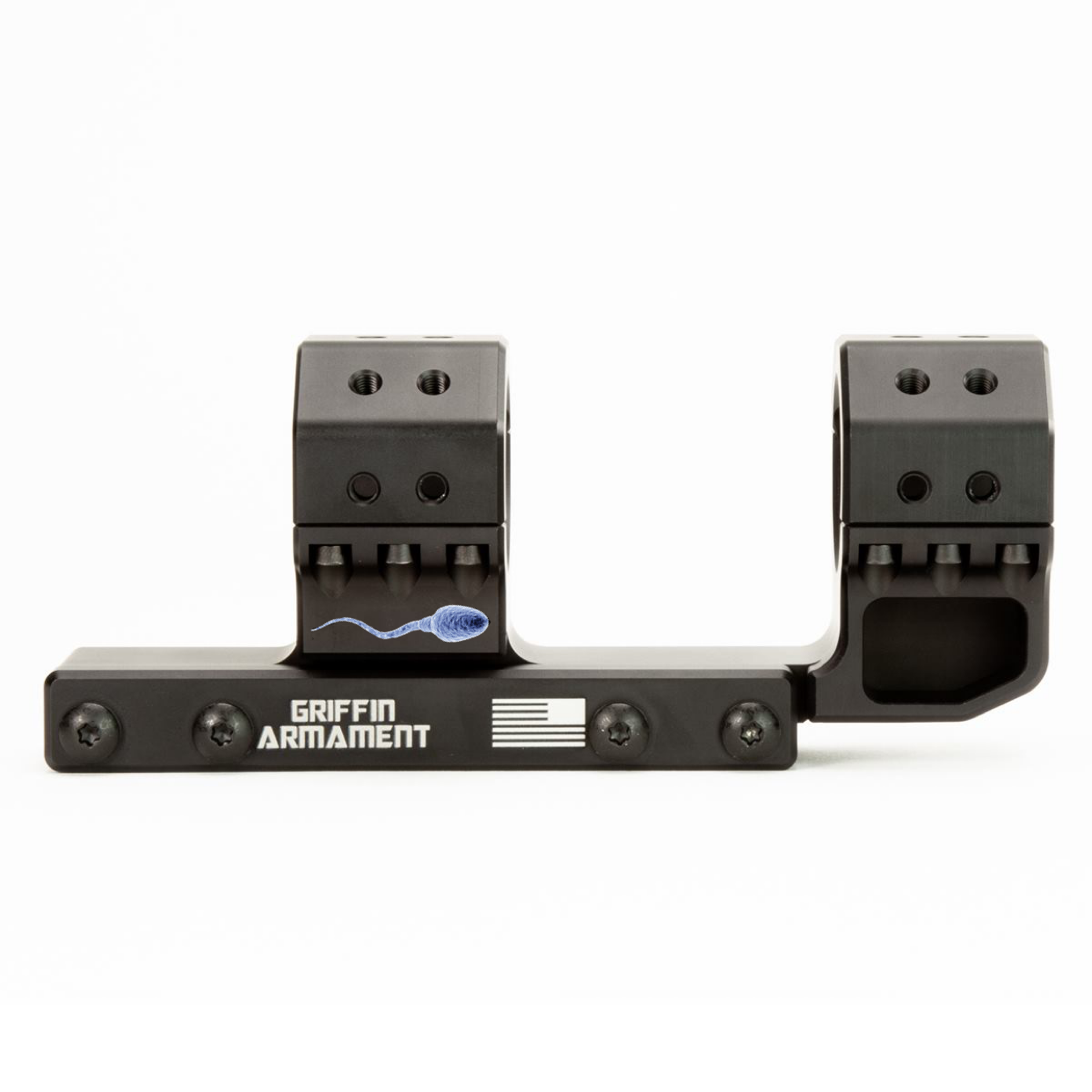

How are the down facing bolt heads torqued?
There is clearance to use a torque wrench. Every mount includes detailed installation instructions and I’m going to be doing a video this week on installation and covering the features in a tabletop video on the mounts and accessories.
-Sam
Regardless of what you may think about IP, et al., the need to remove the mount from the rail to properly torque the bottom-facing screws is a HUGE design fail in my humblest of opinion. Completely eliminates the GA mount from consideration for me.
