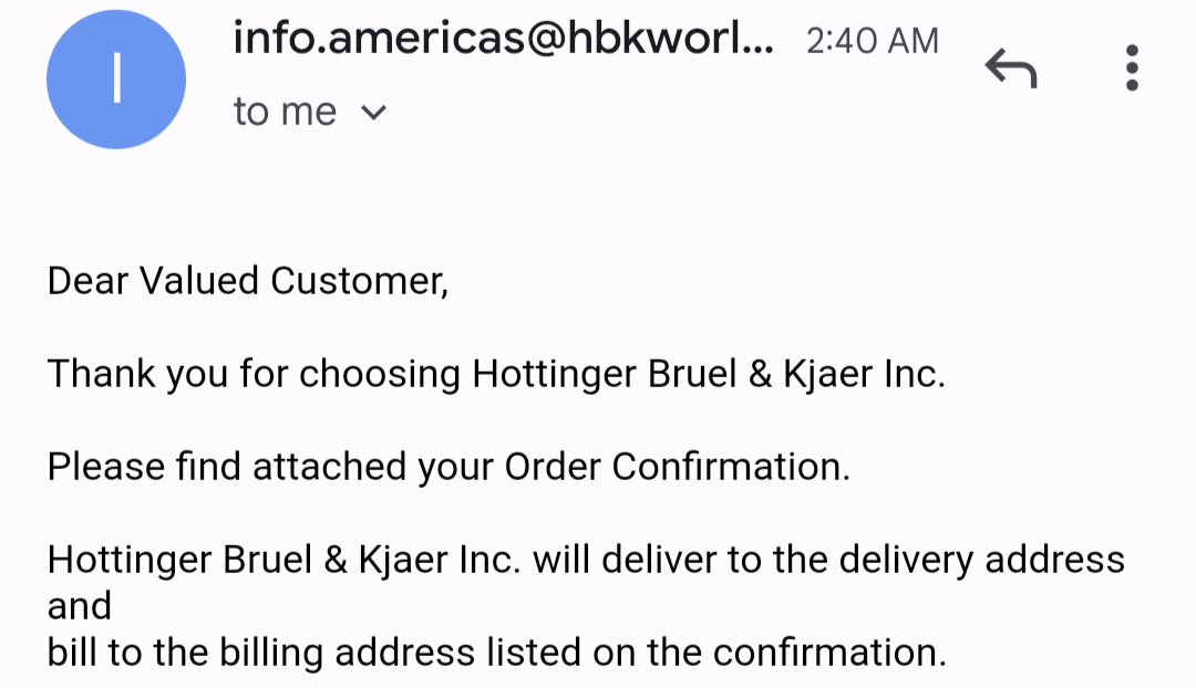

    We never said that the cost of testing one suppressor was more than the pulse itself. It was a phenomenal amount of money. Our line would have cost ~$260,000 to comprehensively test with them- each suppressor on two hosts. We were quoted 240% more money than some other people, and realized that other companies got up to 4 times as much free testing. Two sources each had different amounts of free work and different quoted prices. Our price was the highest price.
    A Pulse system last I looked cost ~$35,000.
    We simply realized that it was a better spend to improve our testing standard. We did some flash testing- we probably won't always do flash testing, but our recent testing involved flash testing and some POI shift testing, so we were testing some different metrics. We have compared weight, length, also added the waveforms and AHAAH data. That addition required a serious enhancement to our testing methods, to capture A peak, Z peak, and Z waveforms simultaneously for the required processing.
