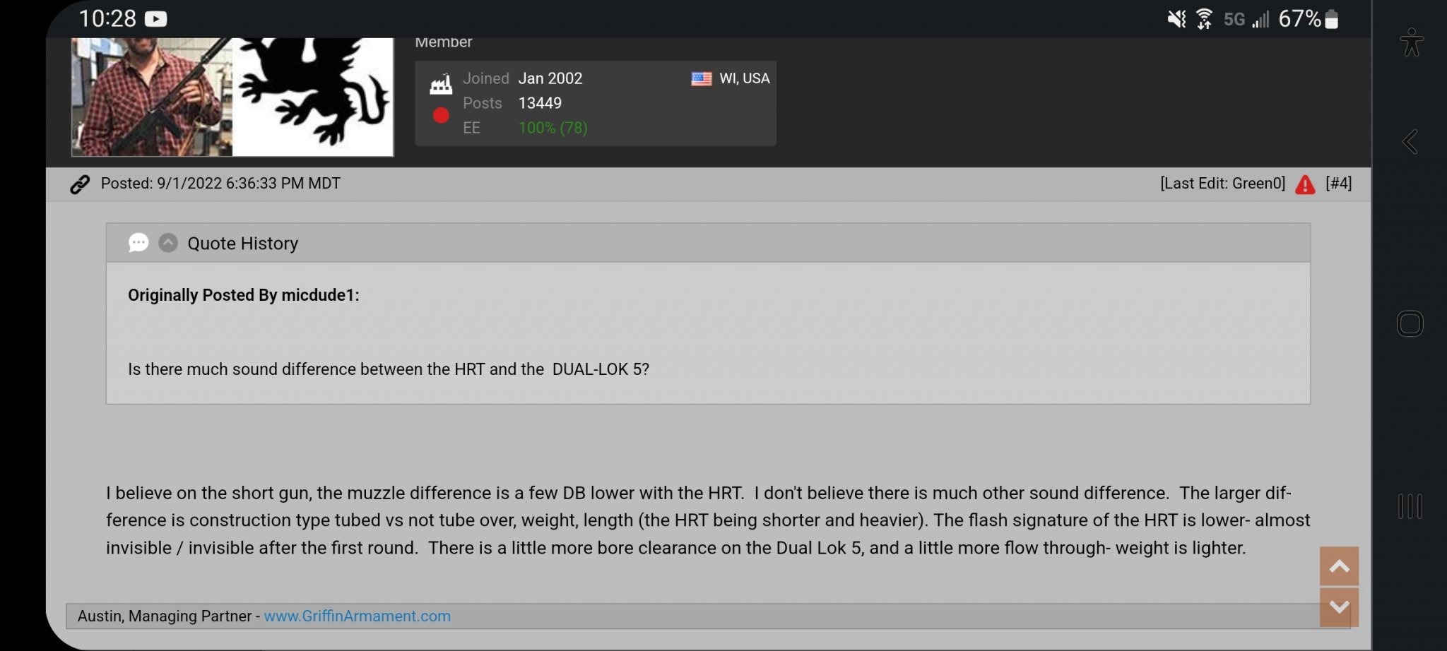

Looking at both of these and trying to figure out what’s the main difference. Both look very similar from what I can see. What am I missing? The dual lok 5 is a little longer but lighter and the dual lok HRT uses inconel. I’m interesting in a deviated 556 can
Dual-Lok 5 Specs:
Diameter:1.5"
Overall Length:6.5"
Weight:11.8 Ounces
Materials:High strength, high temperature, corrosion resistant 17-4PH Stainless Steel
Attachment:DUAL-LOK™ Mounts
DB Rating:(135DB) 11.5" Griffin MK1, (134DB) 16” Griffin MK1
Finish:High Temp Cerakote
Full Auto Rated:Yes
Dual-Lok HRT Specs:
Diameter:1.5"
Overall Length:5.9"
Weight:14.4Ounces
Materials:High strength, high temperature, corrosion resistant 17-4PH Stainless Steel & 718 Inconel
DB Rating:(135.6db) 11.5" Griffin MK1, (134db) 16” Griffin MK1
Full Auto Rated:Yes
