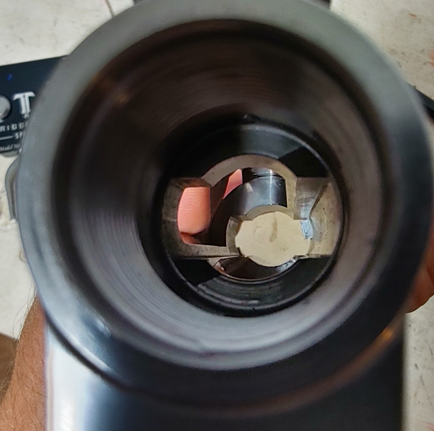

    That helped a ton. Thank you very much. Shitty picture but the right lug is galled up and almost has a burr on it that I can feel if I run my fingernail over it. So I think I found the problem. Now how to fix it? Could I take a Dremel with a polishing wheel or is that too aggressive? Any suggestions?

    Or lapping them?
    I would call defiance and let them look at it. I would not lap the lugs or dremel anything as the tolerances on that action are very tight and you don’t want to mess that up. And screwing with only one lug is definitely a no go. They can do replacement bolts for that action, you might be in that boat. I recommend always using moly grease on the lugs. Not a ton, but use it consistently or you can gaul them
    Sounds good. I'll give them a call tomorrow. Now I'm worried I messed up something in the action where the locking lugs make contact. If I got a new bolt would that matter or no?
    Reactions: Mike at Defiance
    Yep that's got some major galling in the action. That burr on the locking lug is quite visible where it made contact.
