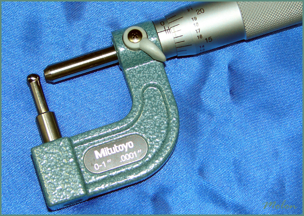

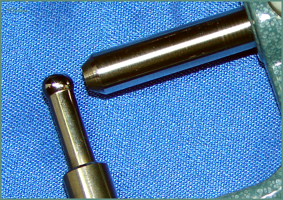

I have a Mitutoyo 115-313, 0 - 1" X .0001" micrometer and I was thinking about grinding the spindle sides at the tip to reduce the surface area to get better measurements next to the shoulder. Have any of you done this? I have to take a look but I think I can do it without taking it apart if I am careful. I would like the tip to be a truncated cone, I would not be removing anything from the measuring surface of the tip. Any thoughts?
The first thing that comes to mind is why? And no I have never done what you are proposing. Typically when your are talking 4 decimals and need greater change tools... if its because of geometry sometimes tips are available
I have a Mitutoyo 115-313, 0 - 1" X .0001" micrometer and I was thinking about grinding the spindle sides at the tip to reduce the surface area . . .
My favorite way of measuring the case neck thickness of 223 Remington cases.
There is a company that alters them to be like that with the bevel to accommodate the shoulder angle to get up close, cant remember the name.
If you do it well I dont see why it wouldnt work.

Agreed, it would likely work well... but for $30 you can get an off-brand of above, and it is reversible if you don't like it. Just a thought. I always hate grinding on my expensive tools, but sometimes there is just no other way.
Ok, I found the exact same micrometer that I own just with the beveled tip for seventy more dollars. It is made by K-M Precision and I believe it is the model in the pictures above. Thank you for all your suggestions and help.
