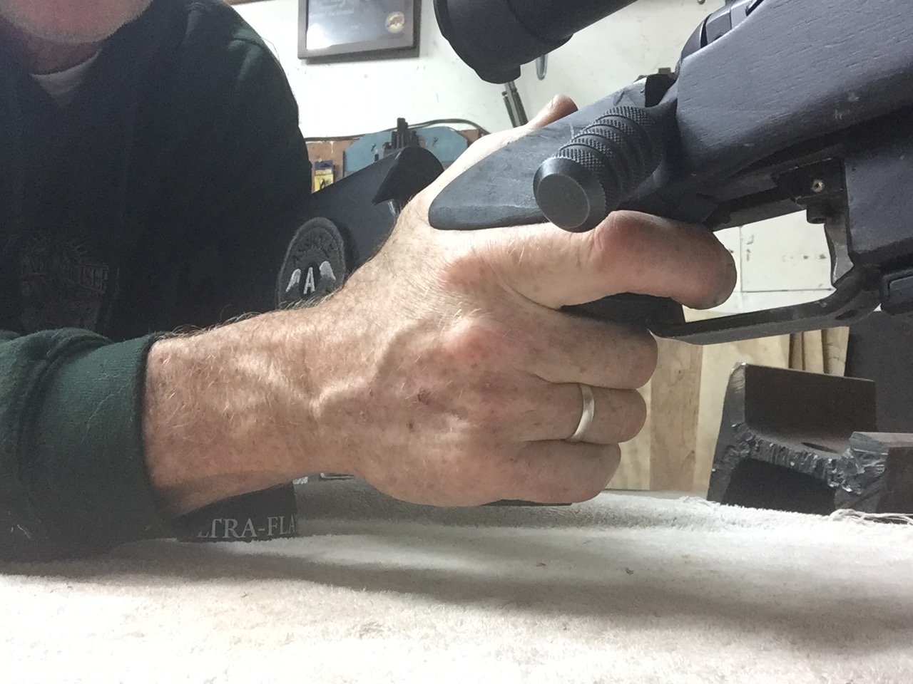

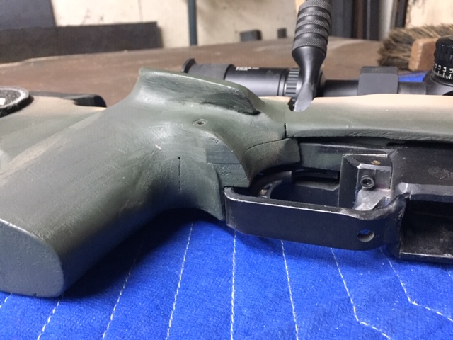

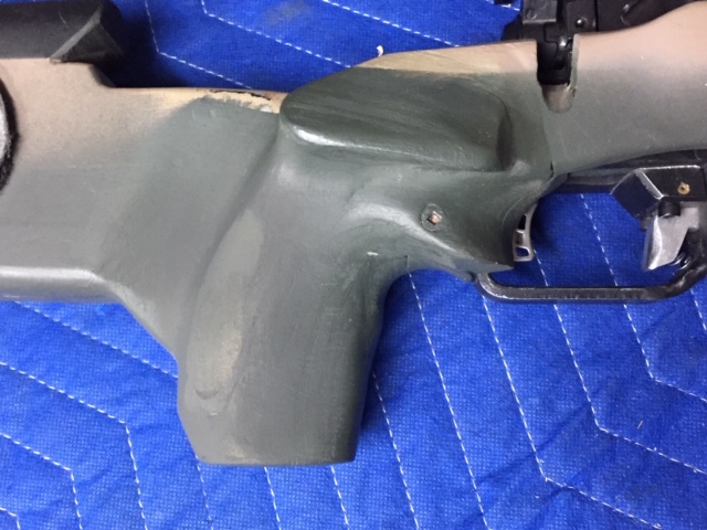

I have made extensive mods to a Boyd's stock fitted to my 110 Tactical. But the mod in the pics is what I have done to the grip. This all started with a thumb shelf and a crazy idea to support my trigger finger all the way to the trigger.... Why? Ever since I was a kid I have a shake, nothing I can do about it but adapt...
Supporting my trigger finger eliminates the shake and allows me to run a very light trigger pull (last time I checked I have the standard Accutrigger down to about 12 oz.) And being able to steady my shake makes this extremely effective. Gun regularly shoots 1/2 moa or better at 200 yards, bigger groups are usually my fault... still learning.
The screw and seam you can see are for removal of a section for access to my bottom metal. That bottom metal is another part of the trailer park, yes it is 3/16 and 1/4 in mild steel arc welder together.... subject for another thread....
She is not pretty but definitely fits like a glove....
