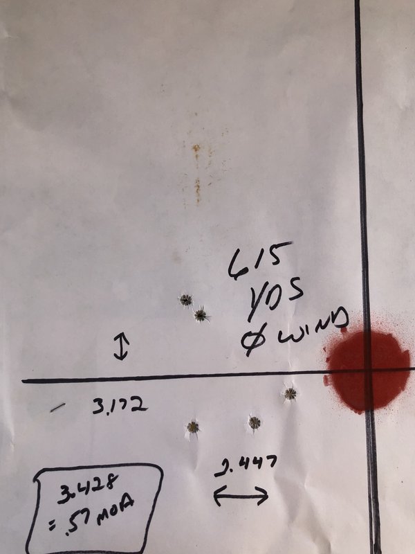

For those of you that know, which certainly is not me. Vertical spread shows the velocity of my reloads is constant? Two distinct groups means cheek position changed? I have no idea what order they were.

If your parallax is set right, cheek position should not cause horizontal dispersion. At 615 yards, that looks like a decent group to me. You are well into the distance where down range wind could be causing that much variation.
I assume you have a 5rnd group and a 2 rnd group??
If this was all shot in the same string, then you missed a wind call.
If this is two different strings then no way to tell the issue because the numbers of shots are so few.
Shoot 2x 10 rnds groups at distance to get real data
Assuming that is all one string of fire, depending on the caliber that horizontal spread can easily mean a missed wind shift.
A 155 grain .308 match bullet (mid .45 BC) @ 2950 - 3000 fps and a 175 gr .308 match bullet (mid .5's BC) @ 2600 fps will drift 0.8 mils in a 5 mph x-wind @ 600 yards. That's .8 mils x 3.6"/100 yd/mil x 600 yd = 17.28". Reversing the math, a 4.5" drift at 600 yds for that same .308 bullets will take only 1.3 mph of wind
Your target says no wind but at 600 yards there is always wind, guaranteed.
First, that's a pretty nice group. If it's all one load, I'd say you are getting the velocities right down to the nubs, if not great harmonics as well.
So, what are you shooting? Speeds, SD's ED's if you've got them etc.?
Agree with those above, at that range, a small wind call miss seems big. And, as noted, parallax can get really tricky to nail right on at distances. It takes several checks to get it as close as you can. One thing I do to help mitigate that is practice lining up on the scope correctly (or the same at least) every time. Just in case my parallax is out just a tiny little bit. Get a sight pic and walk your head in until the sight picture meets the edges perfect every time. I practice that often. Just trying to shave tidbits off my mistakes.
