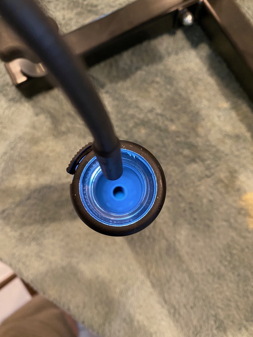

I’d definitely start inspecting everything in regards to the suppressor and muzzle device to start. If that was loose it would throw rounds. But launching a shield off a suppressor is pretty hard to do unless of course you didn’t pay attention and it slid off the end. Look for baffle or end cap strikes

Baffles are fine. The cover just slipped off the front. I think it was backwards so the paracord wasn't grabbing the muzzle break and it just flew off due to recoil. It was only loose enough to rotate back and forth one tooth on the AAC brake. I'll keep investigating as I clean it.
