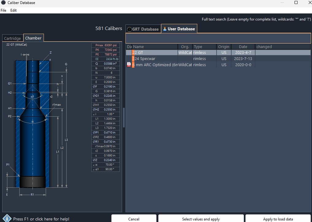

Once it's saved, when you go to change calibers there will be 2 tabs. 1. Is GRT data base i.e. preloaded calibers. 2 nd will be labeled user data base.

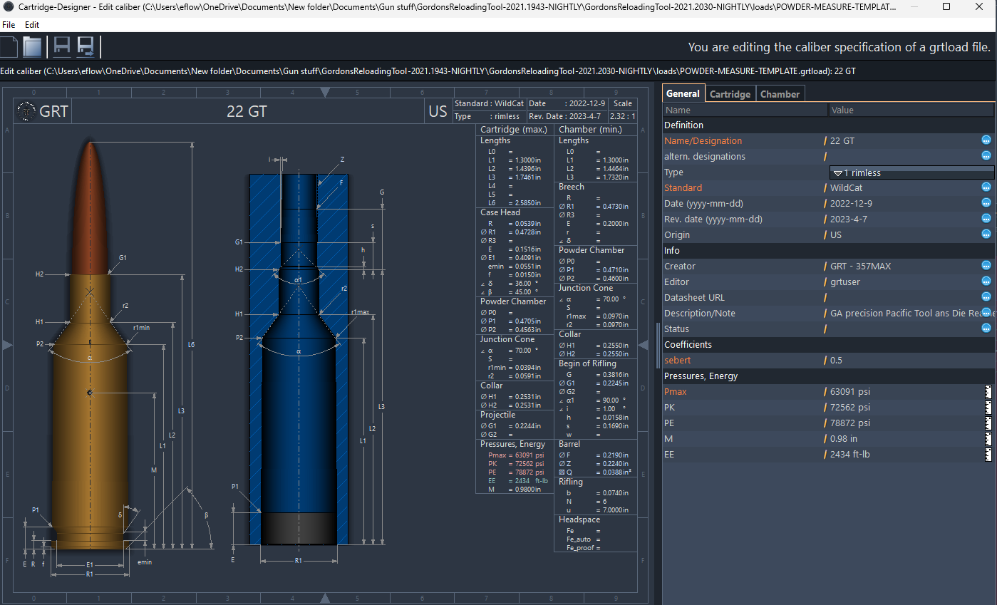

Below is a very similar example to what your after. I made a 22 GT starting with a 6 GT.
Screen shot shows the 2 tabs.
The cartridge designer tab edit screen.

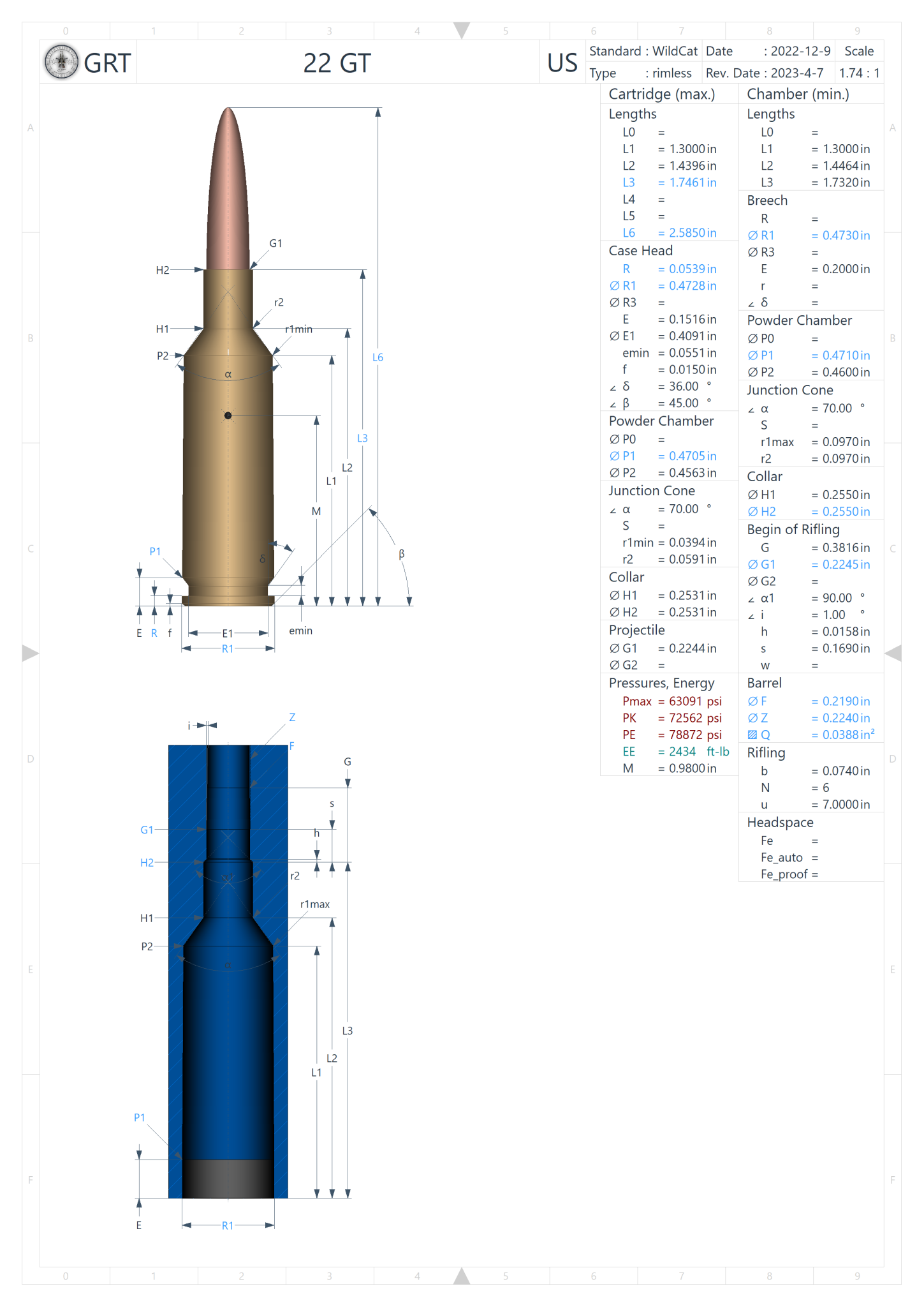

Export of new cartridge drawing.
