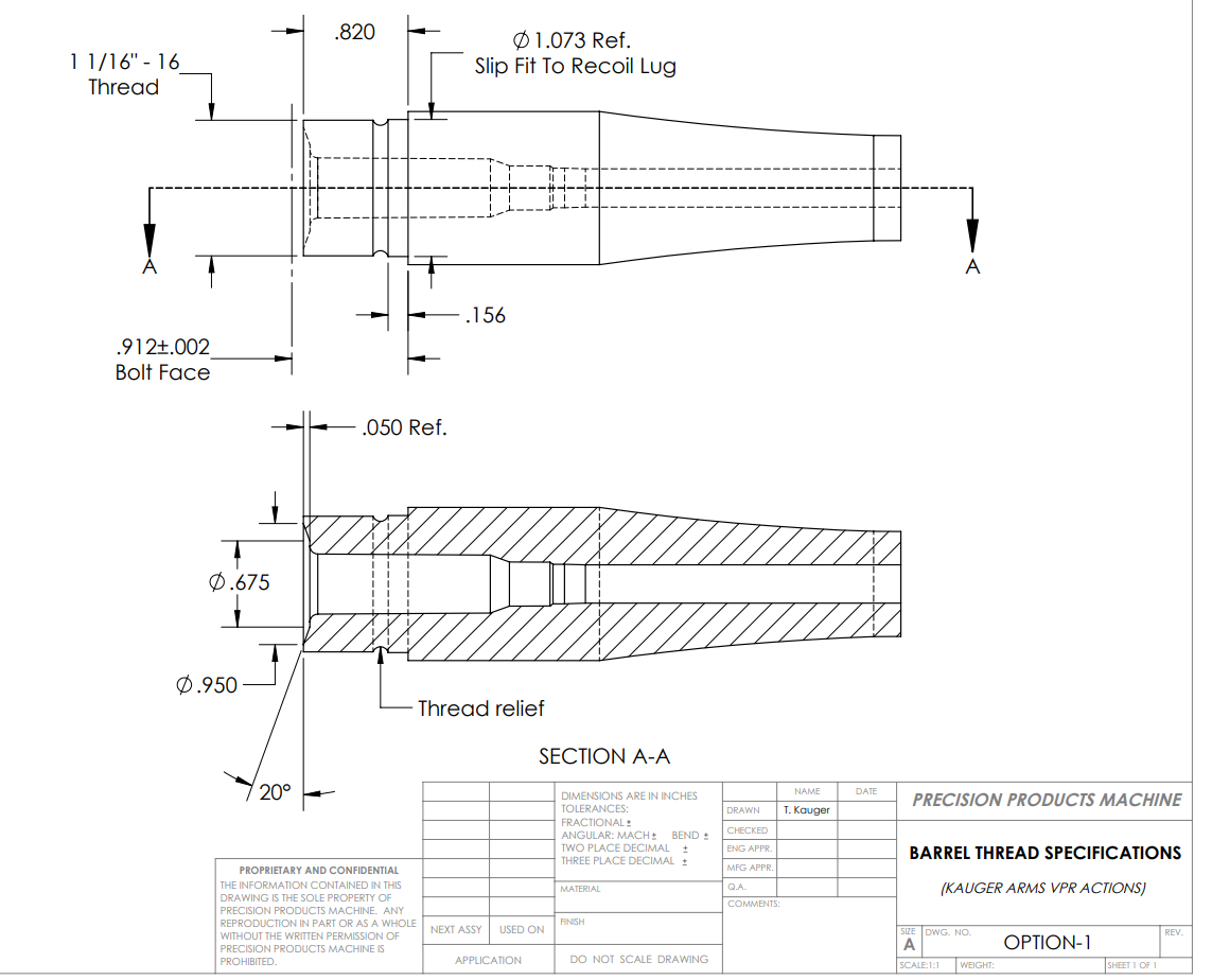

    My regular GS (plural) said they cant do me a barrel for a Kauger action. Anyone had one done ?
    I'm instinctively leery of any craftsman using "my machine isn't programmed for it" as a reason something can't be done. Can't be done quickly or cheaply? Sure. Not work they want to take on with their backlog? Fine. A flat "no" because they can't run it on a machine? Doesn't sit right with me.
    I've had good luck with Southern Precision Rifles. I sent them a take off barrel from a rifle, so they could measure just to be sure (versus going off published spec). After measuring (probably twice) and cutting (just once), I had a barrel that performed exactly as intended for a reasonable cost and a quick-ish turn.
    Reactions: powdahound76
    Kauger is in Georgia and is popular around Georgia in PRS. Multiple local gunsmiths in Georgia have barreled Kauger actions for PRS and hunting. Hammer Rifles for one. I am sure Kauger can provide a list of gunsmiths who build off their actions.
    Larry Archer of Archer Custom Rifles.
    He does a lot of work with the Kauger actions and will spin up a prefit for you. He was recommended to me by Tim Kauger...

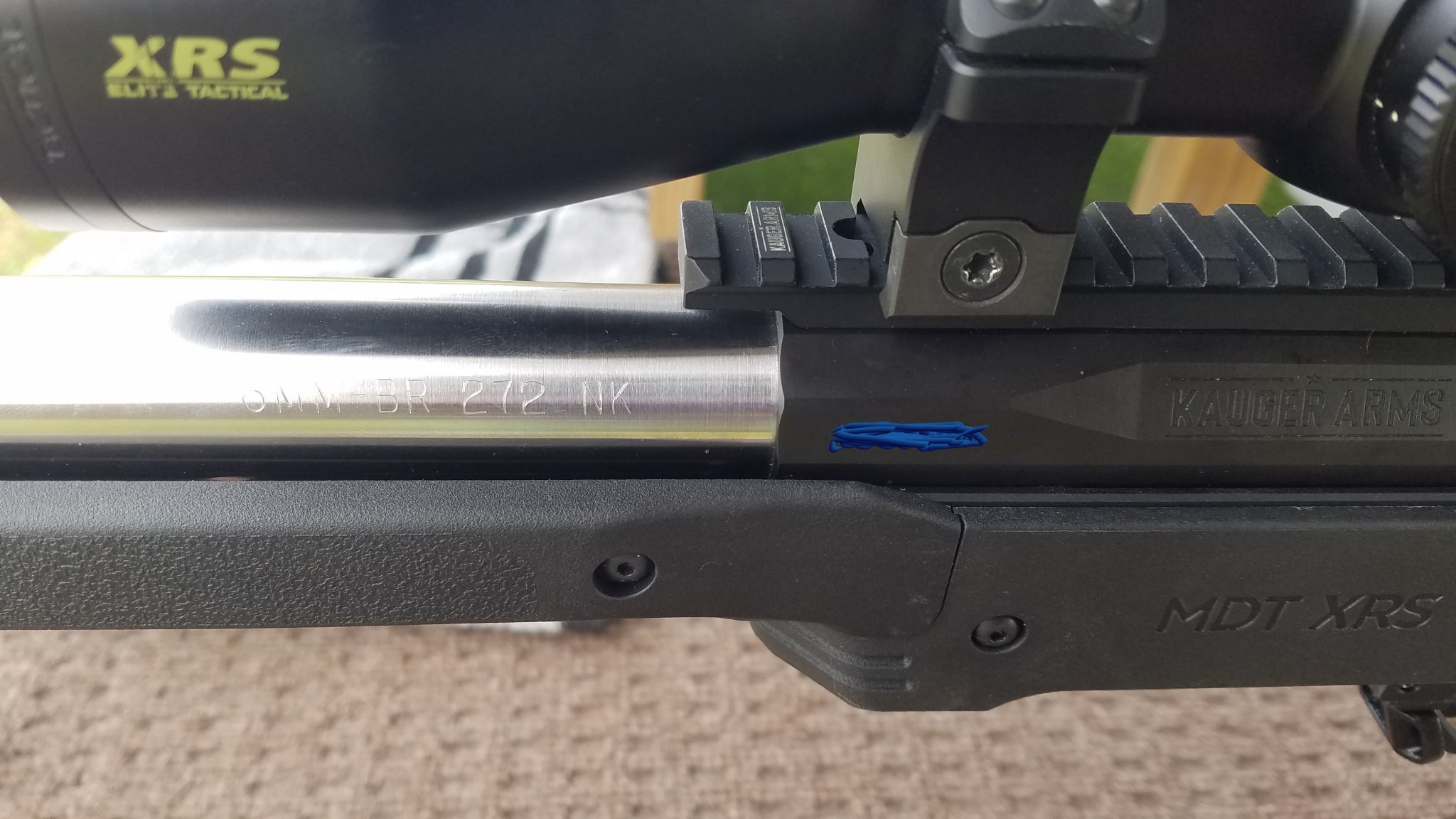

    And yes, he's done work for me with total satisfaction. It was a Proof comp contour that I had him remove most of the heavy tenon section and finish at 22".
    He threaded and chambered the barrel without the action in hand. Note that the barrel markings line up...
    Next barrel will be a 30 BR.
