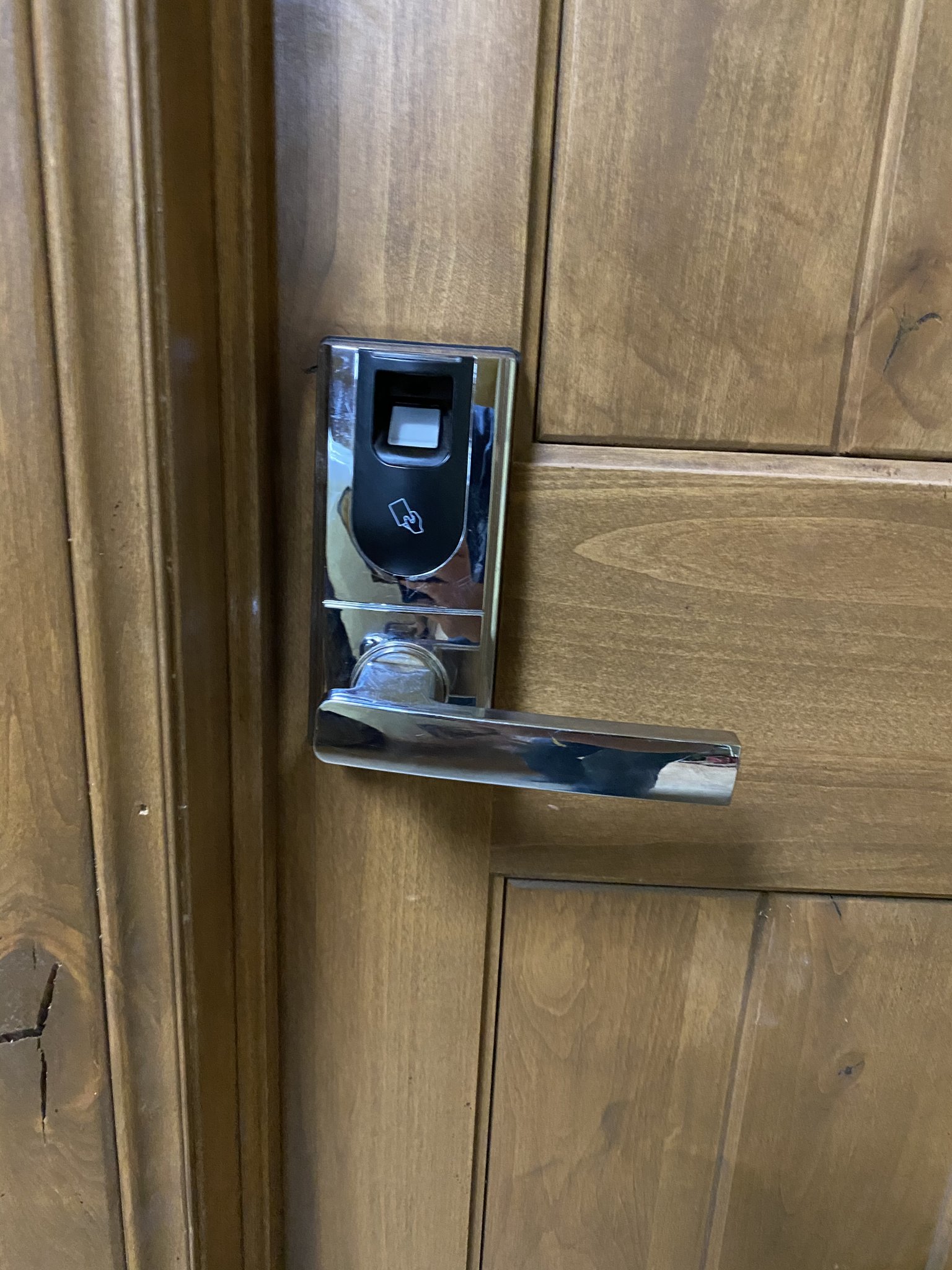

    I have a solid wood door and this commercial fingerprint reading handle. It keeps the kids and ol lady out and will keep the honest, honest. There is a safe inside for the big ticket items. May be something to look into to add to more security.

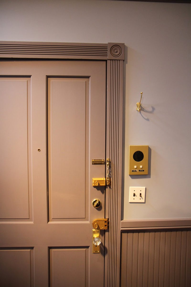

    Also don't forget, as I'm pretty sure I saw it mentioned above as well, but ditch all of the chintzy little 1" long screws that come with door hardware sets and get 3-4" long wood screws that reach plumb through to the framing as opposed to just the door jamb.
    I've used these before:
    Any big box retail home improvement store should have them or an equivalent. It's just a structural rated wood screw.

    I have zero faith in essentially all electronic locks, and keys are too easy to get stolen, copied, lost, etc. I like the Simplex locks a lot. Pushbutton, so quick access, but all mechanical. Simplex 900 looks more or less like a normal deadbolt at a glance, and they are common enough in many parts of the world, it won't necessarily scream "high security" like some other lock arrangements might.
    Do NOT buy a used or NOS one. A few of them had a (well known now to thieves) flaw for decades, so be sure to get a new made one (in sealed box, etc) to be sure you aren't getting a bad one unloaded on you.
    Reactions: earthquake
