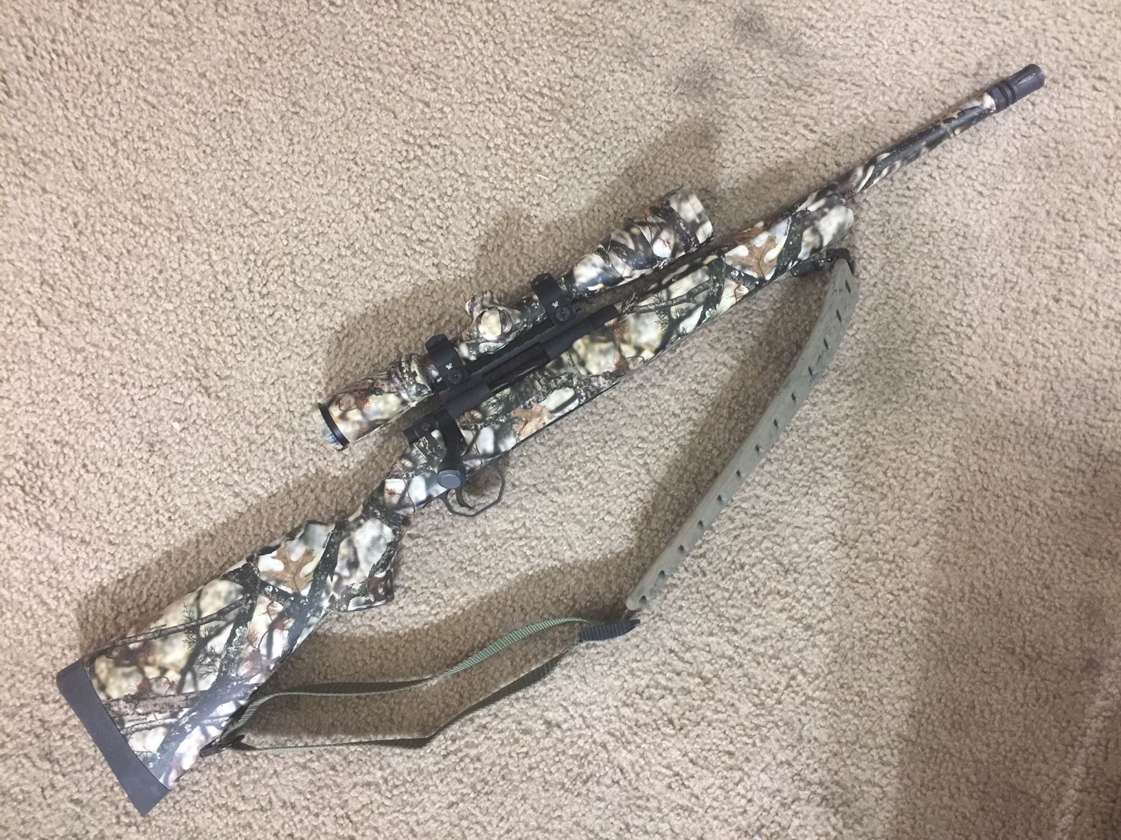

The attached photo is of the Mossberg MVP after I got the gunskins on it. From a distance it looks nice but once you get close, you can see the imperfections in the application. However, I think it will do for close range coyotes.

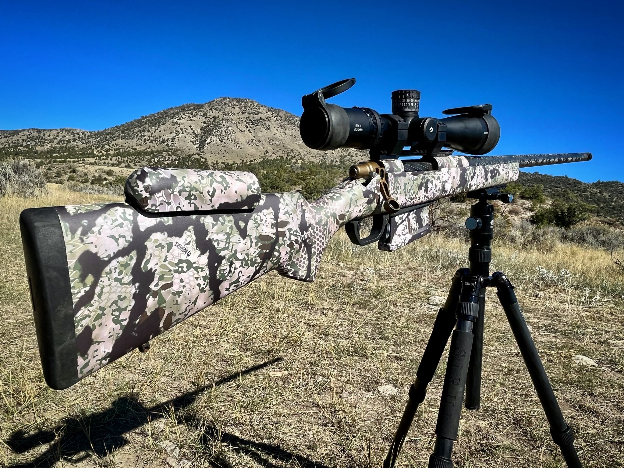

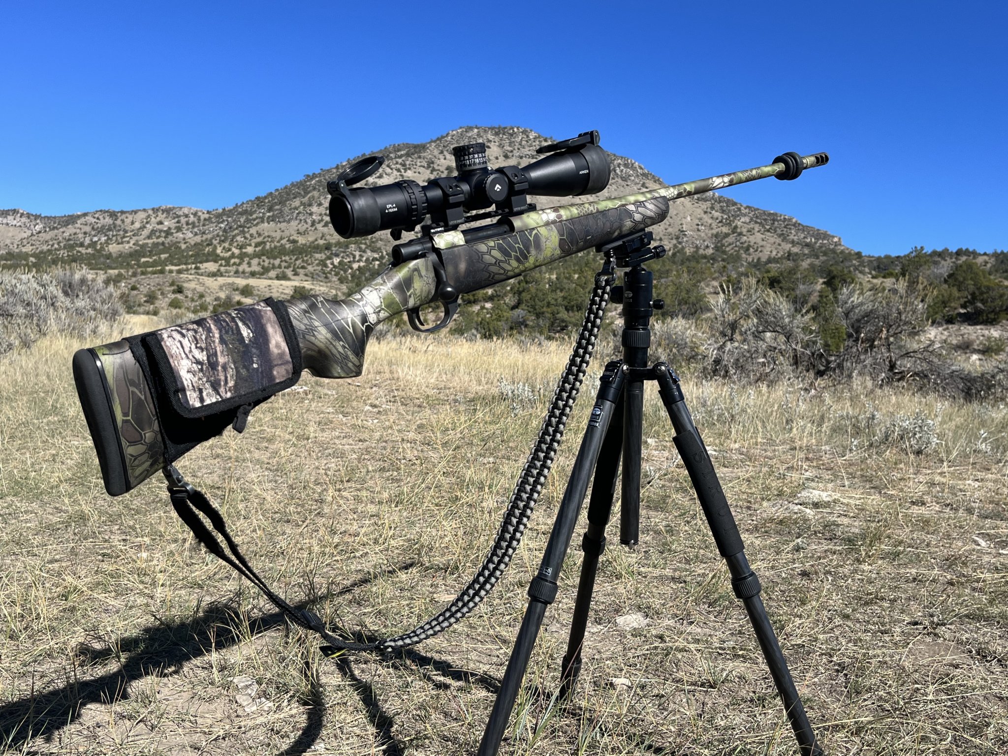

They work great! Very happy with them. They’re not nearly as difficult to install as the previous commenter made it sound. They do take some time and patience and with practice you can get very good results. The forend was the hardest part and I found doing it in separate pieces (2) worked best to get a wrinkle free application. They seem way more durable than hydrodipped products and much better than cerakote C on stocks. It’s not perfect and you have to have reasonable expectations.
