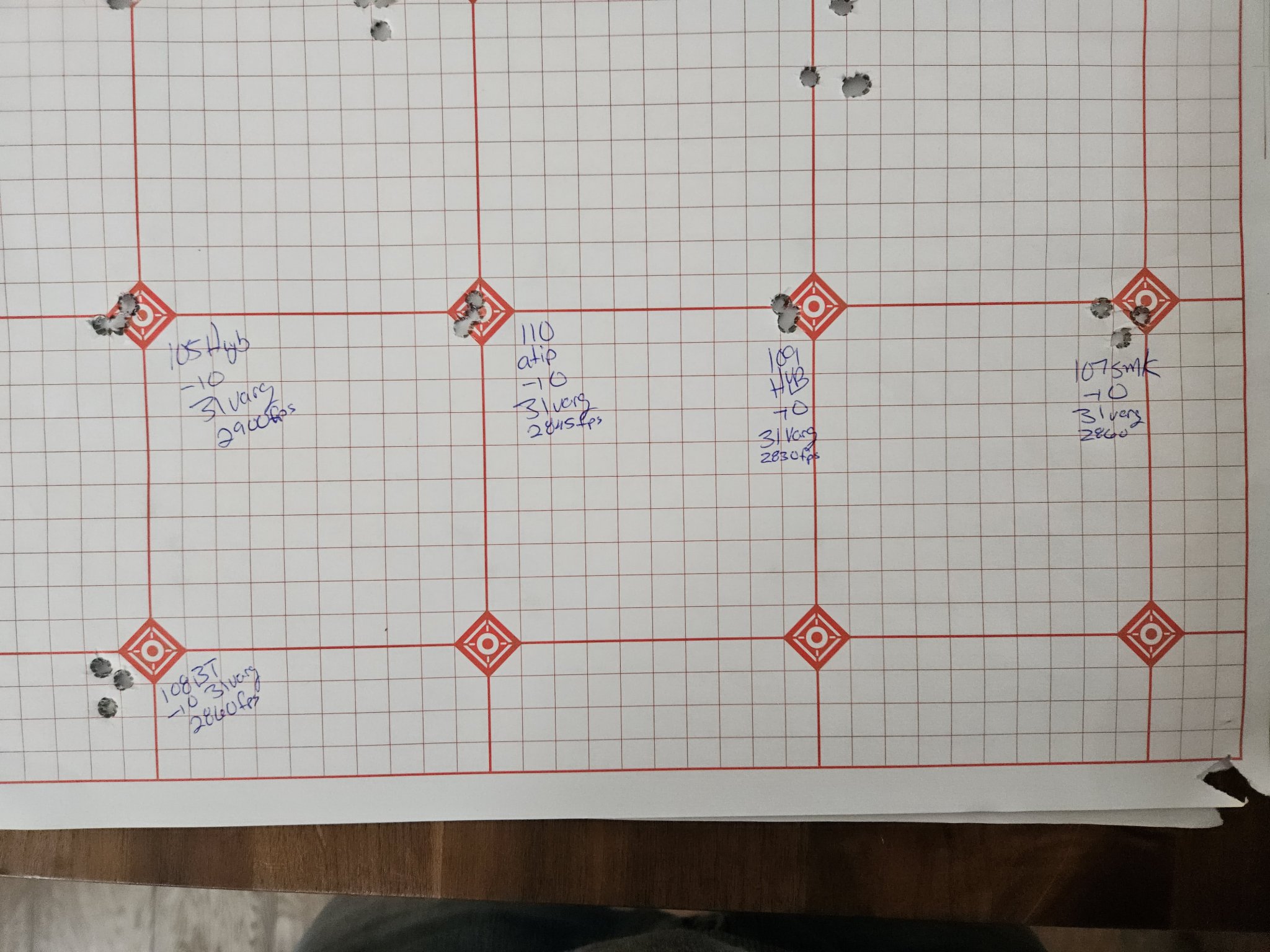

This a new hawkhill 6bra barrel that cost 350$ to chamber. Loaded 31gr varget in brass from last barrel, seated 5 different bullets at the same exact jump, every group at 0.4moa best in the 0.1moa range. Zero load development. Granted it's a br variant. These are the results I see every time I get a barrel from this guy, because it's repeated itself regularly.

Show target groups of a 7stw or equivalent recoil gun, in a hunting chassis, of a $4K rifle, where the smith guaranteed sub half MOA groups when the chamber wasn't cut for a specific load. All those variables have to be met in order to be a valid example.
Groups from a 6BR, or any non- precision hunting rifle, are irrelevant.
