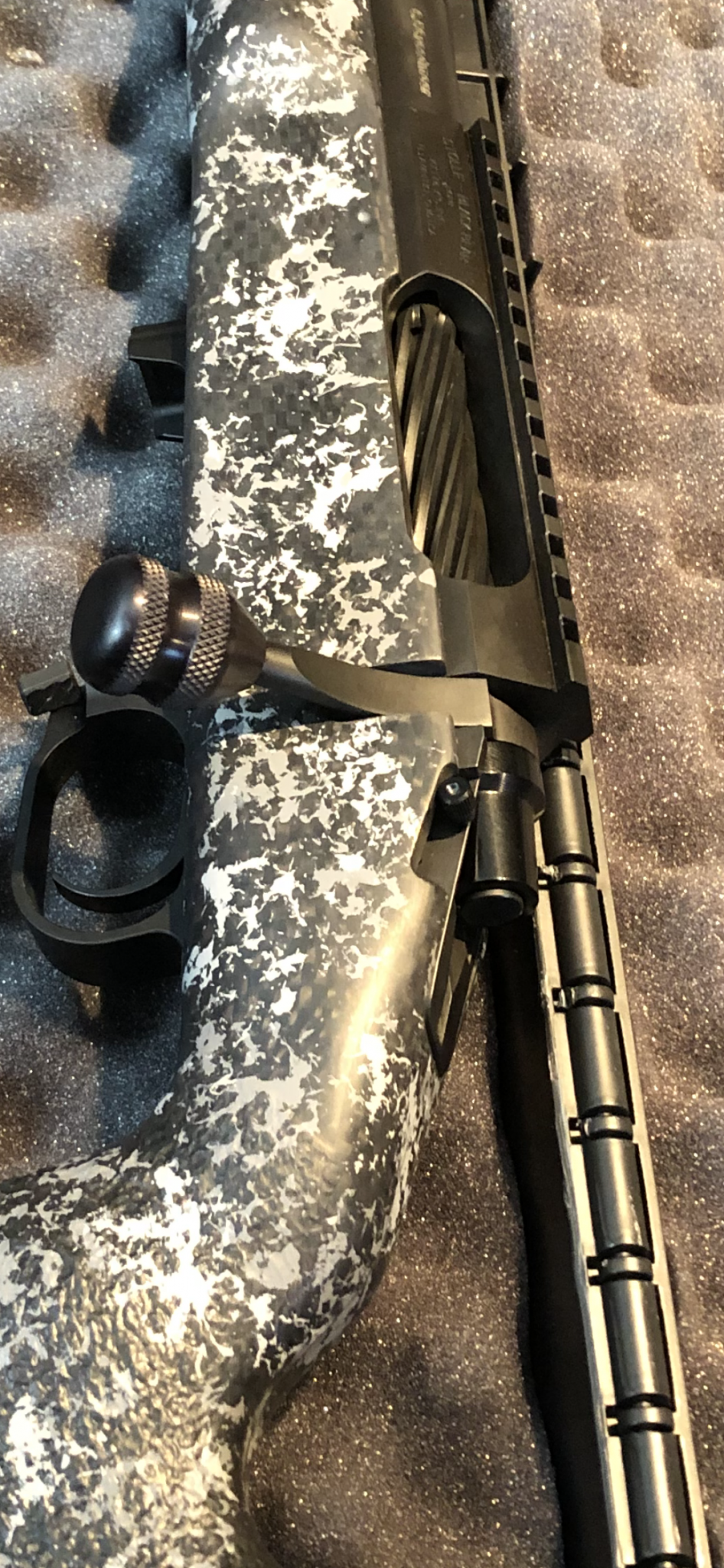

Give Travis Stevens (TS Customs) a call. He has been doing my work for the past few years and it has all been top tier. Here is my Black Bear he did.
