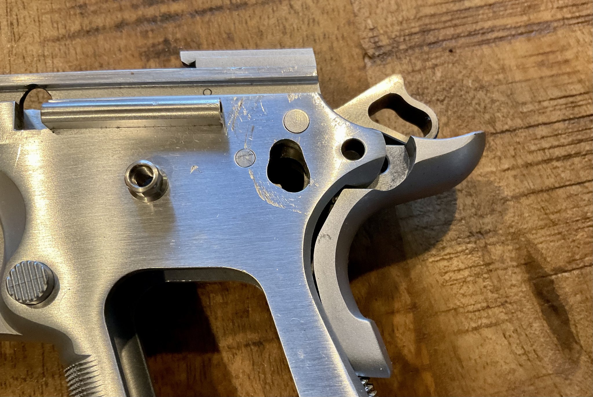

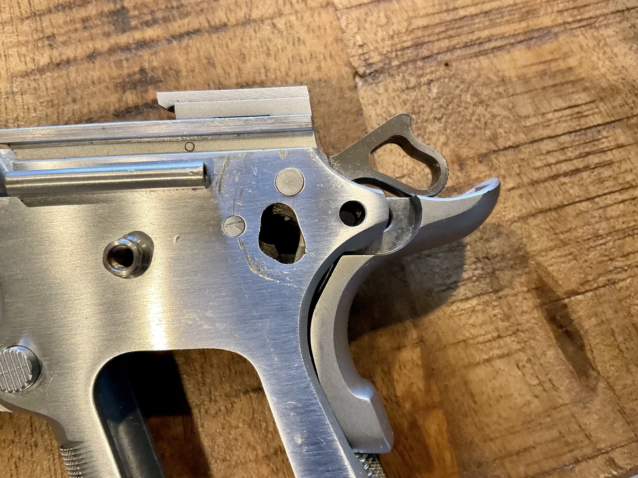

Have a Les Baer in hard chrome, last 10 years been my pride and joy. Right wrist has some issues so wanted an ambi safety installed. Ordered from Baer, had them hard chrome it so everything matches. Dropped off at shop last week. Says $75-100 depending on work. Yesterday pick it up, can’t get it to engage and disengage without major effort. Says it need break in!! Told him no, too damned tight, says leave it. An hour later says come get it, seems a little better, ok. Get home and start manipulating safety, its good a few times, them just not. Look at frame and notice scratches appearing, below bottom of the left side safety. Stop, break it down to find this damned mess! Like someone took a Dremel to frame, also in front of plunger for safety, again all galled up, what tools did they use?
Was going to try and polish out with red rouge, friend says don’t touch it, bring it back, frame needs to be refinished. I know there’s gonna be a fight. He’ll try to blame me, not looking forward to it, but not gonna let him walk away either.
How to handle, because right now I’m livid. Thanks for letting me rant
This is a perfect example of why you don’t take shit to a local gunsmith unless you just happen to live near a world class one. Anybody who can legally possess a firearm can get an FFL and call themselves a gunsmith, doesn’t mean they have a fucking clue what they’re doing. They think deciding to fill out the paperwork and write the ATF a check for a small fee qualifies them as experts, just like all the idiots at a gun counter think they’re experts.
Wow, I'm no smith and have installed several 1911 safeties of the years and never caused any damage! I suspect you person you took it too isn't a smith either,,,,,,😮
Sear pin is too short, both sear and hammer pins should stand proud of frame, the thumb safety should sit on the pins and not contact the frame when engaged and disengaged
