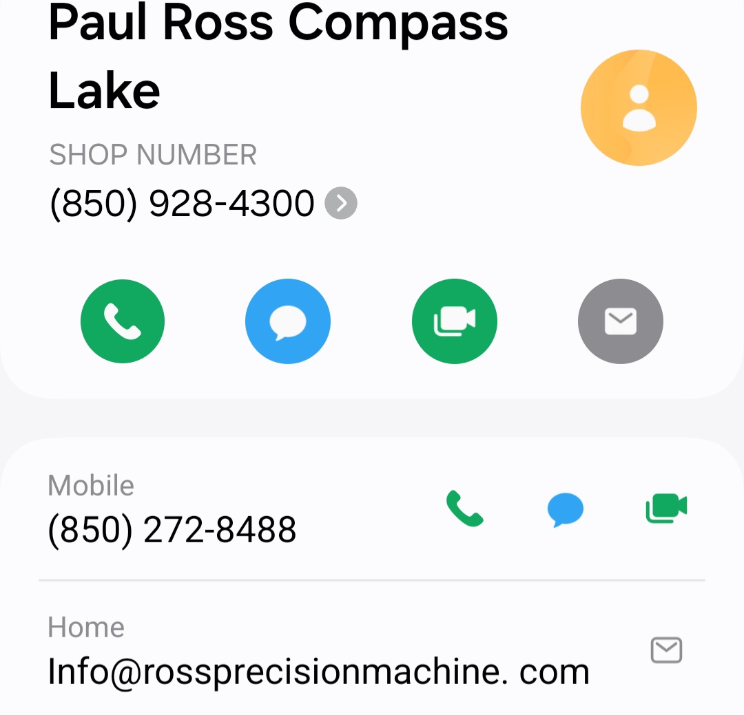

Give Paul Ross a call or text, just tell him I sent you and he'll do you a solid deal.
If you're not familiar with Paul Ross he was the Head Barrel Smith at Compass Lake, he worked there for over 20 years.
If you've ever read any of my Reviews or Range Reports, Paul has made just about every Custom Barrel that I've shown on the Hide.
Paul Ross and Paul Craddock are the only two people I allow to turn my barrels.

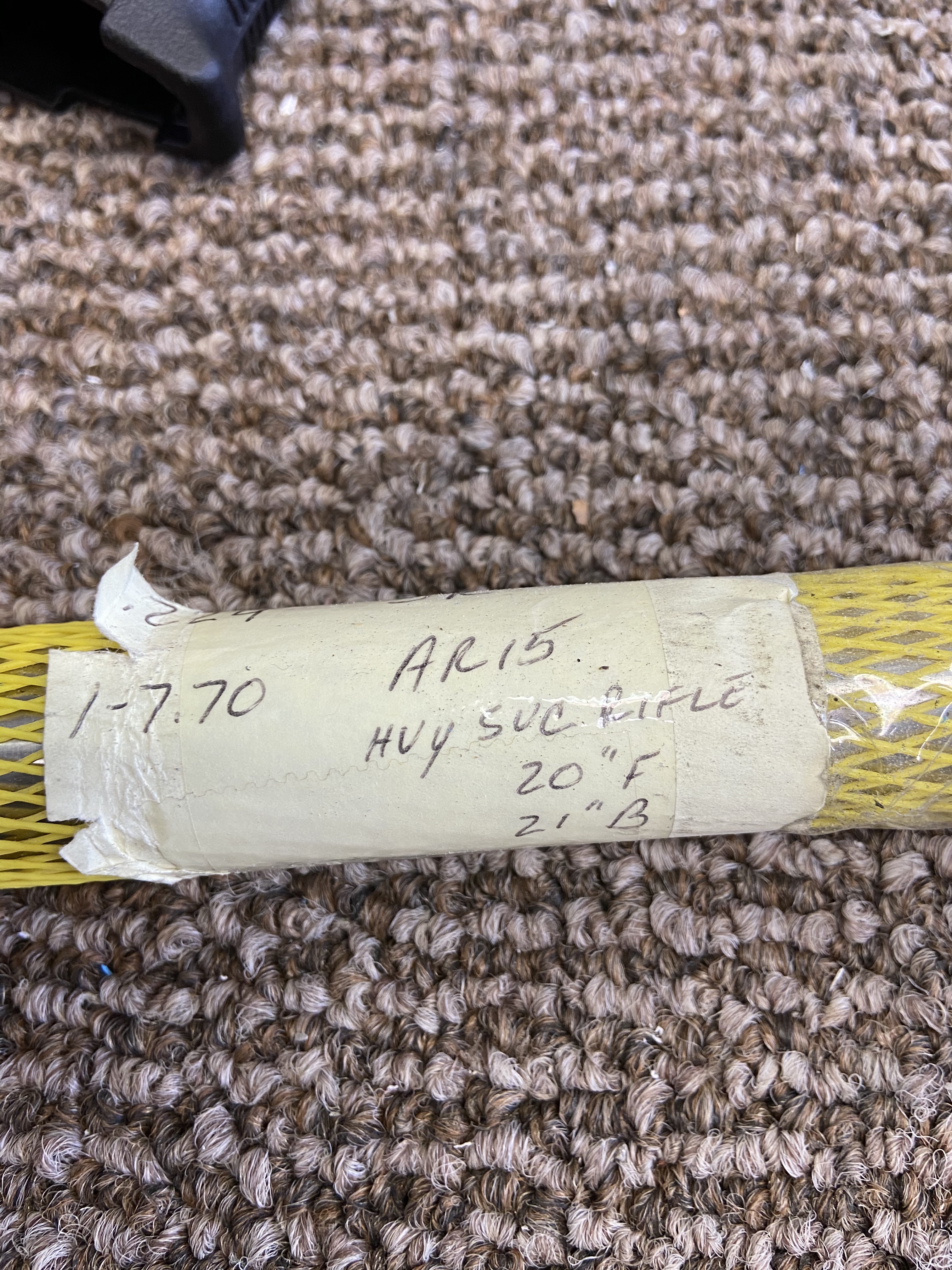

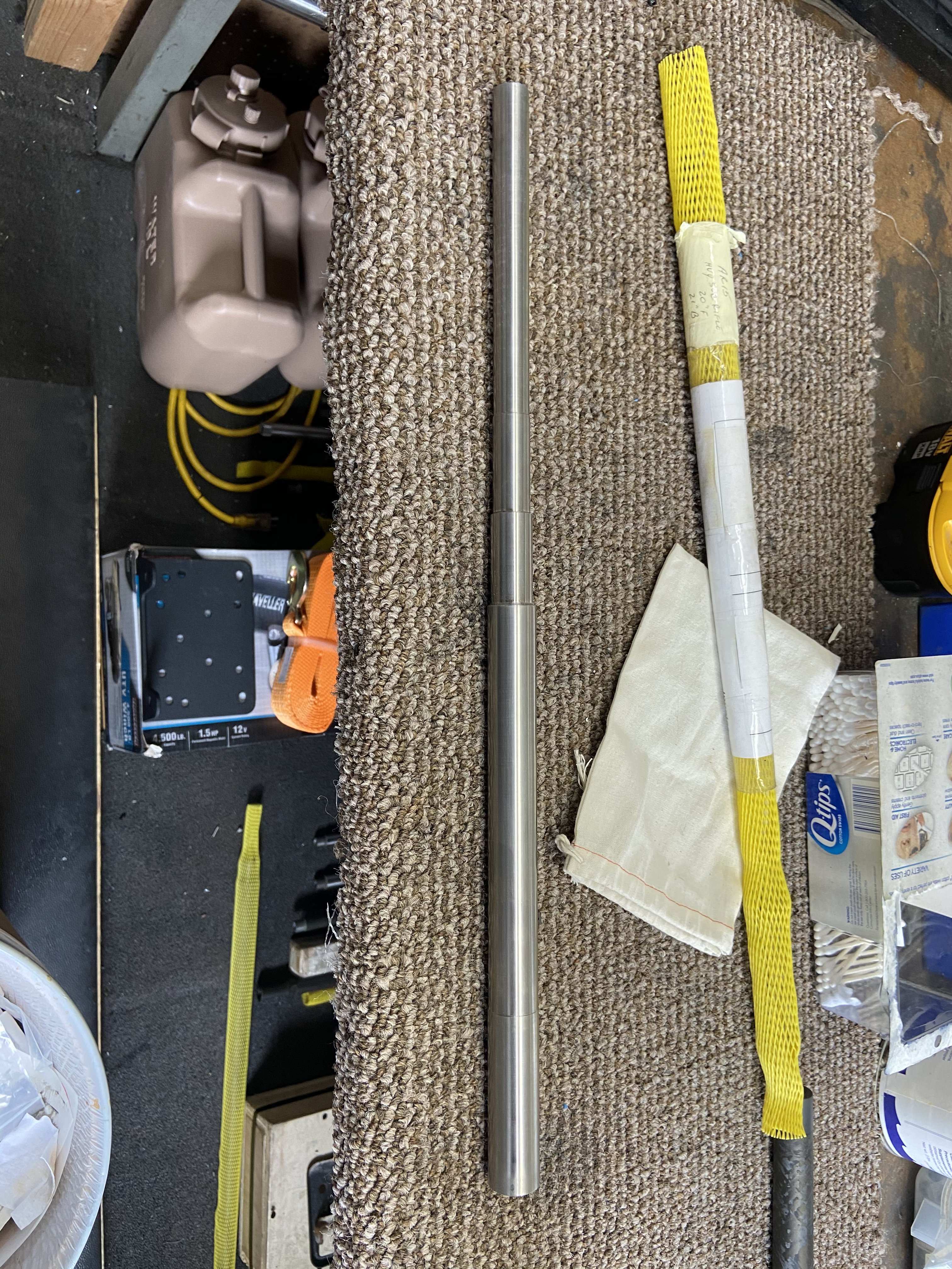

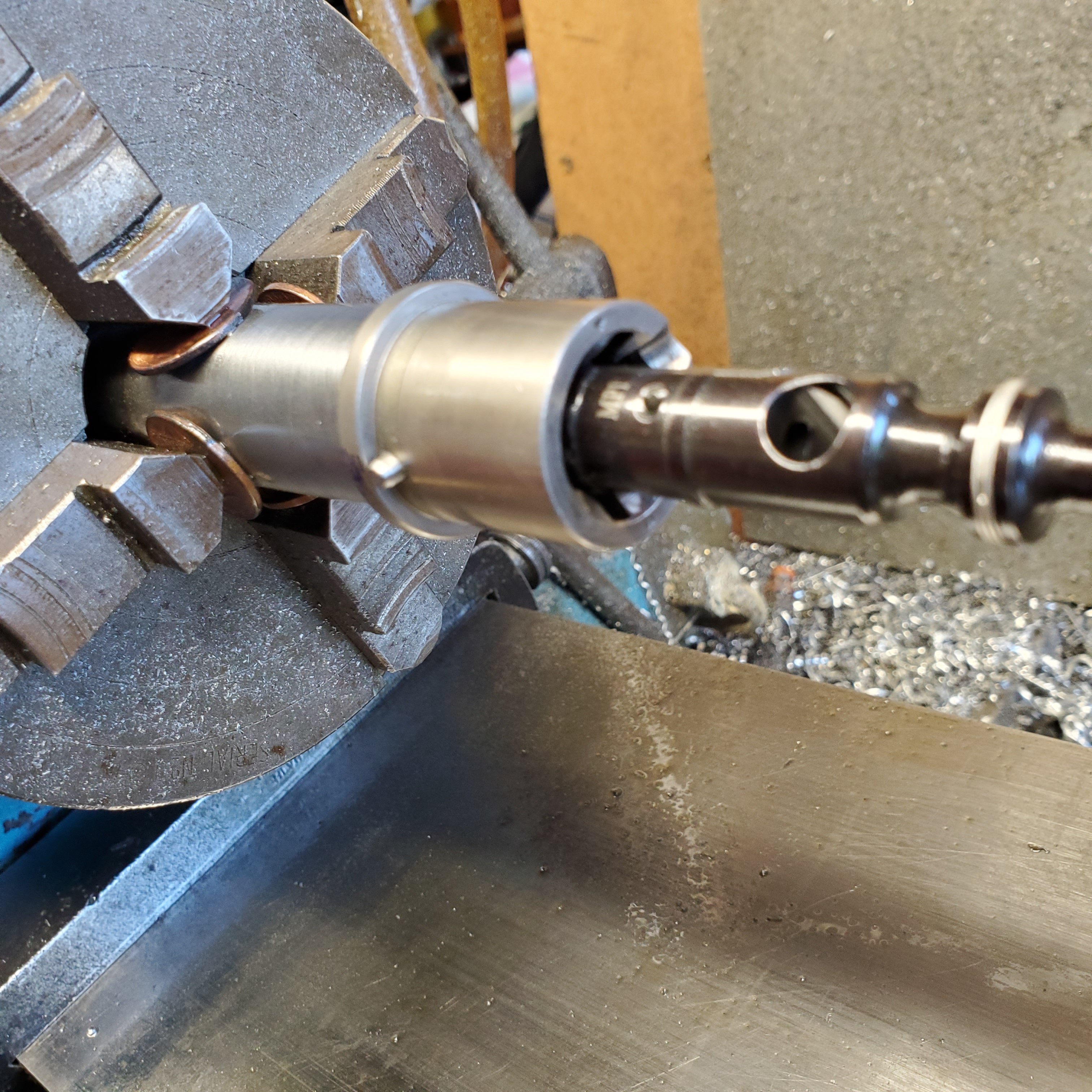

AR barrels are made from a blank. It just requires more machining.
With today's CNCs with many profiles already in the machines memory or its a fairly easy job.
Going the old fashioned way in a manual lathe it takes more time... but isn't all that difficult if you are familiar with the process, and have machine tools... you can do it yourself.
