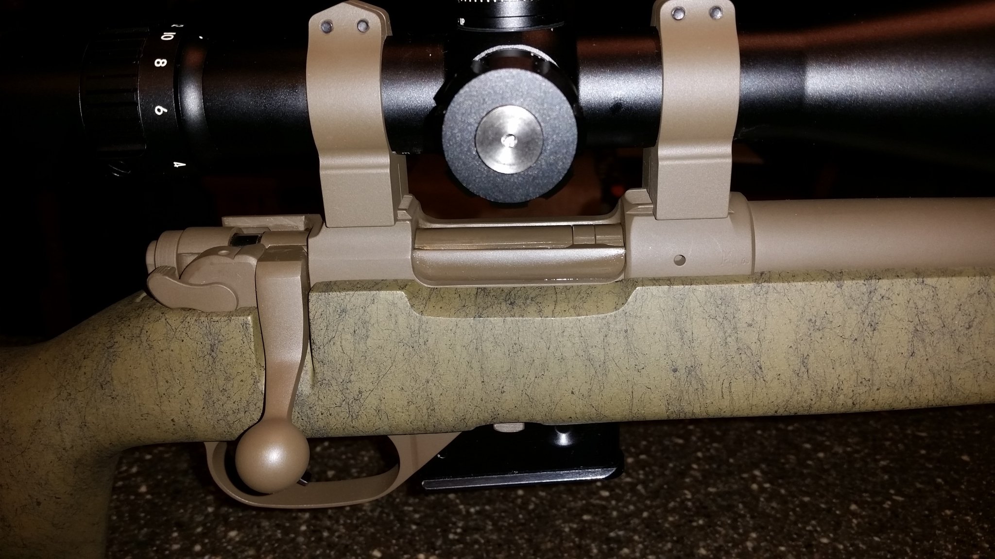

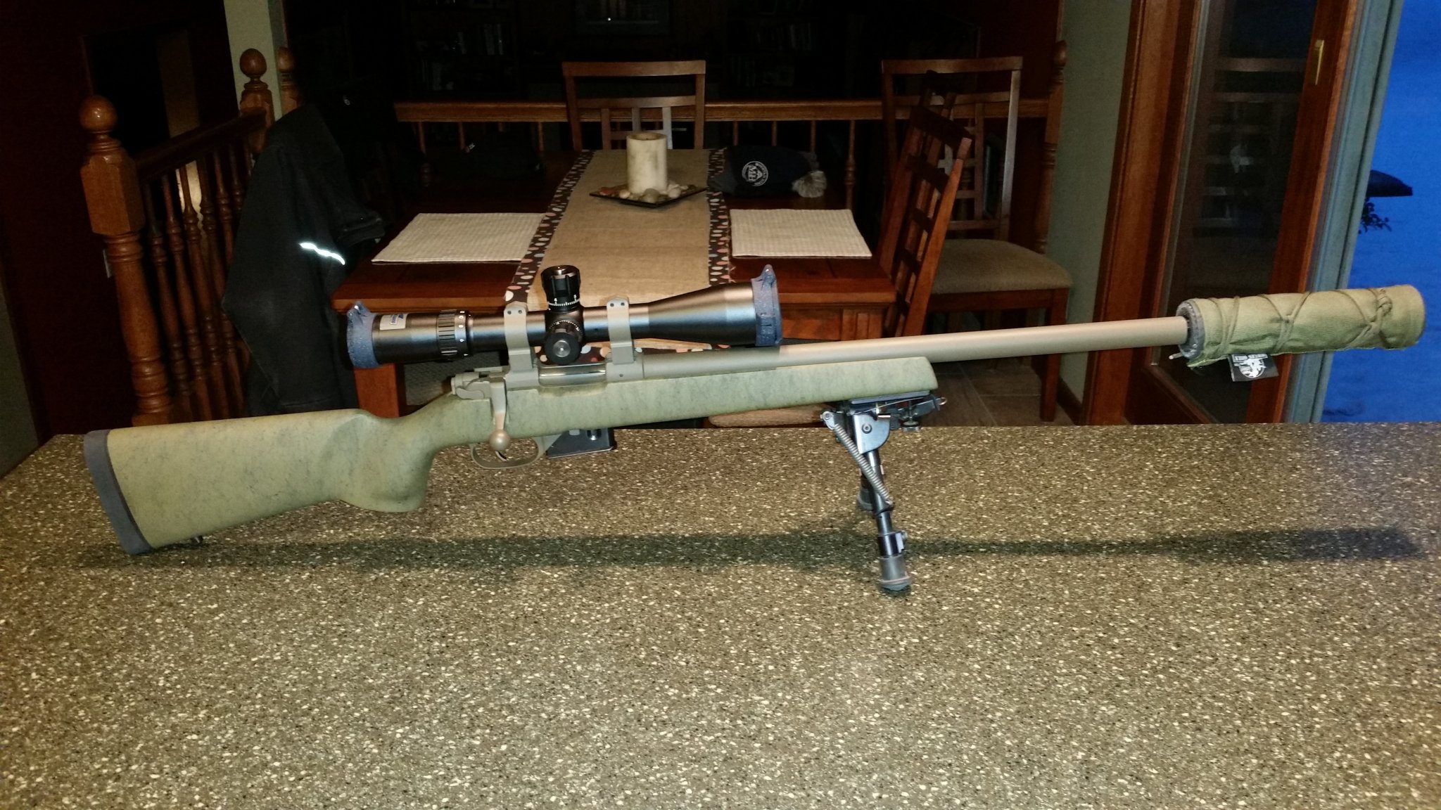

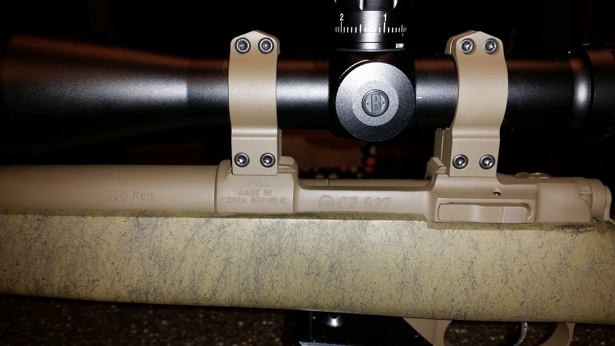

I have CZ 527 (223) in an HS precision stock with an aluminum bedding block. The rifle has always had trouble feeding from the factory CZ 5 round magazines, especially the last round. Can the existing aluminum bedding block be re-milled to either lower the action or raise the bottom metal to accommodate better feeding?

I would recommend first trying a different magazine. If that doesn't work, then look at how the magazine goes/fits into the bottom metal as pointed out above.
Spitballing here:
Is the ceracoating original?
If not, did you have this issue prior to coating?
Maybe the coating raised the receiver in the block by a couple thousands and lowered the bottom metal the same, causing just enough gap to create the issue.
