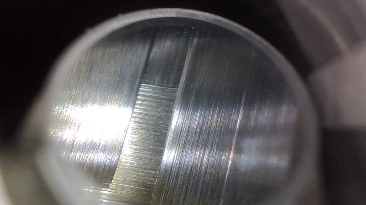

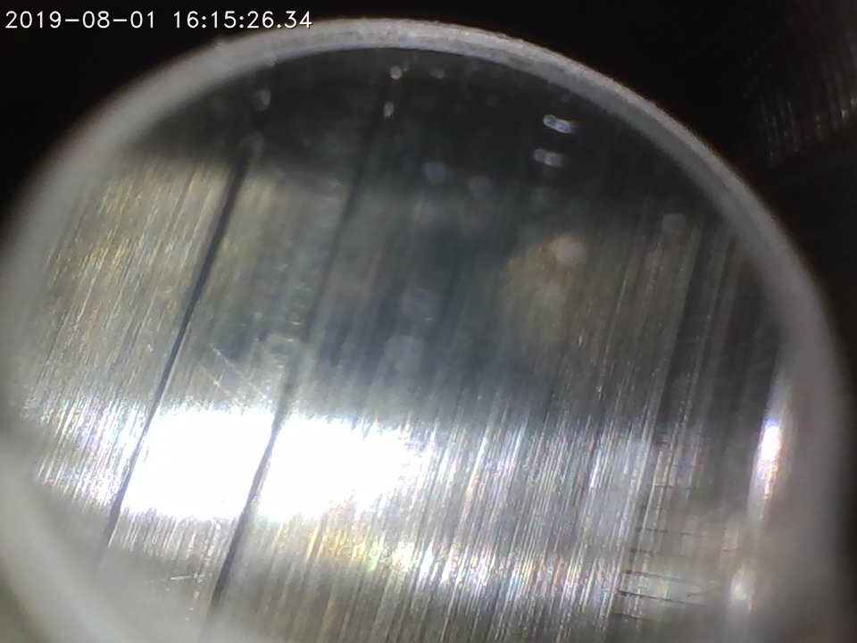

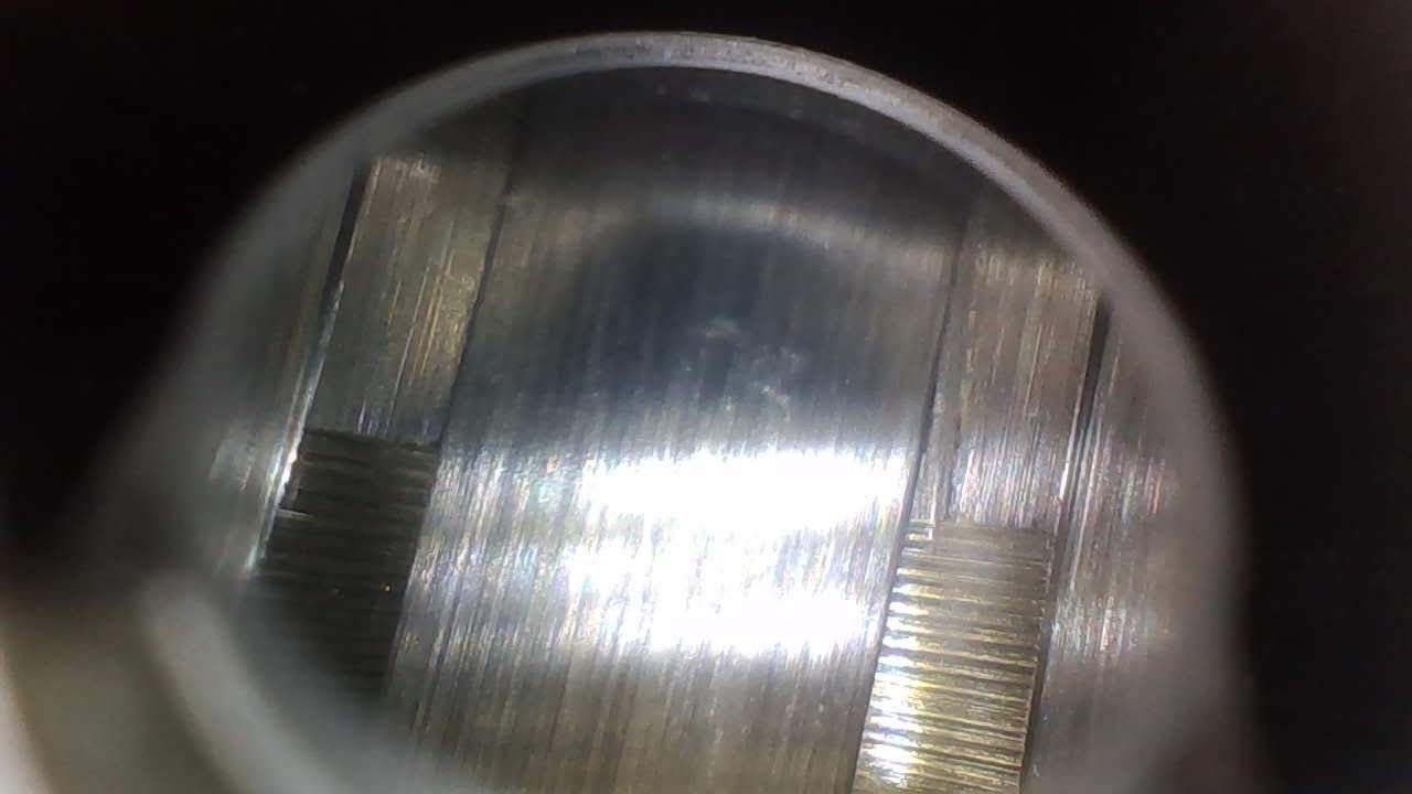

So just got my Amazon sepecial Teslong borescope from the hide guys who helped get it made... Anyway to test it out I grabbed my brand new proof steel prefit for my axmc and whoa tool marks! Is this normal for the lead in? How about the tool marks in the rifling mid barrel?
Anyway borescope seems to work great with my Android and PC.

That sir, appears to be a barrel that needs installed and some rounds through it to see how it will shoot.
Also, some tool marks as you already noted.
I dont know crap. So I depend on people who do, to educate me, hence why I read a lot on here.
More experienced guys than either of us (Cross, Tooley, Dixon) often post to stop looking and go shoot.
Unless a barrel isnt shooting. Then look.
Go run a 100 through it this weekend and post a target.
I would suggest a relaxing beer after and believe you’re of a faith that doesnt do that.
So a nice lemonade.....

I have no doubt it can shoot but we will find out tonight for sure...I have 2 other proof steel prefits that hammer.

I had some real ugliness about 4 inches from the muzzle on my last Shilen barrel.
That barrel was amazing till it died.
These bore scopes are fun but I try not to put too much weight into what I see, sometimes things are better unseen.
Some of the best gunsmiths will tell you that it really doesn't matter what the inside looks like - see what the bullet does down range and believe the bullet. At the end of the day, that's all that really matters, doesn't it?
Plus there's the argument about potential barrel damage due to running stuff down the bore that you probably shouldn't.
looks like a smidge of chatter but the tank treads are a lot for a custom barrel. I dont typically see that in things like bartleins, kreigers, mullerworks, schneiders but its not to say others dont see them in those brands. I certainly dont do the volume LRI and others do.
Savages shoot very well and their bores look like nothing but a tank drove through the whole thing. Like everyone else says shoot it and see how it does. You just might need a bit more cleaning than some and may need a few extra rounds on a clean barrel before she settles back in.
Yes the target tells all but accuracy is a lot of small things that add up to something.
For myself I take great pride in the finish and concentricity of throat. To the point of having a procedure to polish the throat before it leaves the shop. I've done that to every barrel I've chambered for the last 20+ years. That also means taking a reamer out of service sooner than most. That's what I can control as a smith. The most important cutting surface is the lead angle. I've seen the ugly and then even uglier throats. If anyone would like to buy reamers with probably 10-20 or more chambers left on them PM me. I need beer money.

I'm not a Gunsmith but I wouldn't use that barrel.
While ptg pisses me off those tank tracks at the first part can't be blamed on the reamer. Those marks are in a groove and beyond where the reamer cut. Those were made when the barrel was made.
Nope. The marks in the first pic are on the leade angle which moves up the land. You have a throat, which is just ahead of the case mouth, then an angle that breaks to the top of the land. Angle is the leade, which is cut by the throater or throat section of finish reamer. Whatever I see in the groove looks like it follows the lay of the helix, so not an issue there.
If you are talking about the first photo, those marks wouldn't have been made during the rifling or lapping. Those marks were made by the reamer cutting the leade/throat. Some of the chatter marks in photos 2 and 3 were probably were made during rifling.
To the OP, assuming the chambering was otherwise correct, the barrel could shoot fine - I've seen some factory Savage and Remington barrels that shot well but were horror stories when viewed from a borescope. Given that Proof made the barrel and chambered it, I'd send them your photos and ask how they'd like to handle it. Worse case, they say it's fine, then shoot it and keep an eye on the copper deposits. If it shoots well and the machining marks smooth out through natural throat erosion, then all's well. If it collects copper to excess, you can try a product like Tubbs Final Finish.
