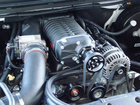

Here ya go.....which will get you a 200+ HP increase on 91-octane fuel with only 7-8 psi of boost!

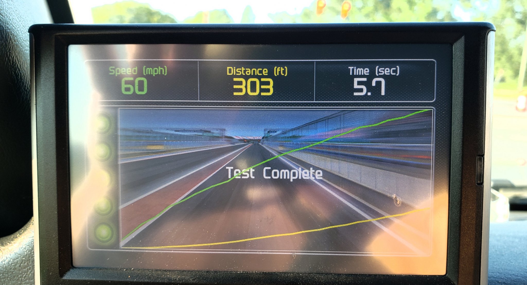

Coming from a 2000 Camaro Z28 with factory 2.73s (not exactly a rocket), my 2018 Silverado 1500 (regular cab short bed 4x4) is an absolute dog. Pathetic under 4000rpm and the only way to get it there is to pin it to the floor and wait. It's going bye bye and soon.

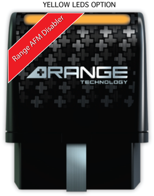

OP, what gearing does your truck have? Your 2008 will likely have AFM, which a Range AFM Disabler can deactivate.
