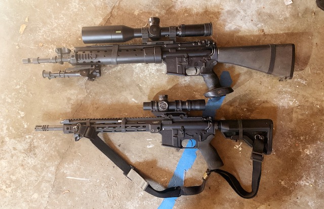

Interesting thread on one of my favorite topics.
I built a Mk12 Mod 0 clone years ago for nostalgic purposes as it was far and away my favorite deployment rifle. That being said, while it may have been amazeballs in 2002-2005, today it naturally feels a bit dated. While not as heavy or bulky as the SR25s, it still wasn't the type of rig you could easily assault with then setup overwatch. Well you could but it wasn't ideal.
So my quarantine project this past summer was to build something comparable with modern components. The goal was to make a rifle that could be employed the same way the Mk12 was designed for but a bit more versatile (ie you could clear a house without feeling like you had two rubber ducks taped together). What I ended up with is:
LMT MLR (rifle length) upper
16" 5.56mm 1:7 barrel
Triggertech Diamond AR trigger (still not sold on this)
SOPMOD collapsing stock
NX8 1-8x
Heathen Systems assaulters bipod
You could say it's a basic AR now, which it is circa 2020, but it doesn't need a lot of add-ons the Mk12 had. There's no need for a SWAN sleeve, OPS Inc brake/collar, 3" OD handguard, etc. The 1-8x is still good to Mk12 distances, but now it also is great up close without the need for secondary irons/RDS. There's still plenty of rail space for NVG-support gear, it's a few pounds lighter and a bit shorter. The collapsing stock is an issue for me because I'm an oddball who just really doesn't like using them with my support hand on the stock/bag (that's why I preferred the old A1 stocks). The Heathen bipod is a very minimalist part-time bipod that really grew on me with this rifle. No, it doesn't let you do much other than have temporary semi-stable support, but I'm finding it works well (besides, I shoot off of a ruck or bag often anyway).
In other words it passes my "would I hump/jump it?" test.
ETA: comparison pic. Also, thinking of trying 6mm ARC in this rig and swapping out the NX8 for a Vortex 1-10x I have on a .308 - slightly better scope I'm finding.
I am in LOVE with the 6 ARC concept as I think the bullet weights in that diameter balance nicely with an AR15 sized gun.
My only question is why SOCOM would field it with the current mags on the market since 6.5 Grendel mags seem to leave a lot to be desired reliability wise unless they have some new mag barret came up with. Which would not surprise me given the reputation barret has.
