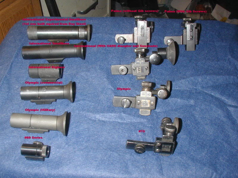

I have several sets of Palmas, good sights for their day. They were added later as the Palma didn't come out till 72 or so. What front sight is on it? They didn't make a Palma front sight They used either the Olympic, International small bore or International Big bore sights.
Do you have inserts for the front sight? Here's a pic of the Redfield sight family:
