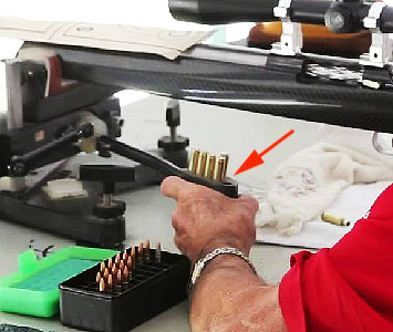

It’s benchrest. Why are you using a mag?Finger dexterity isn't great for working a internal mag.
Because my fingers can have trouble loading an internal mag. External mags I can load much easier.It’s benchrest. Why are you using a mag?
I mean why have a mag at all if you’re wanting to shoot bench rest? Get a sled and make it a single shot where you can just set the next one on top of you’re stuck with a repeater action you already have.Because my fingers can have trouble loading an internal mag. External mags I can load much easier.
