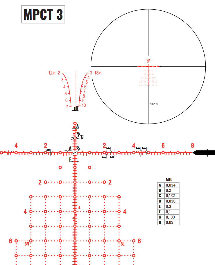

Anyone have first hand experience with these reticles? I understand that they don't have a lot in common but they do both utilize the hollow dots for mils and something about this really makes sense to my brain. I'm not so worried about the scope as were talking about S&B and ZCO, just wondering if anyone has shot both and their opinion on them. Thanks for any info.

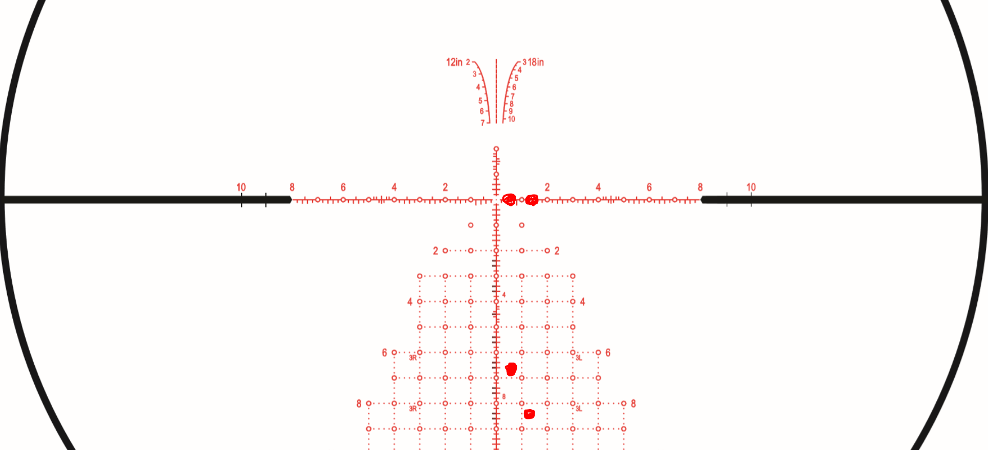

The hollow dots make sense as long as you're holding full MIL values if you're somewhere in between I think they are less practical imho.

I was one of the first to use the H2CMR when it came out and when it did it was a good reticle and I liked it more than the P4F but if you plan to shoot matches then the ZCO would be the winner easily between the choices.
No for what it is it works great but when using the reticle for elevation and wind holds in matches or general use the Christmas tree style reticle will be more accurate and easier for the shooter.

So floating a 1 moa target out in space is more accurate / precise that dialing elevation and having a fixed point to hold on? Hmm.
You have the option to do both in the tree style but sometimes you will be doing both at matches and yes it is accurate with practice and knowing how to hold with the reticle. It will be much more accurate than no reference marks and holding in space with the H2CMR.
I’ve owned them both and really liked both of them. I prefer a center dot so the MPCT 3 gets the edge on that. Simplicity goes to the H2CMR. If you don’t think you need the tree than the H2CMR might be your best bet.

I have 4 of the H2CMR reticles. I have an MPCT1 & MPCT2 also. And have shot an MPCT3 briefly (not mine).
The H2CMR is not only a 1MIL open dot. It is a .9, 1, and 1.1mil subtension. Outer edges are .9 and .1 MIL. So you get .2, .4, .6, .8, .9, 1, 1.1, 1.2, 1.4 etc. subtensions.
