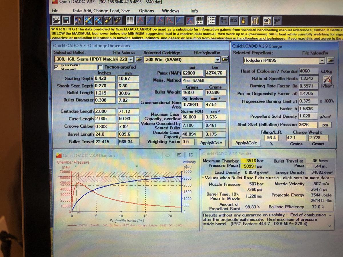

However, I have also used it in my M40 replica build with a Shilen 24" 1:10 twist barrel. This load performed well. See information below and quickload pic.
M1Army
Powder - 42.1 Grains of H-4895
Primer - Federal Match Large Rifle
Bullet - SMK 168 Grain hpbt
Case - New Winchester Brass
Case Trim Length - 2.005
Ogive Measurement - 2.2238 for this rifle/bullet combination after measuring the OAL with my Hornady Overall Length Gage and backing off the lands .020
Accuracy Node - QuickLoad shows 1.228 MS - which is exactly on Node #5 for a 24" barrel.

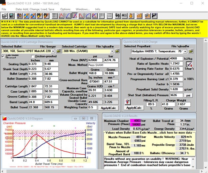

I have a 24" Krieger sporter barrel and got excellent accuracy with 41.0 grs. I got groups in the 3's with MV's at 2725 fps with single digit ES's and SD's (as measured by Magnetospeed v3). This is with Federal brass and Federal 210 primers. COAL at 2.847" where it's .010 off the lands and the brass was only neck sized with a case length of 2.005.
PS: Had to modify burn rate in Quickload to match the actual data:
