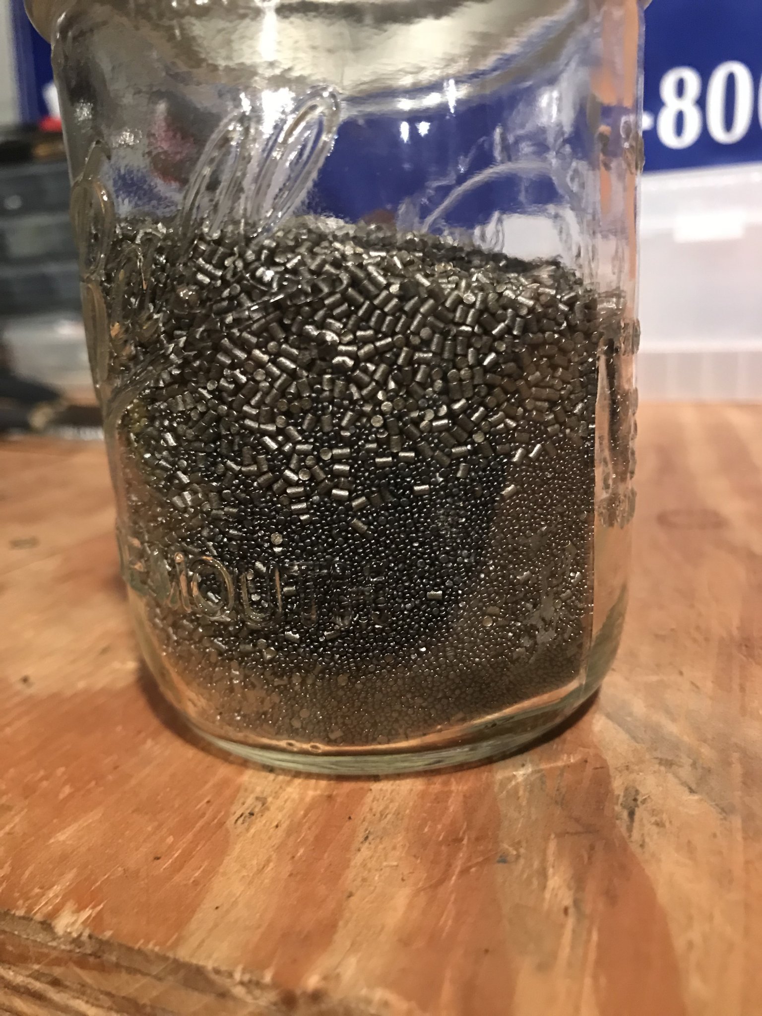

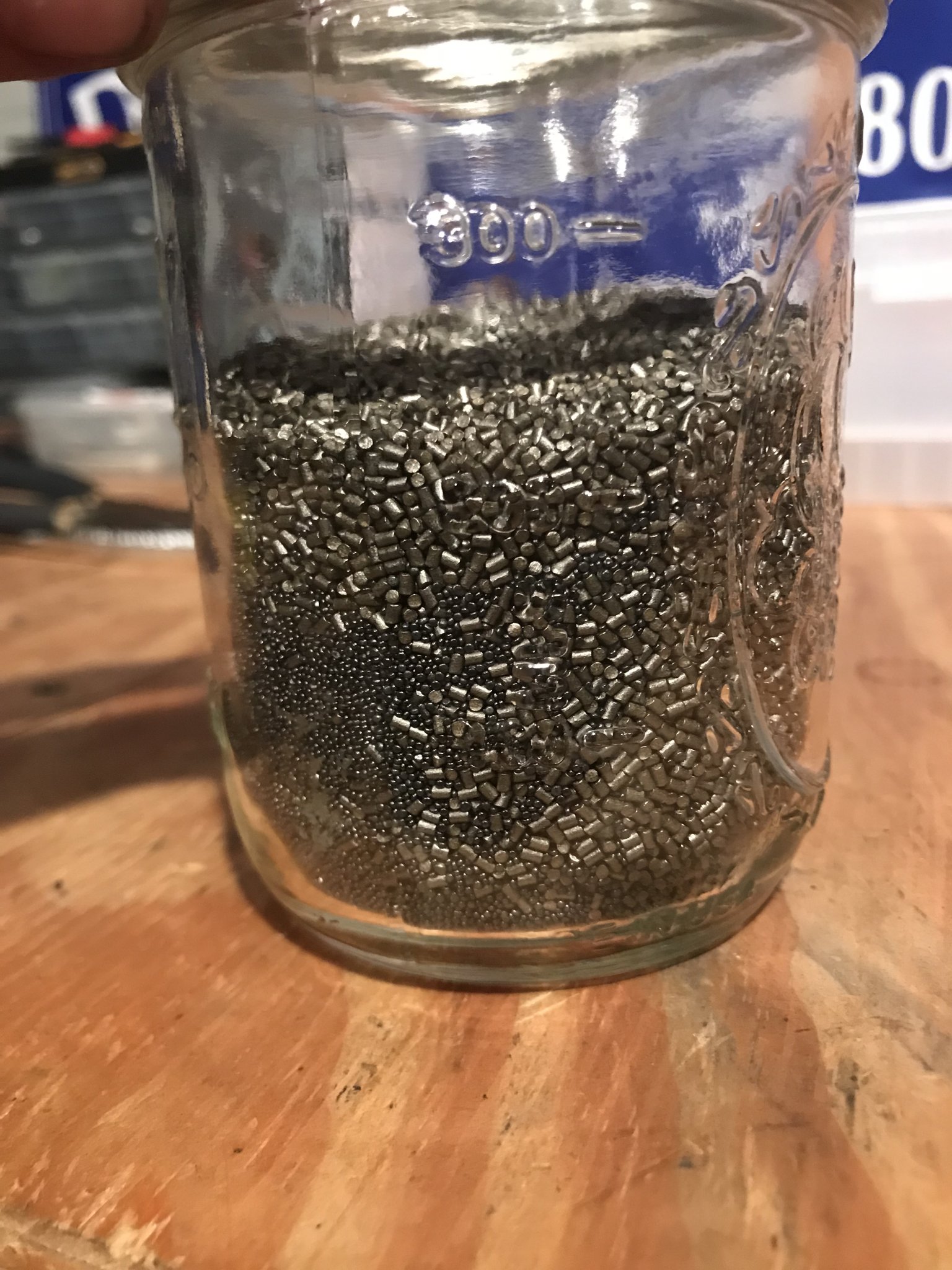

I purchased an open 8lb keg of H50bmg over the weekend from a guy on this site. I went to pour it into my powder dispenser tonight and noticed something odd. It looks like there’s some spherical powder mixed in. Is this normal? I’ve attached a few pictures.

Could that be IMR 5010 from 50 bmg powder mixed with some kind of ball powder 50 cal or ? Talon mixed 50 cal powder with 30 carbine powder one time. I know of a 50 rifle along with a few fingers that paid for that .
As has been said DONT SHOOT THAT POWDER.
