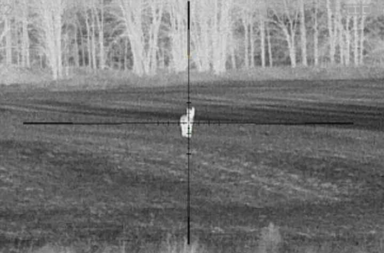

My dope at 400yds is 1.1 mils. The adaptive reticle switches from white to black unless there is a hot object in the center. So as soon as you elevate the reticle more than .5 mil, it switches to black on black and you can't aim.
The major issue is that with the adaptive reticle turned off, the default reticle color for black hot is a ..... Black reticle..... There is no option to select anything else. Again, it's impossible to precisely aim at a black hot object with a black reticle. How that made it's way into the programming of a $10,000 rifle scope is beyond me.

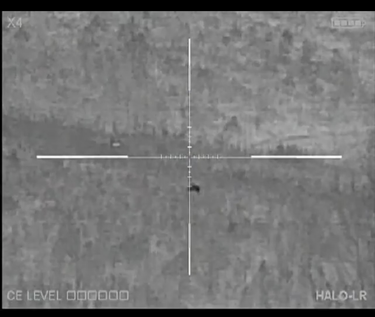

I’ve only killed 300+ coyotes with the halo lr so far. Plenty utilizing the type7 reticle and holds with kills to 500yd. I guess I have it in adaptive mode and not sure why you wouldn’t but I’ve never had an issue. I’ve also ran it many times on heated steel to 800yd.
I’ve only killed 300+ coyotes with the halo lr so far. Plenty utilizing the type7 reticle and holds with kills to 500yd. I guess I have it in adaptive mode and not sure why you wouldn’t but I’ve never had an issue. I’ve also ran it many times on heated steel to 800yd. View attachment 7759287
What happens to your reticle when you aim 1.5mils over that coyotes head? Mine changes to white and isn't visible within the animals body outline.
I tried to do a dope check on steel at 400yds and no matter what settings I used, I couldn't get a reticle that was visible on the steel for the same reason.
Reactions: BigSkyRF
I’ll double check it. I thought it stayed in that color when any part as on target. Maybe I’m simply adapting to it and don’t realize it. I’ll report back.
Maybe I need to make a video to better illustrate what I'm talking about, because it seems like some other scopes work different or have settings my XRF doesn't.
Another member suggested lowering the contrast so that the animal was more grey and then the black reticle might show up, so I'm going to try that when I get it back.
I'm up to 503 critters killed since I started counting ... and I think I recall have "reticle blindness" on 5 of those 503 times ... but I'm usually using UTC 320 or UTC-x.
