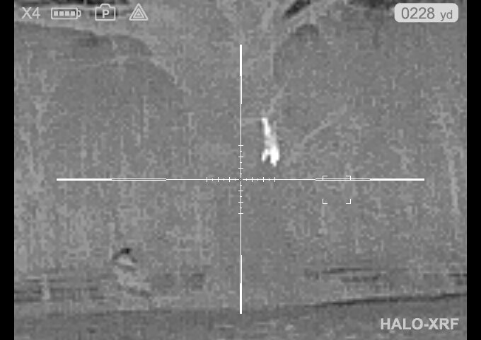

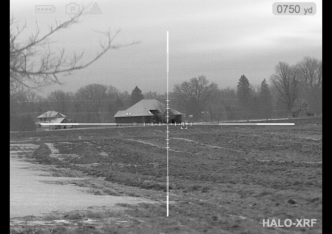

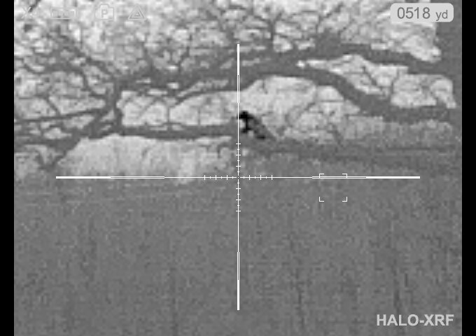

Took my XRF out last night. It was cold, windchill down in to the low teens. It worked just fine. Ranged trees out to ~800yds. No coyotes though. Saw something in the oak tree at 228yds that I have no idea what it was. The last pic is it descending out of the tree to the ground. The way it moved thought it might be a badger?? The house pic was just for reference.
