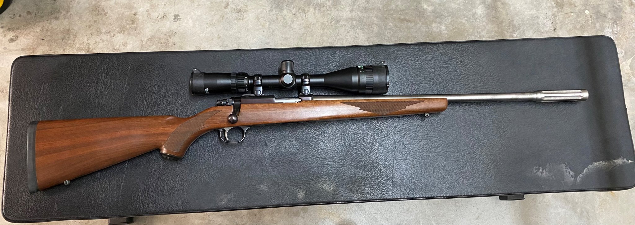

As to the Anschutz barrels, yes, I'm very familiar with the "Running Boar" barrels. As you said, the extra meat on the muzzle end helps prevent the muzzle bore from opening up on the button rifled barrels (though in the early 1900's they didn't fully understand why, as I recall). An added benefit (and how they got their name) was that the extra weight was believed to aid in swinging a barrel on a moving target. They have largely fallen out of favor since "Running Boar" is no longer an Olympic event (as it originally was intended). I actually have one of the Green Mountain prototype running boar barrels in 17HMR, stuffed in a safe somewhere, that were later available for time, during the early 2000's when there was a resurgence in interest of "running boar" targets with rimfires.
TBH, I had completely forgotten about it, until you mentioned them.
ETA: Not to further derail the thread, but below is a picture of what Frank was talking about (though this one was fluted for aesthetics as a one-off, though actually 5 were made this way). Come to think of it, I'm pretty sure this is one of ONLY 5 ever made with fluting. Production ones were solid, and fluting was never offered.
