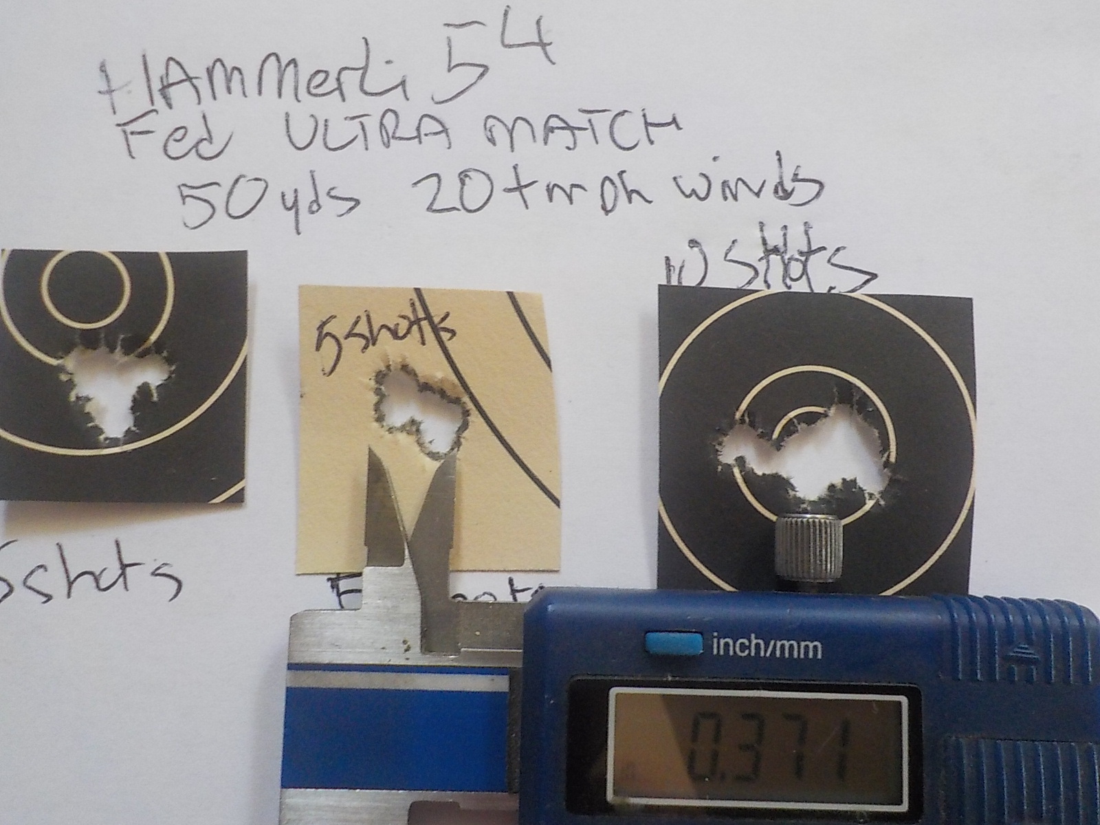

    Shot these groups today at 50yds using Federal ultra-Match. Winds were terrible, gusting to 20mph plus. I don't like to accuracy test in these conditions because it becomes more of a test of my wind doping abilities than a test of the guns accuracy...but the gun shot very well given the conditions. I didn't even dope the wind for the ten shot group.
    Shot these groups today at 50yds using Federal ultra-Match. Winds were terrible, gusting to 20mph plus. I don't like to accuracy test in these conditions because it becomes more of a test of my wind doping abilities than a test of the guns accuracy...but the gun shot very well giving the conditions. I didn't even dope the wind for the ten shot group.
    (y)
    You'd better hurry and go buy a case of that lot! ;)
    I don't know. If it shoots like that in gusty 20 mph winds, imagine the horizontal dispersion without that wind to blow the bullets back on target...:oops::LOL:
