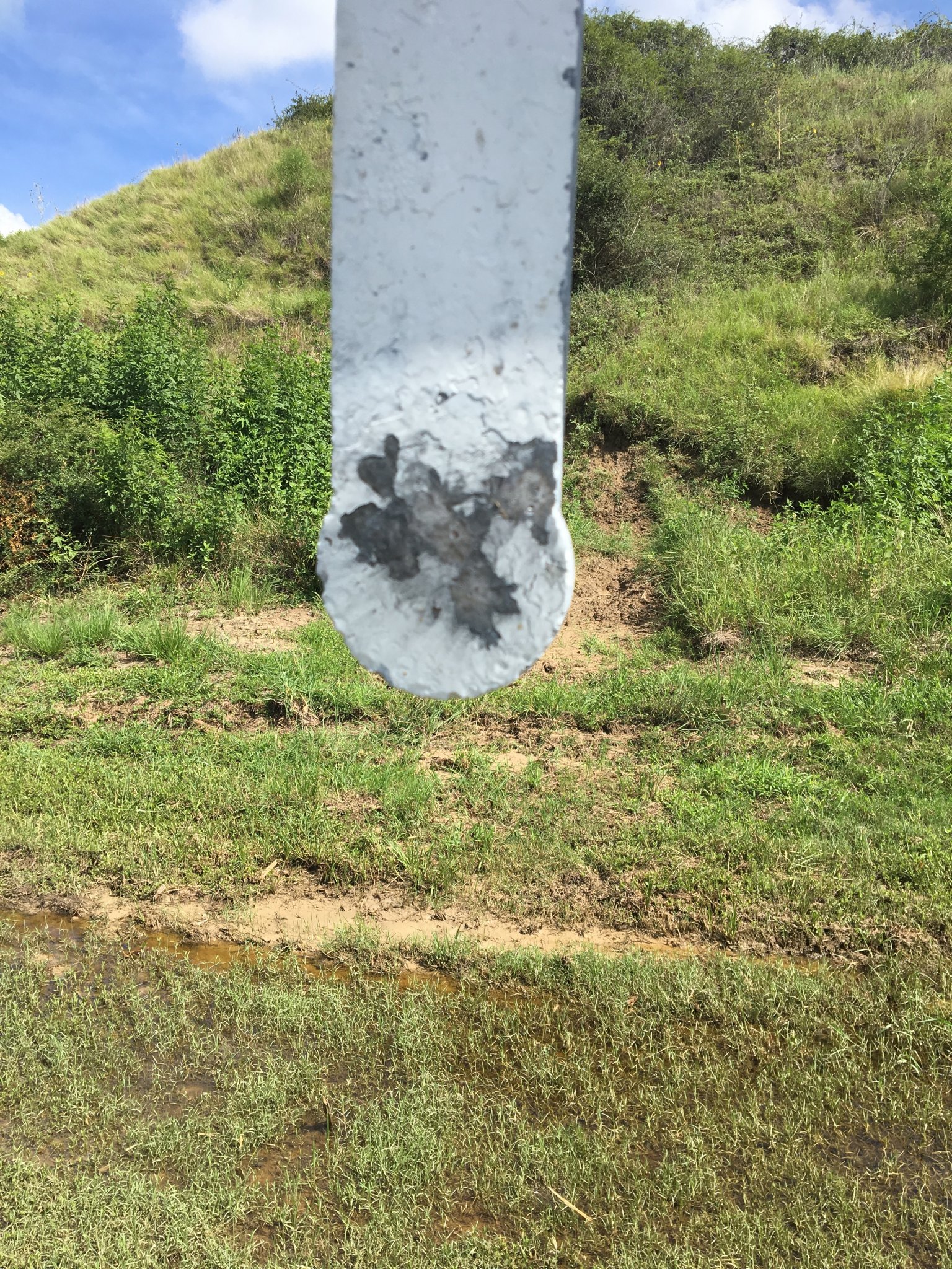

At 154 rounds down the barrel I decided to do another OCW just above my low node of 40.6. Zeroed my gun at 100y. Cold bore Shot and two follow ups. All touching.
[IMG2=JSON]{"data-align":"none","data-size":"full","src":"http:\/\/powerstrokearmy.com\/photopost\/data\/542\/Zero.jpeg"}[/IMG2]
Shot single shots from each CW at different targets to keep track. Two consecutive load increases per target. Final choice is between 40.9 and 41.2. These were shot at 395 yards and elevation is pretty even on both amounts of powder. Edit: 1” group for 5 rounds.
[IMG2=JSON]{"data-align":"none","data-size":"full","src":"http:\/\/powerstrokearmy.com\/photopost\/data\/542\/medium\/66CD4930-9B6B-49E4-970A-778F0374FB04.jpeg"}[/IMG2]
I’m loading now to 41.1 since the charge weight lower than these two was far apart and the one above was right above Zero elevation. Now to work on seating depth, testing was .020 off the lands.
I started 0, .005, up to .025 and .02 was the best depth for the above OCW test. I think I will now jump to .03, .04, .05 and see if the group closes up any.

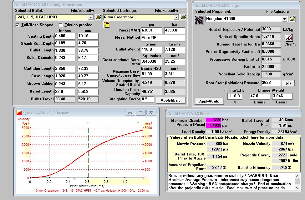

The load data for 107's and 110's doesn't list H1000 as a possible source for a charge. Wondering if there is any load data for those two projectiles using H1000 anywhere?
Not sure if you know how to read QL projections, but here is 115 dtac, heaviest 6mm bullet. The case does not have the capacity to run enough H1K at acceptable pressures, terrible burn rate, low efficiency too. I just used general prameters for the model.
If there was 130gr 6mm bullet, it may be perfect.
Edit: This is banking you could even get 47gr in the case.
Reactions: WT1

Thanks. I think I'll just go with a faster burning powder. Was trying to select powder to lower burn temp and rate to prolong barrel life. But if it doesn't achieve the velocity necessary, then you are just wasting projectiles anyway, which can add up just as fast as buying a new barrel more frequently.
I hate saying crap like this, but the powders between H4350 and H1K can seem like a dead zone of sorts. Not saying powders in this range wont work, RL 17, VV N550, maybe IMR 4955 and maybe others. I can tell you this, if you want to drop pressure with exceptional speed in 6 creed, try Norma MRP, beware, it is more costly, but almost always available. Good Luck!

When you go to Hodgdon's web site and use their data, they provide quite a few loads with H and IMR powders but they are all for Winchester large rifle primers. How do you factor in the difference if possible when using small rifle primer? I don't see that as a selection when requesting load data.
I spoke with G. David Tubb on just this subject once. He had put a lot of work into coming to terms with the small primers. In the end he moved on beyond the small primers. A lot of thinking on small primers is based on his earlier wok, and may not reflect his later work.
As I recall, his conclusion was that the only difference in load development between large and small primers was the powder charge, that the total correct available energy in primer and charge was the same for both approaches, and that once the load development was done correctly, neither large nor small held any significant advantage over the other.
I'm not in his league, but I think he's nailed this one.
Hodgdon's data does not give specific charges for specific barrels/rifles (that I know of), they post charge weight limits, and the shooter has to work out the rest themselves. Be arbitrary, choose one primer over the other and do your development.
One of my primary criteria for selecting components is that they be reliably available, and I offer this one for your consideration. I select brass on availability and this seldom favors small pocket brass.
When selecting powders, I try to find one that offers a very high load density (i.e. the correct powder charge fills most or all of the case capacity) at the preferable charge level.
Another preference I have is for longer barrels; my serious LR Match rifle is a 28" .260 Rem. This allows me to work around the H-4350 availability issues, and brings H-4831 into the realm of possibility.
Greg
