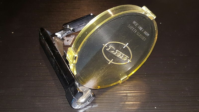

Been using my Lee Auto-Prime for many years. As long as I can feel the primer bottom out I'm happy.
What is a good hand primer that isnt too costly since i am trying to buy alot of this stuff at once.
chopit, I presently own an older Lee hand primer (round tray version) that has performed well for many years but has recently begun to show signs of wear on the plastic parts. I tried looking at Lee for replacement but their new design is more difficult to use and employs more fragile plastic parts than their older version. I suppose Lee may have come up with a novel way to do "product improvement."
Not satisfied with the newer Lee primer, I looked at many of the other priming tools mentioned above and settled on the RCBS Universal tool as it had a tray, relatively robust construction, and an attractive price. While I felt many of the available single feed units were excellent overall, I put great weight on not having to touch every primer and this is what finally sold me on the RCBS and after several months use I have been very satisfied with its performance. In fact, I'm likely to get another so I don't have to reconfigure unit whenever I change primer size.
