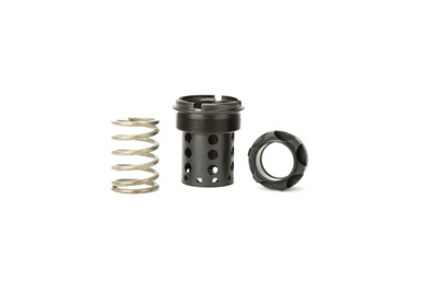

Griffin Cam Lok was made for this reason. I use them on my pistol barrels. Looks like an air hose fitting when the suppressor isn't attached but works well. Very fast to attach and doesn't loosen as you shoot. It's a taper attach device.
Just to let the OP know...there are two different types of these devices from Griffin. One is the Cam Lok and the other is the EZ Lok.
The difference is one is "QD" and the other is a little slower. The Cam Lok has interrupted threads. The EZ Lok does not.
I have used both and own both and the EZ Lok is more secure in my opinion.

Looking at these Griffin mounting solutions. Two parts: Muzzle adaptor and suppressor side adaptor. The only suppressor side adaptor that I could make work for my non-Griffin, but industry standard "Plan A" type can (HUB 1.375"x24) would be the 0.500"x28 DT suppressor side adaptor.
I have a YHM piston and buffer for the 1.375"x24 suppressor side. That piston / buffer HUB ends in a 0.500"x28 hole that DTs onto the barrel.
The Griffin solution would add 3rd and 4th device parts onto to my current mounting. This feels "not best" for mounting stack up.
Am I missing something?

It's not really adding 3 and 4 devices. The actual piston in the suppressor gets taken out and replaced 1:1 with a compatible piston. The only thing that is actually "added" is the tiny little muzzle device on the barrel.
What it helps with is having a much better lock up between the suppressor and barrel. It also eliminates the need to have different pistons for each host.
If you have a European firearm with weird left hand metric threads and then another with 1/2x28 you would need a wrench, a separate piston and break apart the suppressor in order to switch hosts.
With this one though you just move it back and forth at will and it takes less than a minute to take it off and put it on another gun.

OK, I got it. Understood. Swap the piston to an EZ-Lock variety or Cam-Lock type, and place a muzzle device on each barrel.

I was testing my new SilencerCo 9mm 1/2x28 barrel and YHM piston / buffer combo this weekend. (No Lithium jail break yet, just a dry run of the mounting).
At hand tight, as snug as I could make it on the barrel, the buffer and piston combo would come loose from the barrel within a couple shots.
Since its a tilting barrel and needs to be disassembled from the slide occasionally, can you recommend a method of a locking agent? Something other than semi-permanent Rocksett, or Red thread locker?
