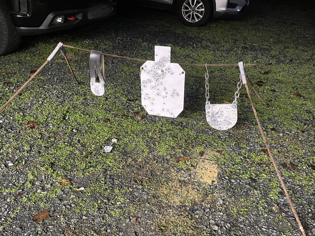

I have a rebar-based target holder I use at my gun club's rifle range. It's maybe 4' wide. Most of my AR500 targets are hung by chains and S-hooks but they usually start walking down the crossbar one way or the other and eventually slide into other hanging gongs. It happens more with my smaller gongs as they jump and twist more from hits than the heavier 6" and 8" gongs. Any suggestions for trying to keep the chains in place?
Rubber garden hose, cut for the separation distance.
A more elegant solution would be shaft collars
Reactions: Aftermath

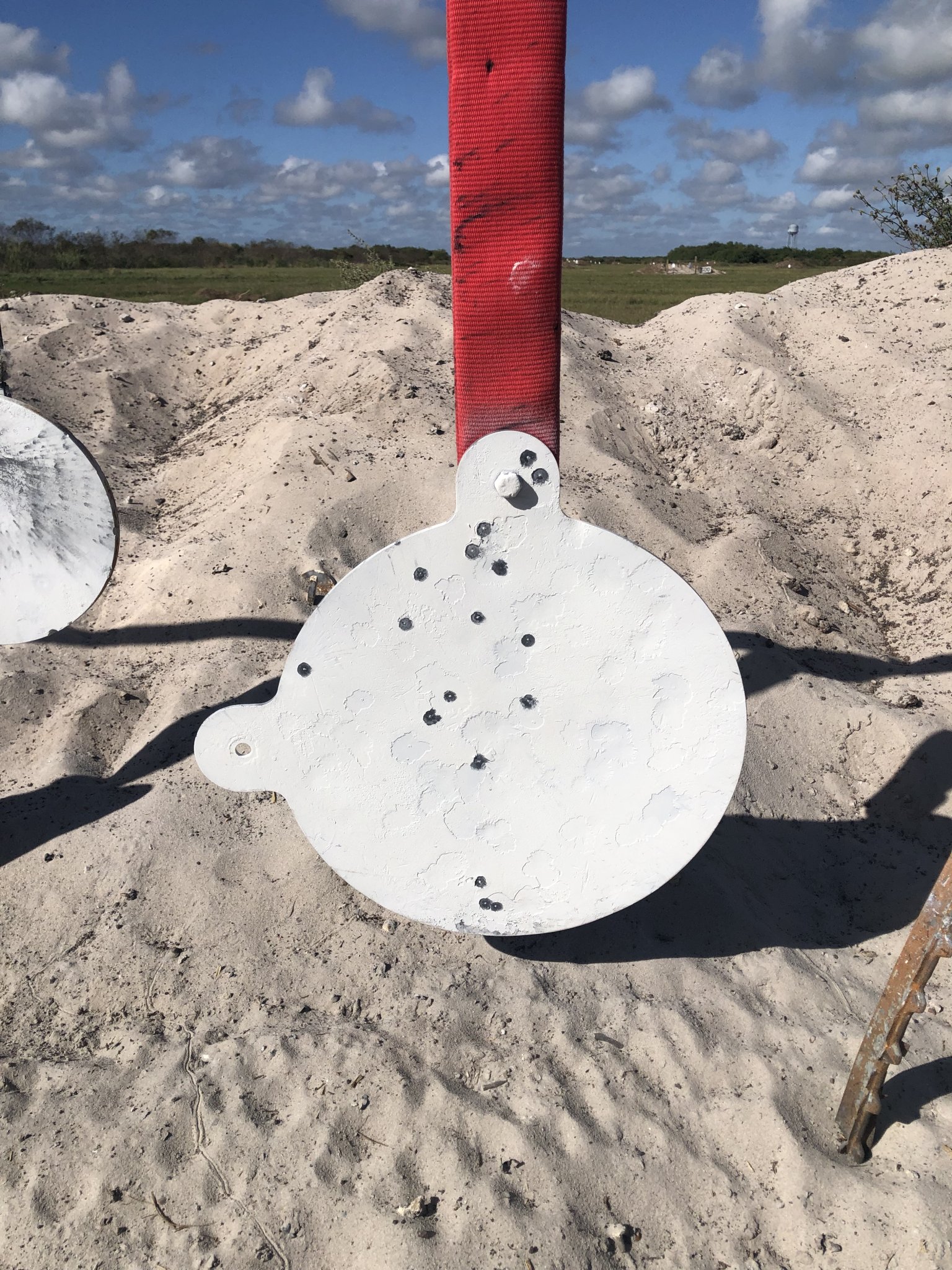

I use fire hose and have washers welded to the rebar.
I like hose way better than chain for hanging targets.
Do you find the heavy firehose dampens the ring from a hit on the gong? I feel like my gongs on chain ring a lot louder than the ones I hang using this heavy duty conveyor belt material. At one point I switched to the conveyor belt material because chains inevitably get shot to pieces.

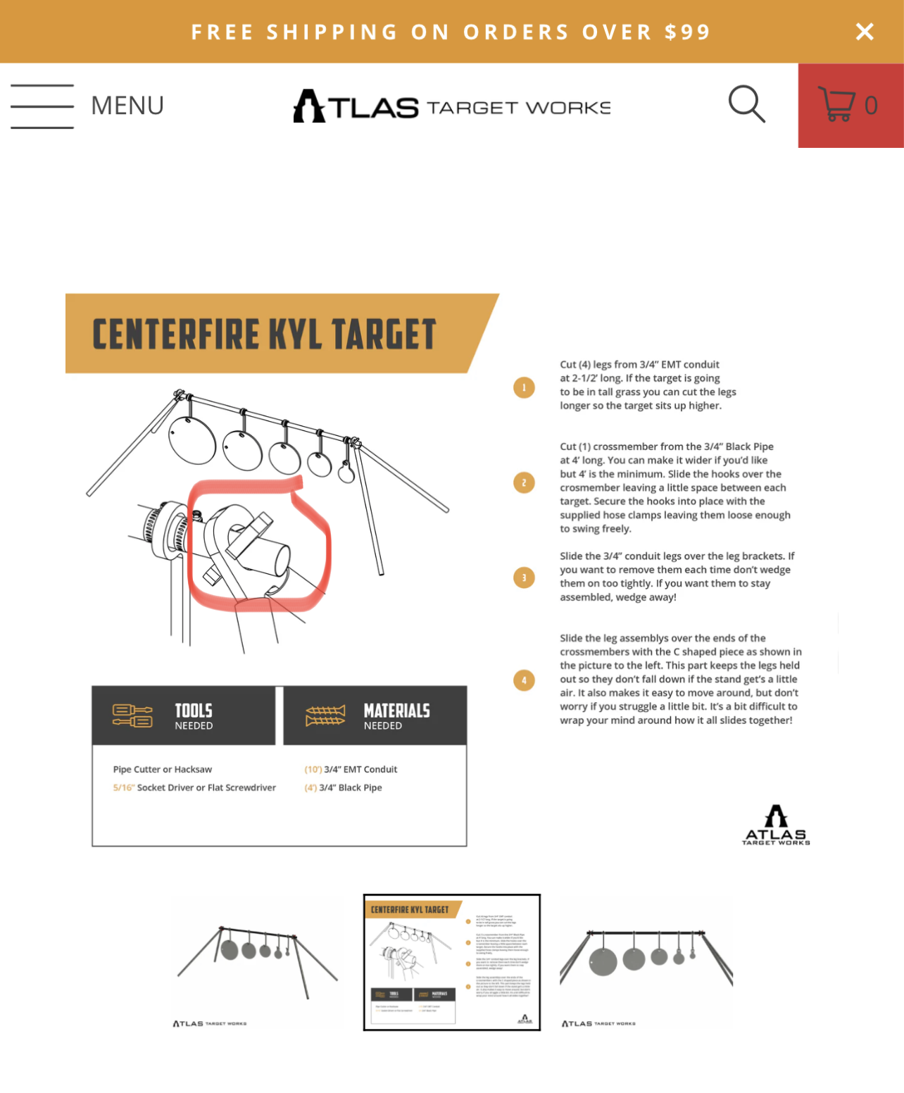

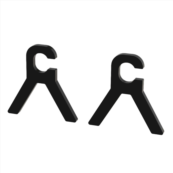

This system from Atlas Target works great! He doesn’t do a great job of differentiating it from his regular stand, however. Maybe you could use some of his ideas…I’m lazy and bought it last year.
You use a 3/4” black pipe (for strength) as the crossmember and 3/4” EMT for legs.
That additional “C” shaped piece (circled in red) really holds the setup together when a gong is smacked hard, and also when one is moving the target around. For the latter reason I’d get the C even for rimfire legs too.
See, with that “C” piece attached the legs don’t fall inwards when the whole stand is picked up.
It’s a little hard at first figure out how to install it but once you do, it’s genius.
If you order just his leg kit I’d definitely have him add it. You call to call or email, though.
The hanger attachments are low maintenance too, and the diamond-shaped holes on the gongs lock onto the hanger with no screws. Easy to remove too, 1 sec.

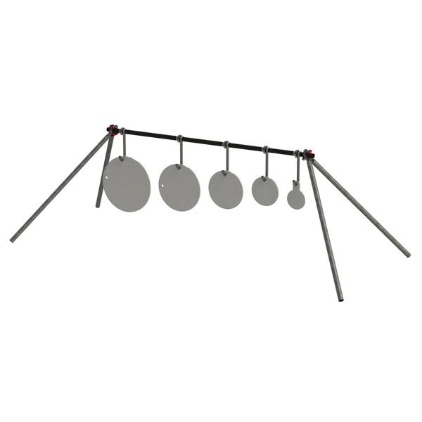

On centerfire KYL, he uses hose clamps to limit the hanger+gong from moving. On the rimfire version he uses pipe spacers plus two slightly fancier collars on the ends of the spacers.
Here’s the full centerfire version with that extra C piece.
Here’s some cheaper options (but call to get that extra C)
I don’t know the dude or get kickbacks etc. just love his product.
I have no problem hearing the impacts. I couldn't tell you if it's dampened though, no chains to compare.
