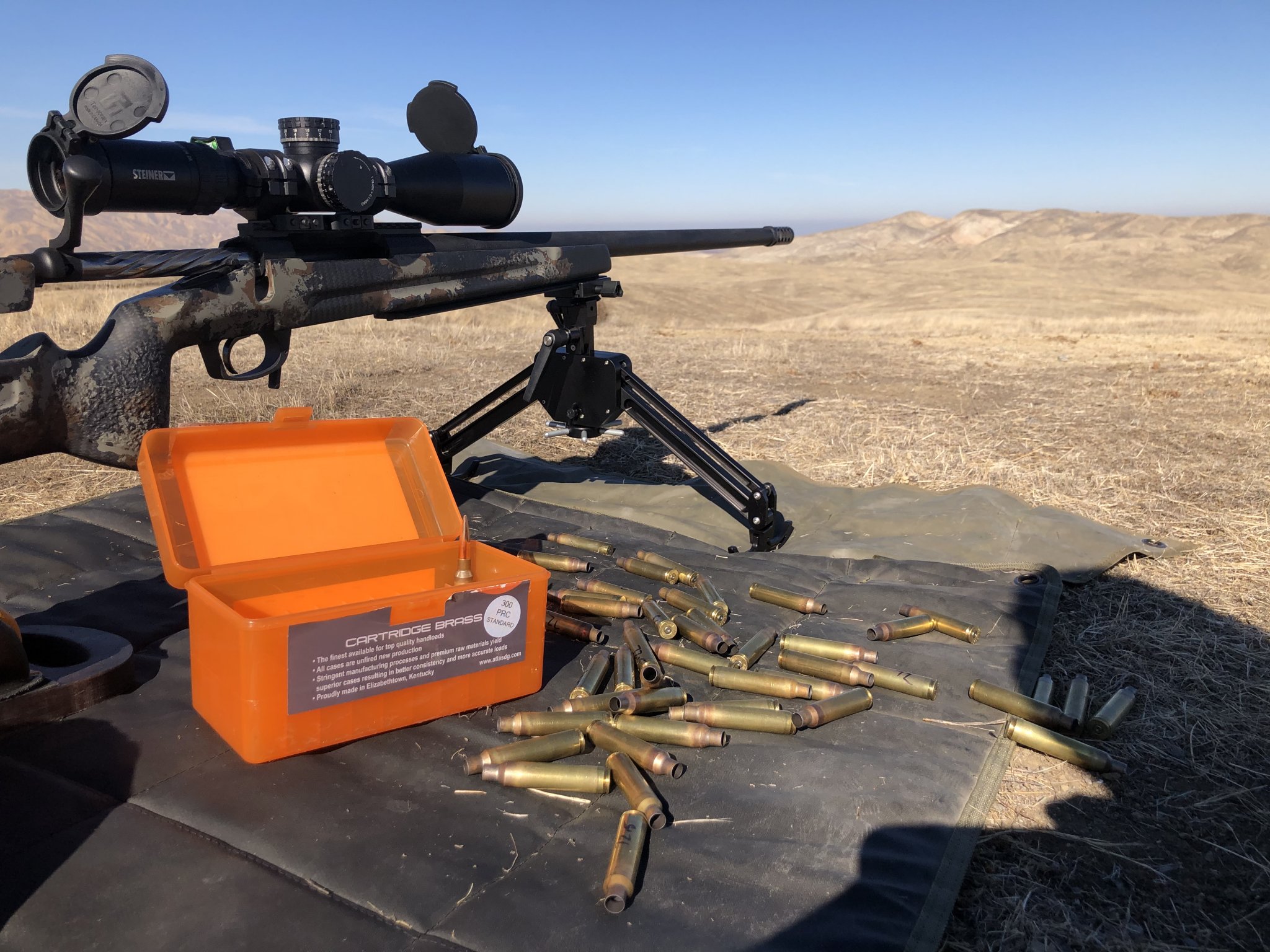

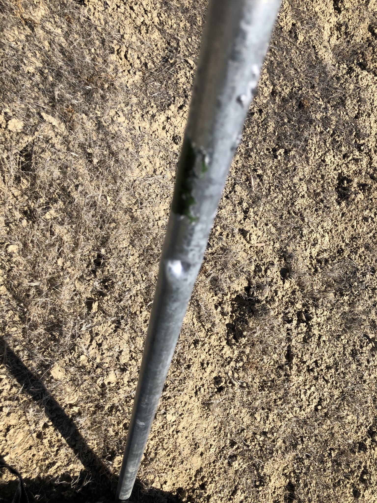

    The last shot...
    Not shown in the above picture is the ant that was crawling up the pole...that was the point of aim :) He went splat.
    Actually, he jumped on the bullet when it bounced off.
    Seriously, never hit the target stand at this range - still surprised it didn't penetrate.
    Berger 230
    EDIT: Much lower muzzle velocity too. I'm not batshitcrazy like you are :)
    Currently testing Berger 245 EOL's at 2860fps....in a 29.5" Bartlein....Hopefully get back the 1 mile range next week...interested in untouched bullets vs the ones I'm uniform trimmed the meplat and re-tipped with the Hoover die. I'm looking for whatever edge I can on vertical spread. RL-26 and FED 215M's have me some stupid low ES/SD's for a friggin 30cal magnum.
    Now that I've finally got my 230s set, I'm going to play with the 245s next - thanks to you...
    My first 15ish shots on my 230 load came in at 4.2, then fell off later. I think if I'd let the barrel cool it would have been better than the 6 I ended up with.
    Also, how did you end up on seating depth with the 245s?
    Well...sit down...you ain't going to believe this. I loaded the 245's in the same Sinclair/LE Wilson arbor press seating die as the 230 A-Tips....which were 20 thou off the wall of the MDT 300PRC CIP mag......these Bergers FIT in the mag and operate good. So...mag length....shot a few 1/2" groups....moved the barrel tuner from the #4 mark to the Zero mark to start...shot slightly under a 1/2"...called it good. The powder load is the exact same as the 230's. 75.0 gr of RL-26 in ADG brass. 230 A-Tips shot 2880fps on a cold day......245 EOL's shot 2860 with the same powder load a few minutes later....bam....done.....will have to check for pressure when it warms up and that velocity starts creeping up.
    Greatest thing about exact measuring of powder in a AutoTrickler V3.....is skipping the velocity node testing...just go straight to finding a speed you like without pressure....and then doing seating depth testing.....Initially with the 230's I treated every mark on my barrel tuner as about 5 thou of seating depth...seemed to work for this round, this bullet, the barrel, this powder, this primer......yada yada.
