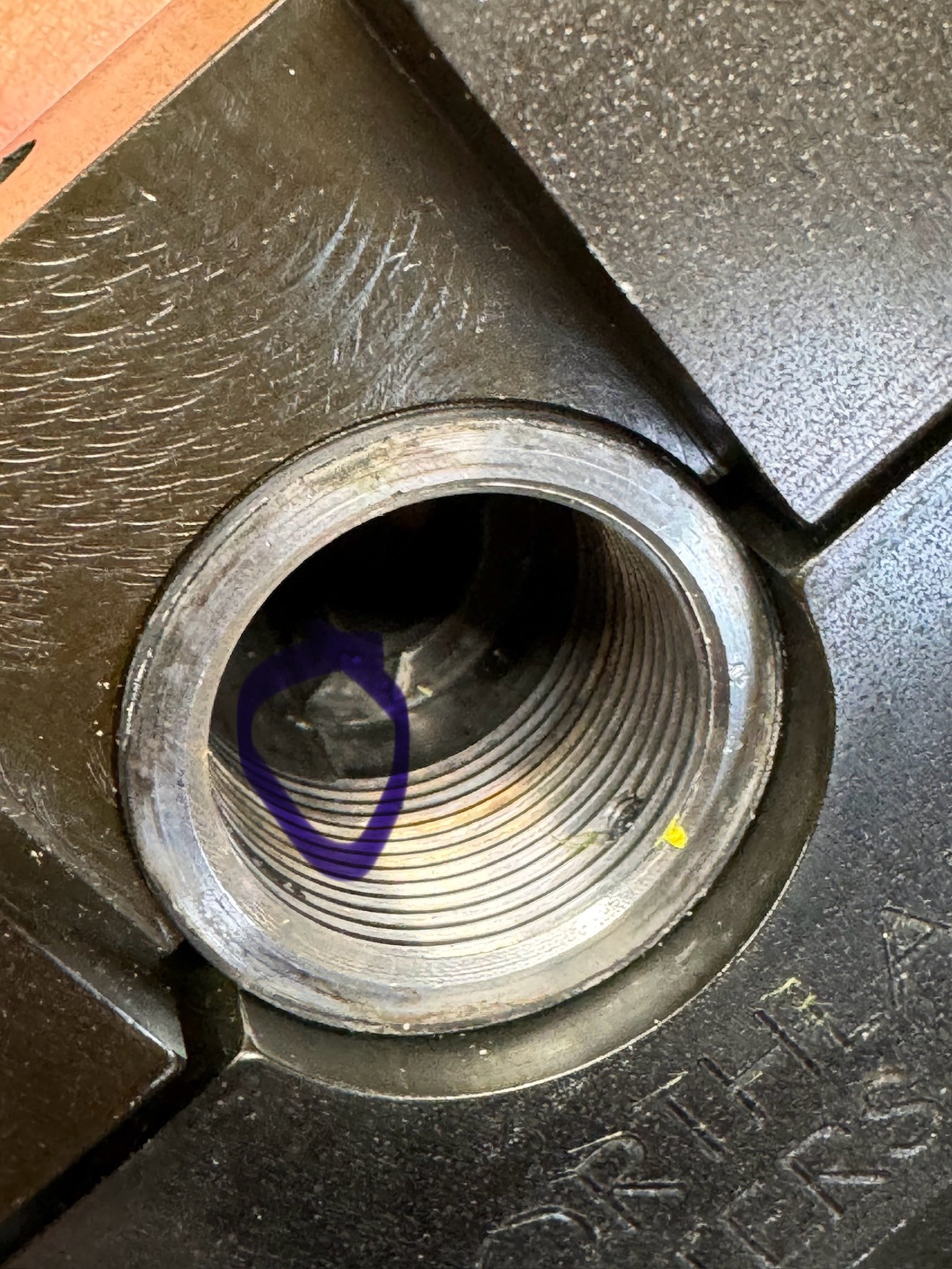

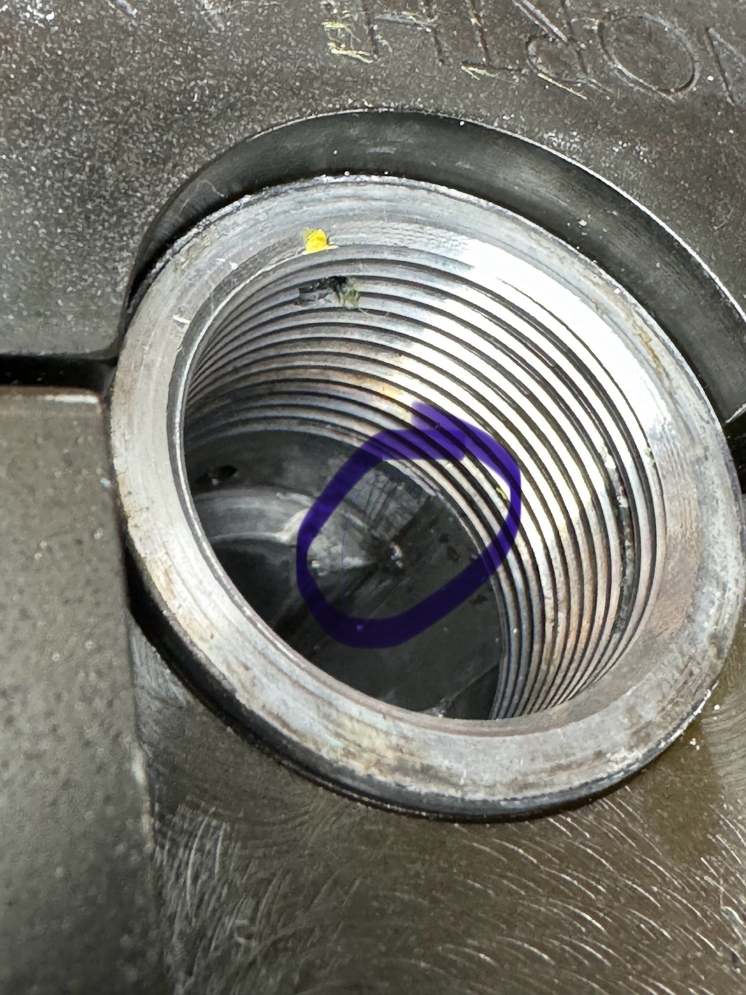

    I took the action off and inside, there’s a bug/smudge it looks like and then where the lugs would go, as you close the bolt, one side is smooth, and the other has a step up. I believe this is what my lug is catching on, making it hard to close the bolt
    Reactions: hafejd30
    Spitballing here because I'm not looking at it on the bench...
    Does Remington still use broaching for the lug raceways in the receiver and not EDM?
    Looks to me like the broaching is too deep- and the lug has to work it's way over that hump I'm seeing to seat on the abutment.
    I can see (I think...) the lump of displaced material from the broach there.
    What's the opposite side look like? If that side is proud and not recessed, the broaching wasn't centered.
    It fits with your symptoms. The bolt/bolthead is not centered in the receiver- so when you chamber a round, the boltface isn't lining up on the case properly and you're forcing it into alignment so the extractor grabs the case.
    If the receiver's fucked up because of bad broaching, blueprinting ain't gonna fix it. Did you email these pictures to Chad first?
