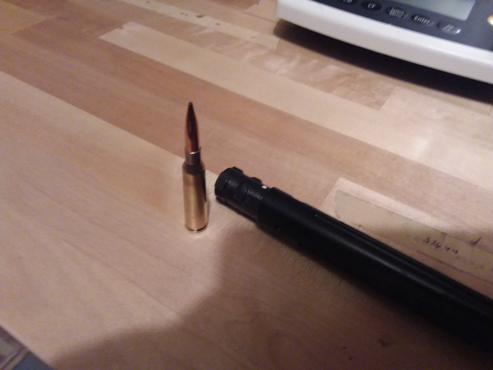

    I just tried it with Lapua 6.5x55 brass and a 308 axmc bolt, it won't fit although it doesn't seem like it would take much to relieve it, I would think the bolt body would be ruined for the 308 family
