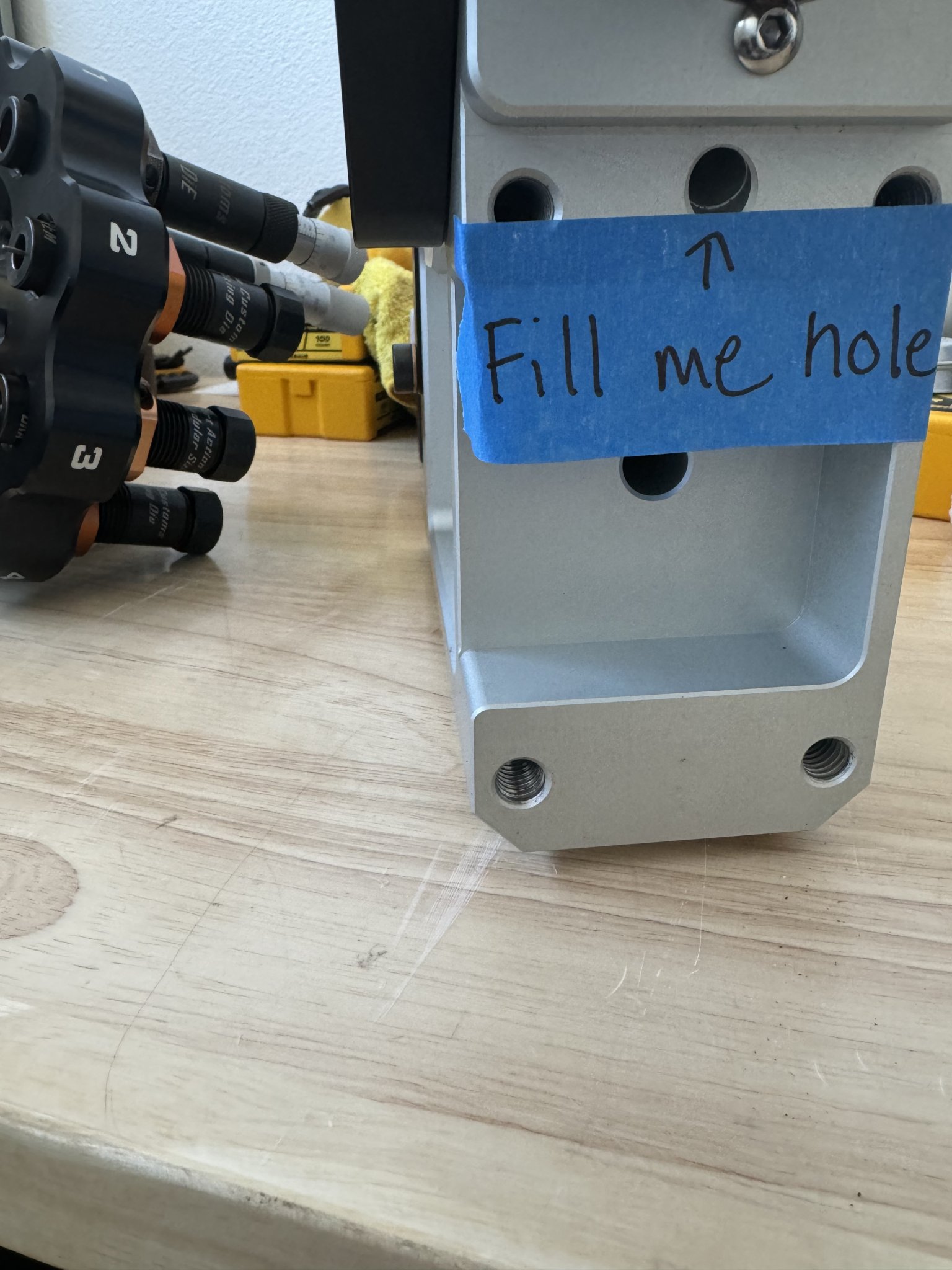

If you're ever working the ram on your 419 and the press seizes, the Zero Reloading Press Secret Accessory Primer Prison Pocket, or ZRPSAPPP (you know how much the people love acronyms), is probably cram full and you'll need to search for it like a customs agent on an inbound flight from Bogota. You will find zero information out there about the ZRPSAPPP, but I am here to tell you it's real.
BEHOLD THE ZRPSAPPP! Nestled in-between the front two mounting screw holes, covered up in secret, it's right there waiting to fuck up your day when/if it fills up with primers. I have been told this is a secret feature.
Has anyone else discovered the ZRPSAPPP from their press bricking itself?
Your telling me... There really is a third hole?
Yes, if you’re ramming away and it gets stuck, remove the member and root around in the 3rd hole until clear, then insert the member again to hammer away for an indeterminate period of time until you must repeat.
Wild thread - but it's for sure there. Well, it was.
That hole is on several thousand presses, and was initially there to be a place that gunk could be disposed. "Trash chute" is our internal term.
What we have found over time though is that sometimes a primer that is drawn back into the case (buy a spring-loaded decapper, regardless of press, and thank me later) will finally release when you remove the case from the shellholder, and it can fall down in there, eventually causing a problem.
So, any press made in the last few months is actually not without the hole.

It can certainly fill - it was intended to. It can also keep a trapped primer or loose debris from digging into the linear bearing.
Though I'll keep saying, it's something we've chosen to remove.
Rather than doubling down on a design choice that may not have been ideal for everyone, we changed the design in some test units, and when the result was positive, we made a change. It was a small change (kind of like there is now a new long hole up the back that allows a stuck turret detent bearing to be blown/pushed out) that we didn't charge more for or make a big deal of. Just worked it into production because it was the right move.

No, there is not. Again, it's something that negatively impacts a VERY small number of people.
If it's a big deal to you, shoot an email to [email protected] and we can change an internal part to block off the chute. You'll have to pack it up, and it may take us a couple days, but we will send you labels for the freight.

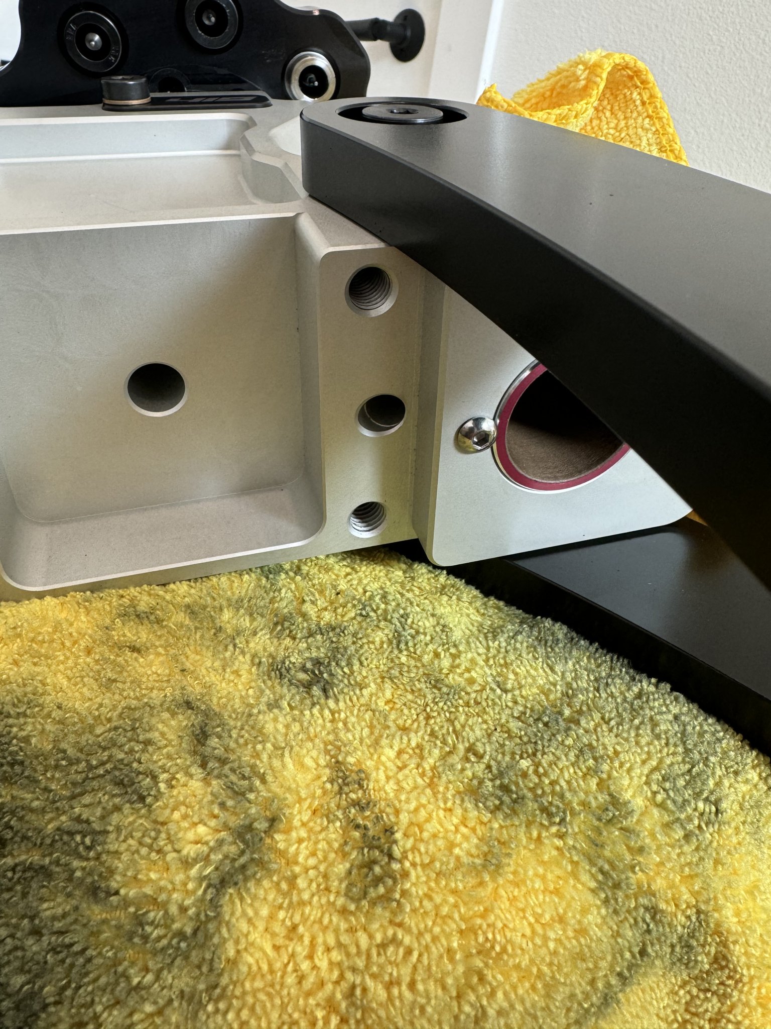

I guess I don’t really understand the geometry of this. I’m look on my buddy’s when next at his house.

There is (was) a diagonal channel from the hole in the picture to inside the area where the ram rides, and at the bottom of the stroke of the ram, the primer drop hole in the ram lines up with this secondary primer drop hole. Pieces of primer and gunk may fall out and eventually fill it up because the exit is covered when the press is mounted.
It’s difficult to see the inlet unless you remove the ram.
