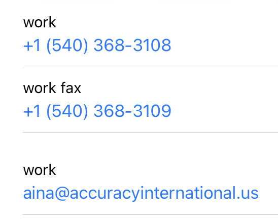

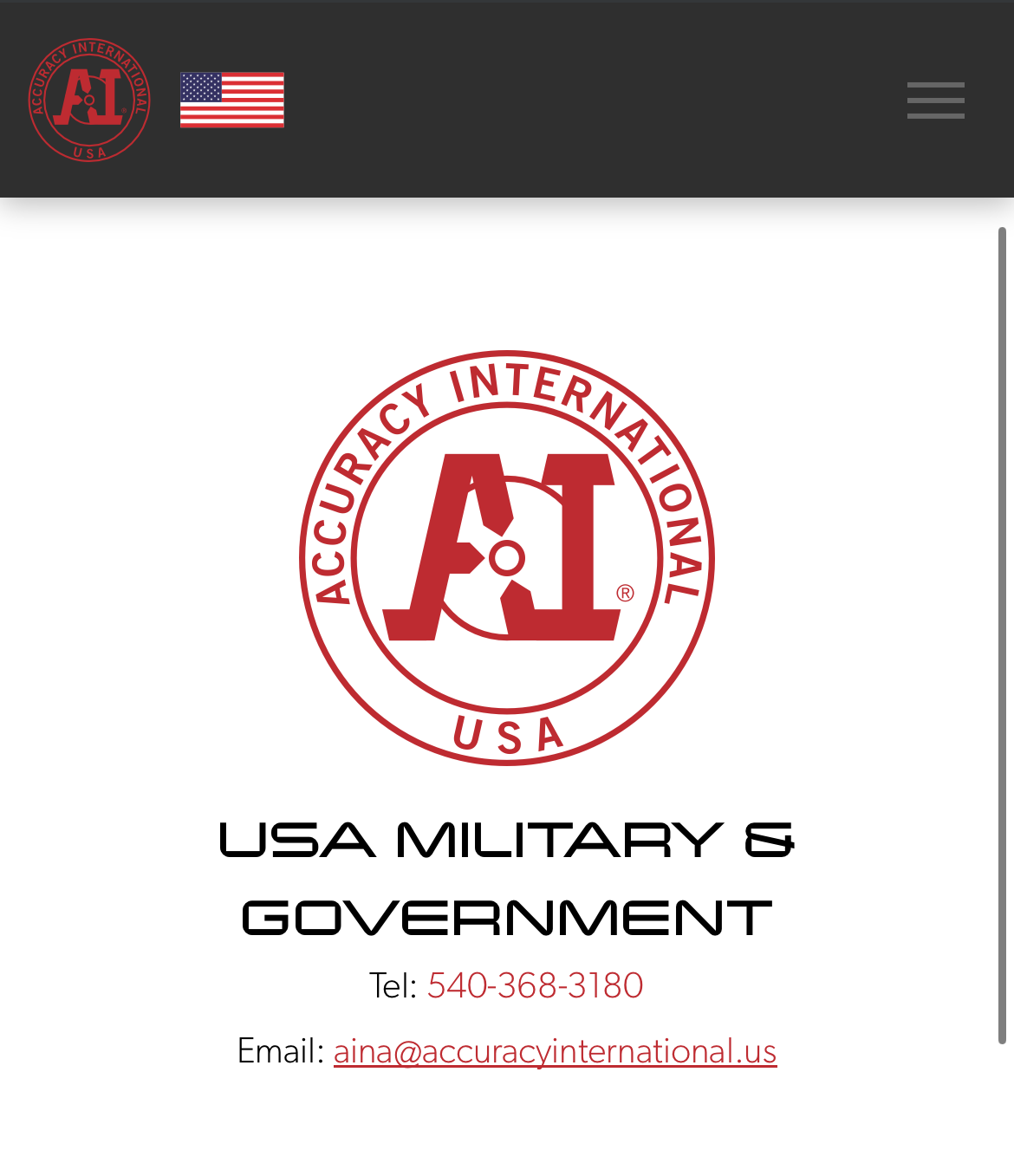

No fuckin wonder I couldn’t call them. Whomever put the number on the website is dyslexic!
Jeez…

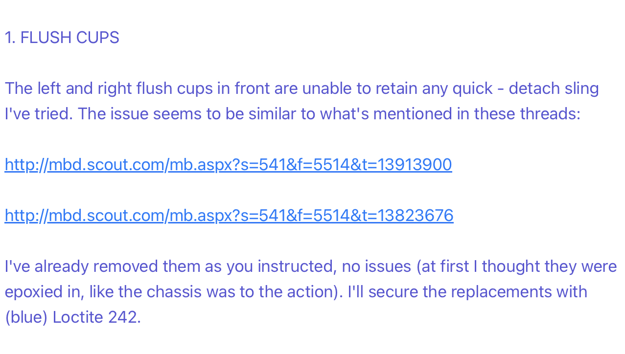

I don’t know how the URL syntax changed during / after the Scout debacle, but those were the threads covering this issue (and quite a few others, I recall).

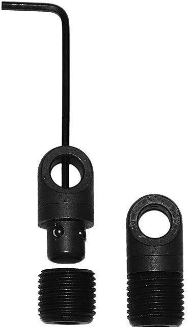

However, with GrovTec’s little adapters like these I would strongly advise against them unless you test the ever-luvin’ shit out of them first. Maybe not even then.
https://grovtec.com/products/snap-hook-multi-adaptors
https://grovtec.com/products/multi-adaptor-stud

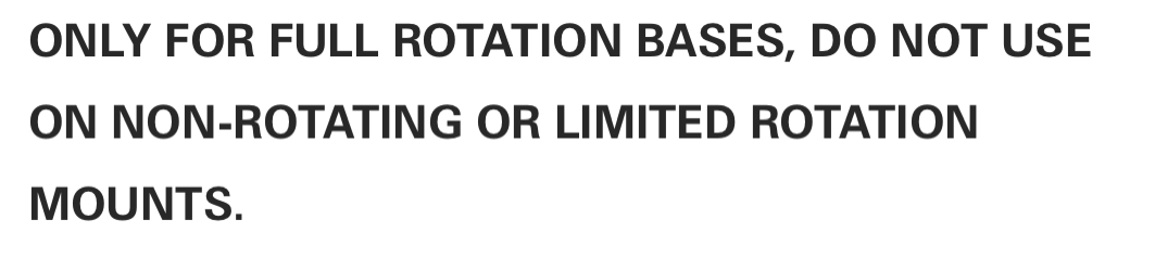

I had five to six unscrew themselves when I was testing them in a limited rotation base. I think I might be one of the reasons they now only sell them in conjunction with regular bases and now have this warning up on their site:

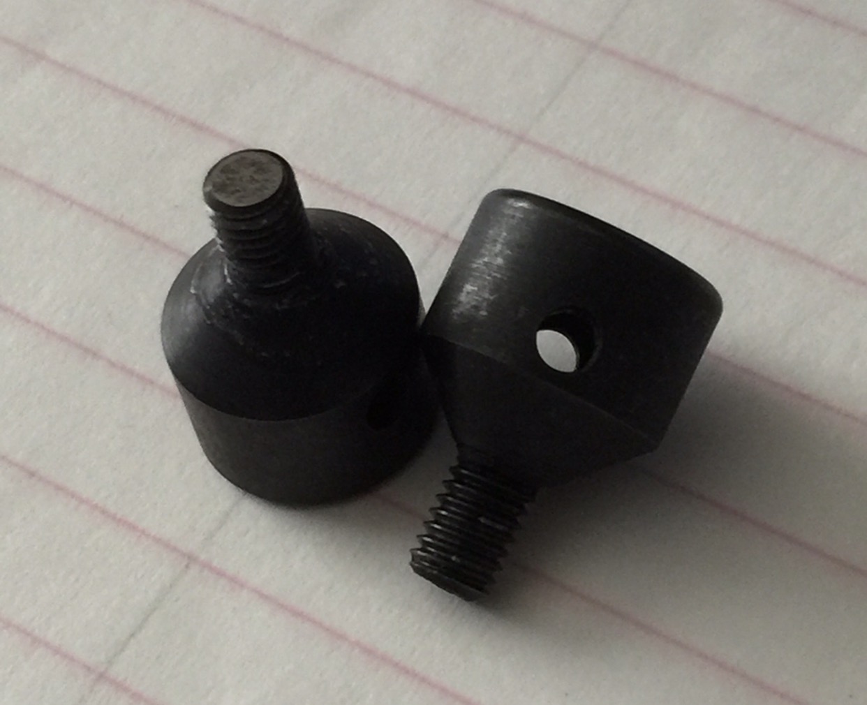

The Failure Area:
The part with the hole attaches to the male bit with a tiny screw and some locktite (assuming it was supposed to be red). In mine the factory locktite squirter must have been down for repairs lol.
Too bad it isn’t made as a solid one-piece, if that’s even possible with how a QD like this works. It’s a great idea.
