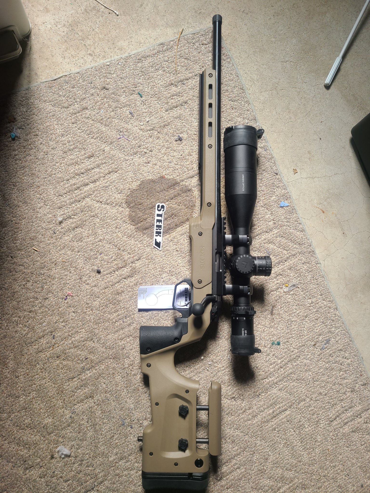

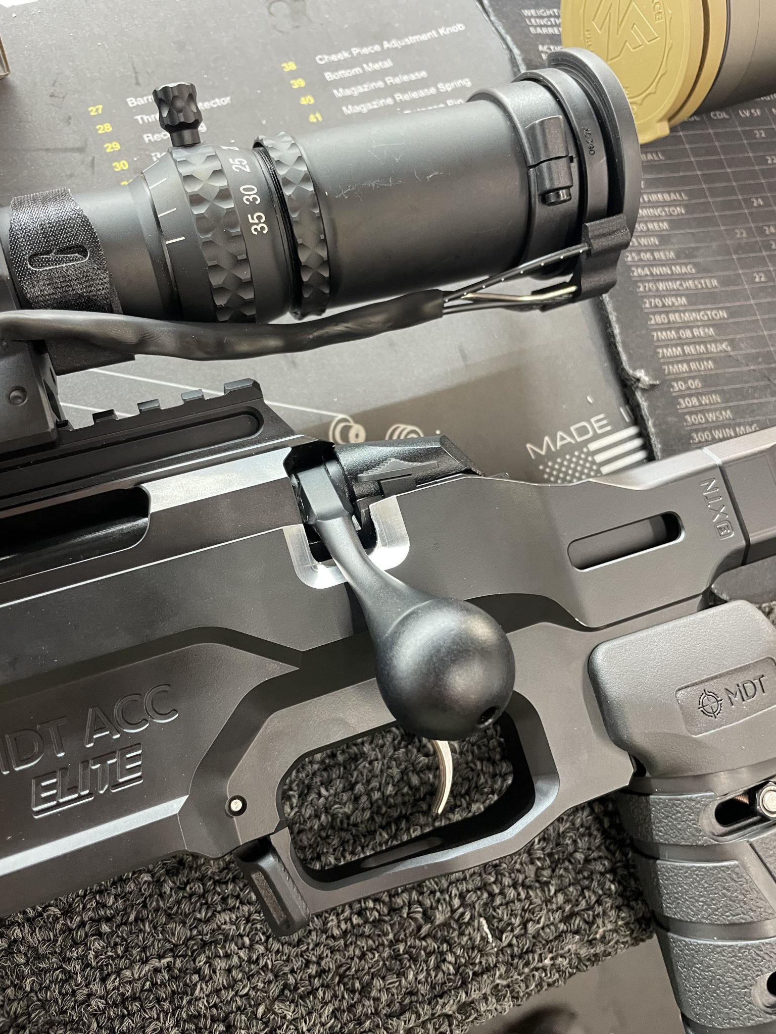

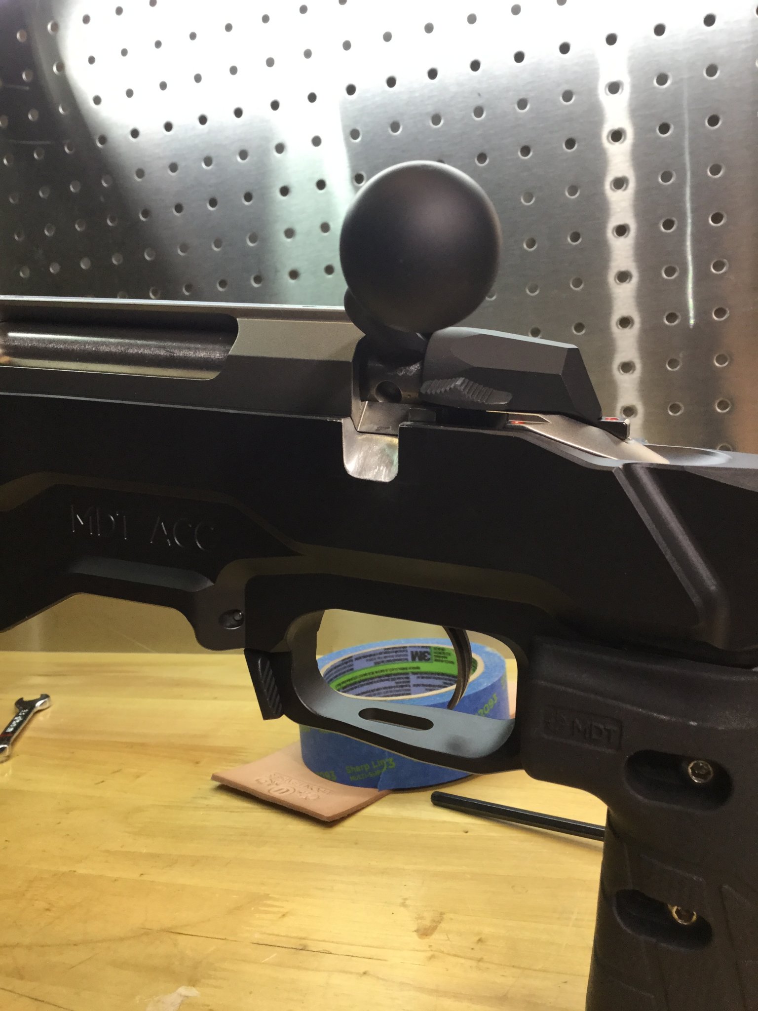

Not one of those but I did my Mdt Xrs for my t1x. Got it from black friday 2022. Used my Foredom (better than dremel).
Before
After. Covered aluminum with some black nail polish. Too many layers.
Normally shoot with my Thunderbeast 22td.
Reactions: Dkas

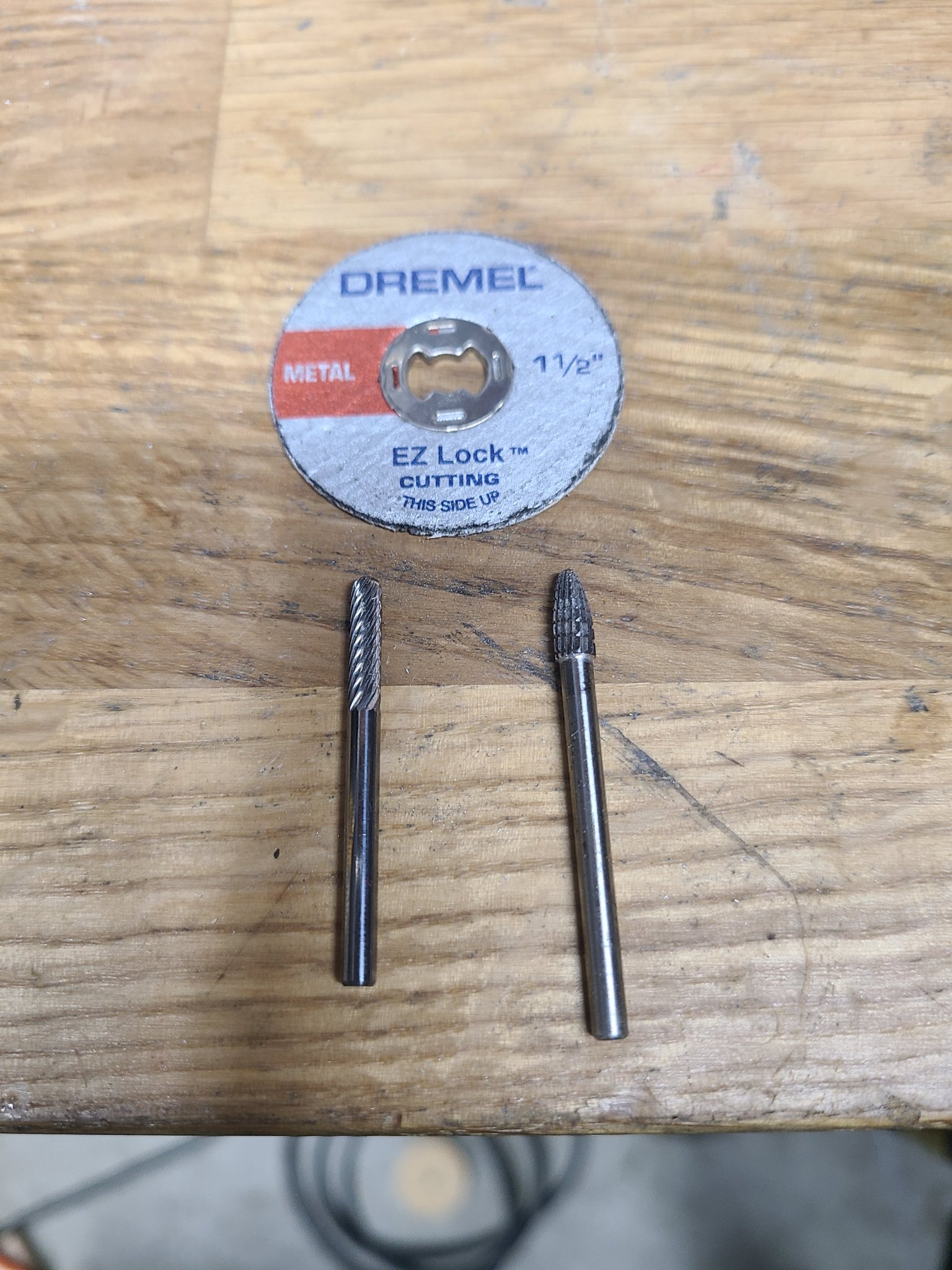

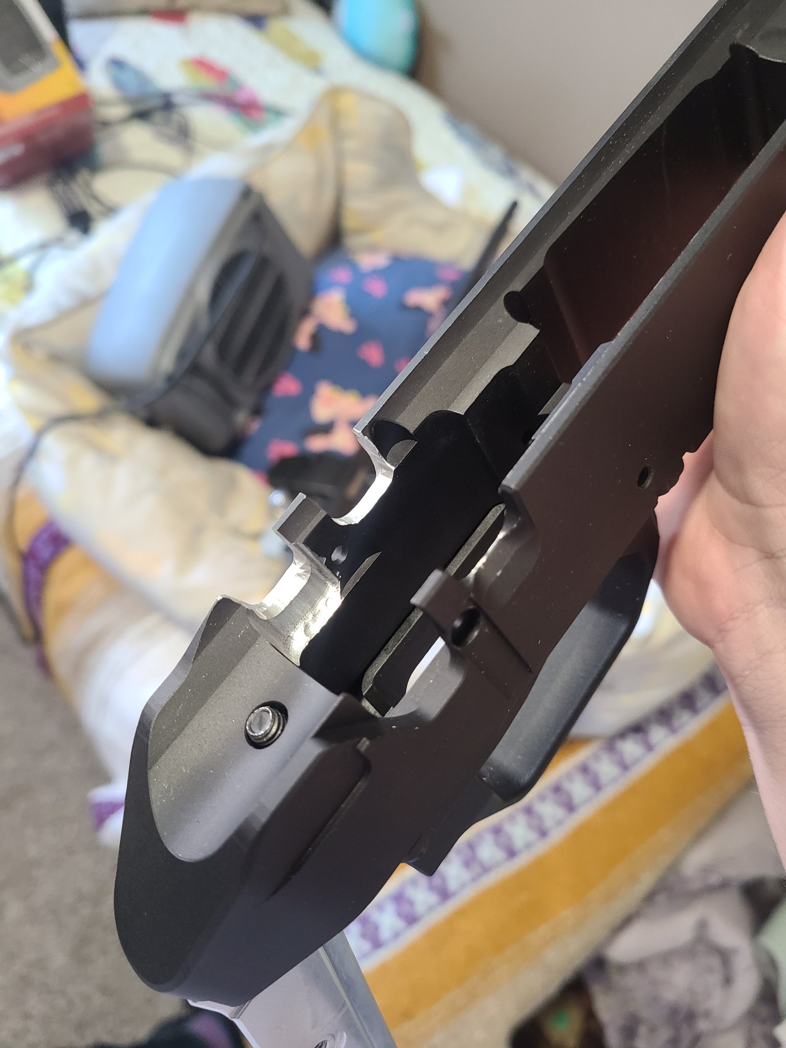

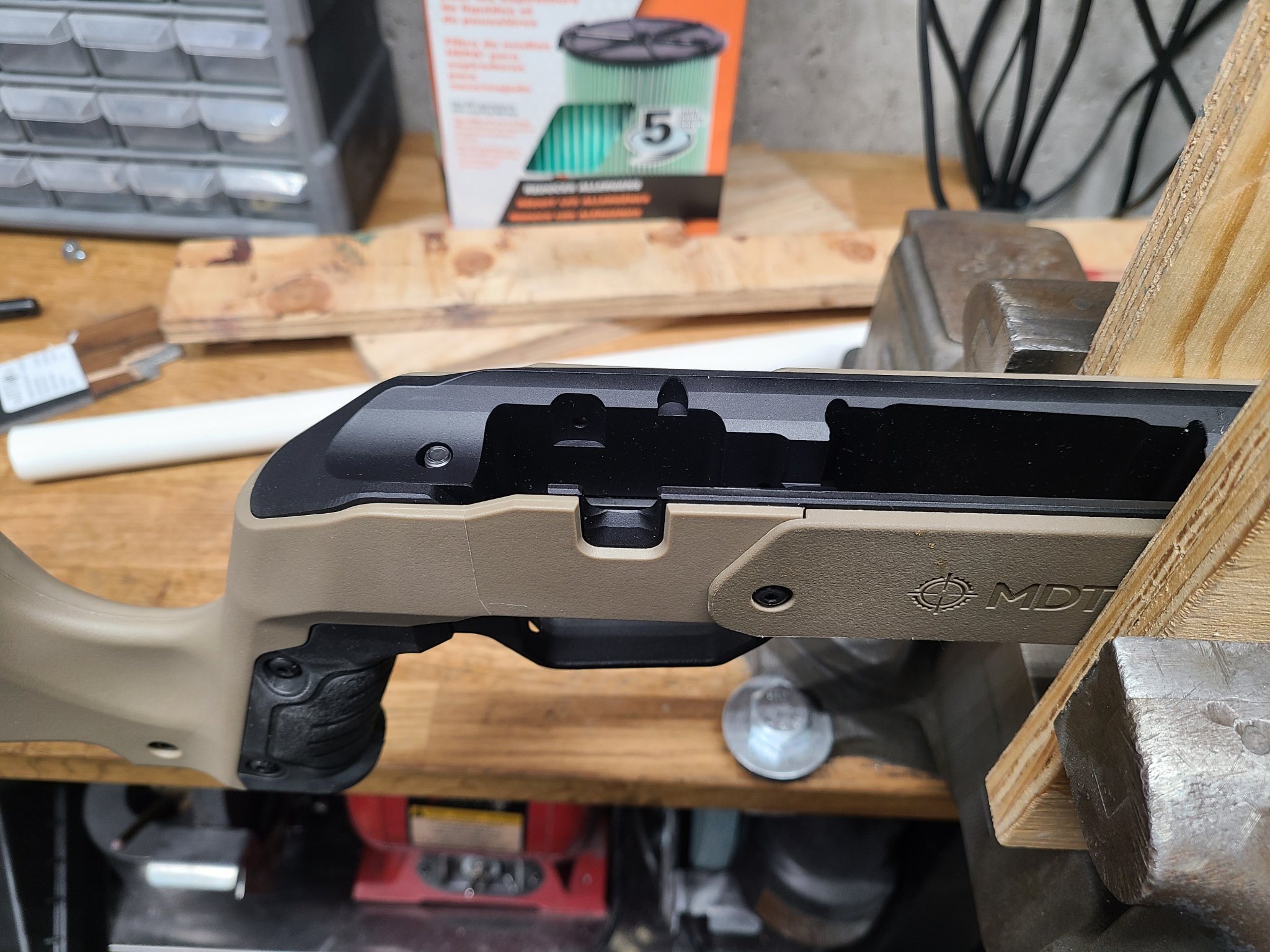

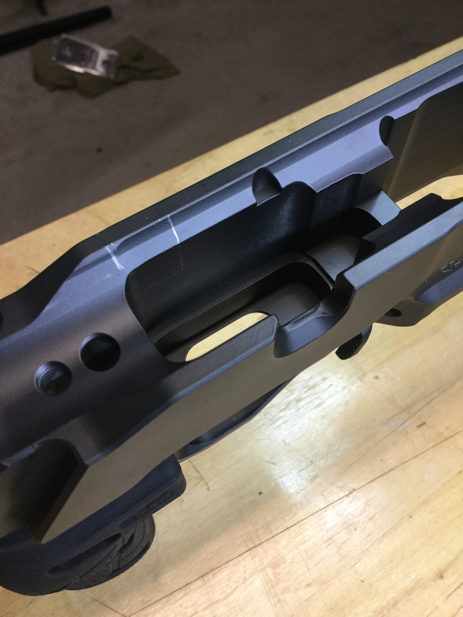

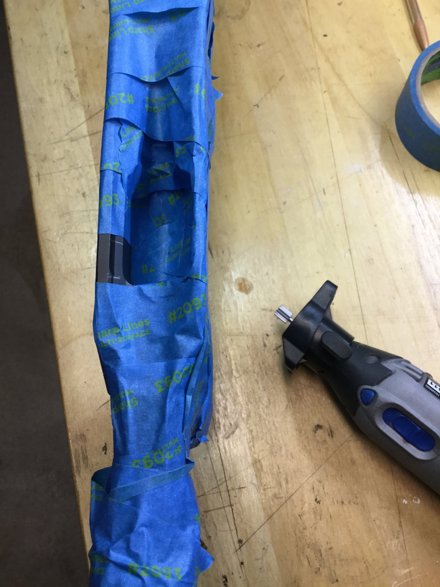

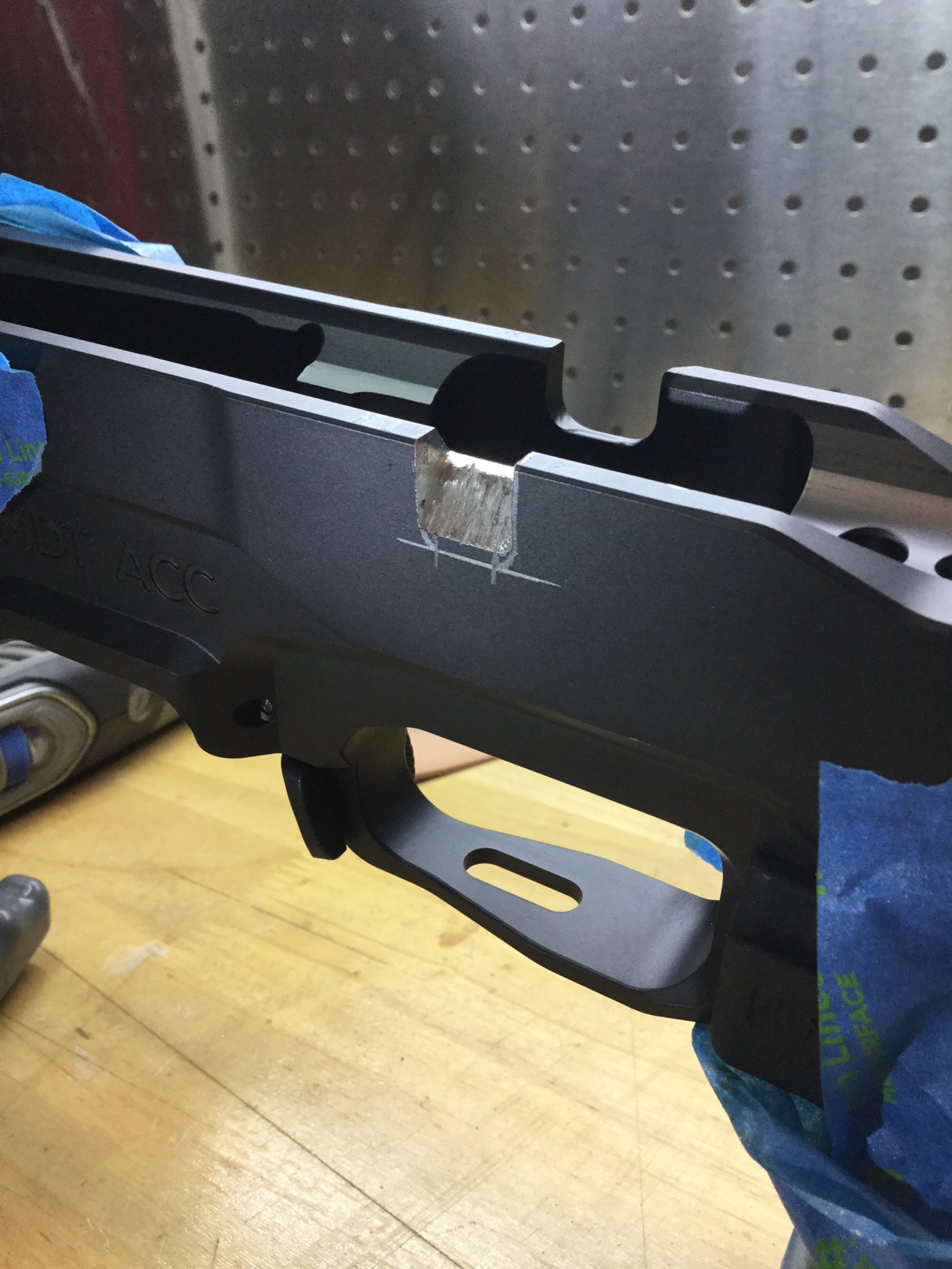

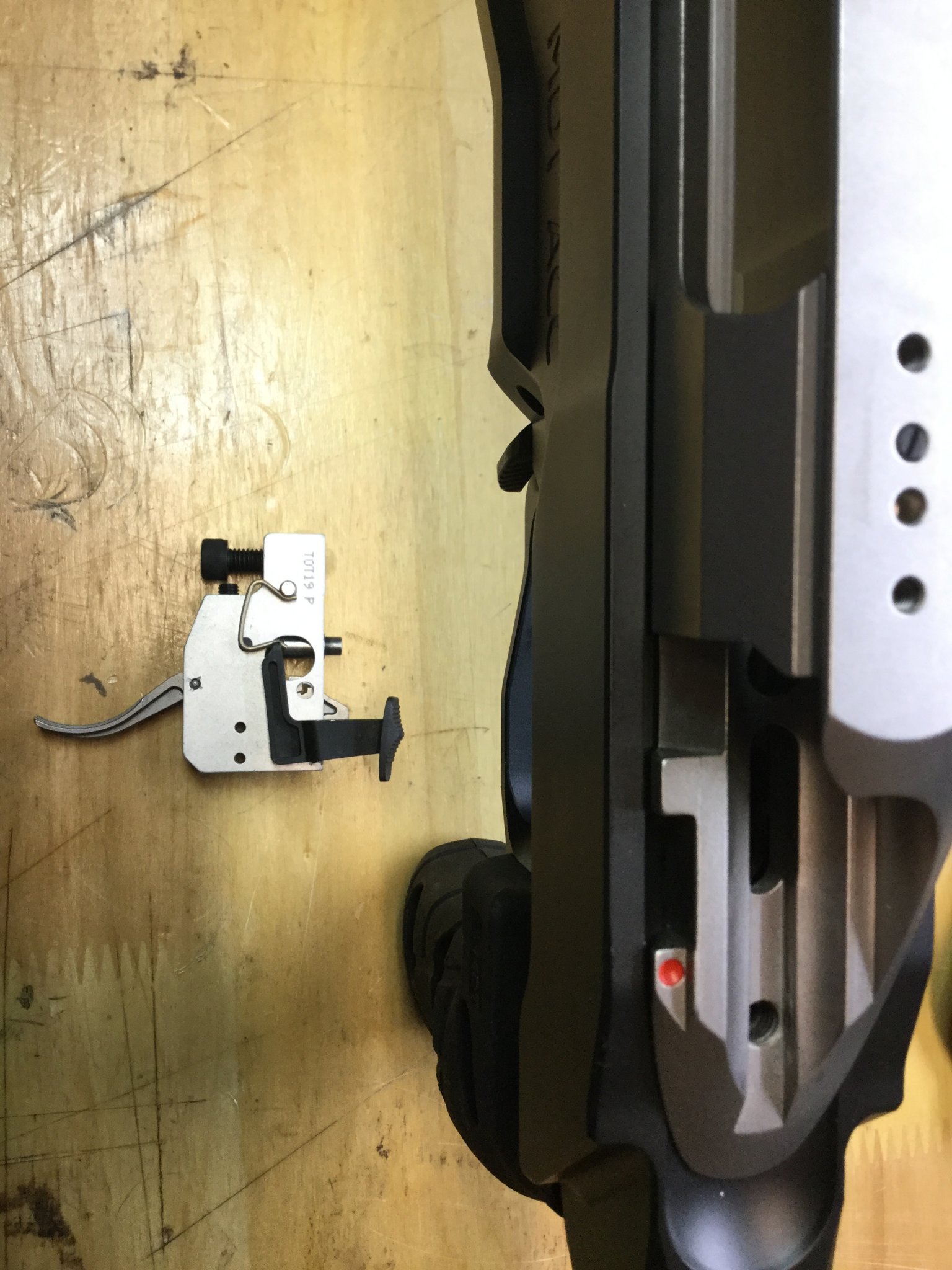

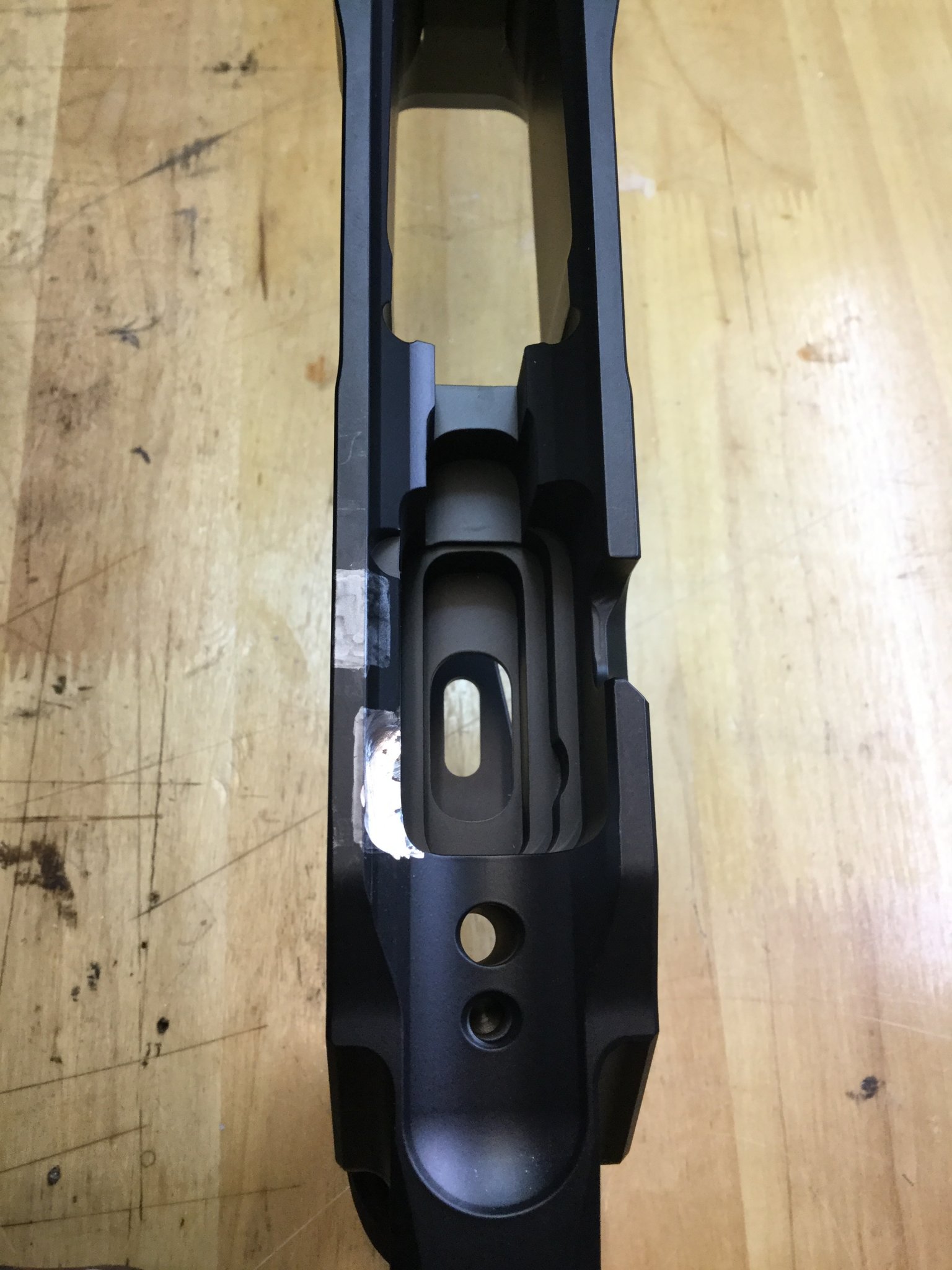

Sorry for the late reply, but I did it on a regular ACC with a Dremel and some files. Lay the action in without the trigger group so you can mark the cuts.
For the safety/trigger relief cut, get the dremel router attachment so you can adjust the depth of the cuts. The top edge of the chassis is enough for stability (nobody will see this relief area, except for you).
For the bolt relief, I started the vertical cuts with the dremel. The bottom angle area was started with a dremel then finished with files.
Edit to change techniques.
