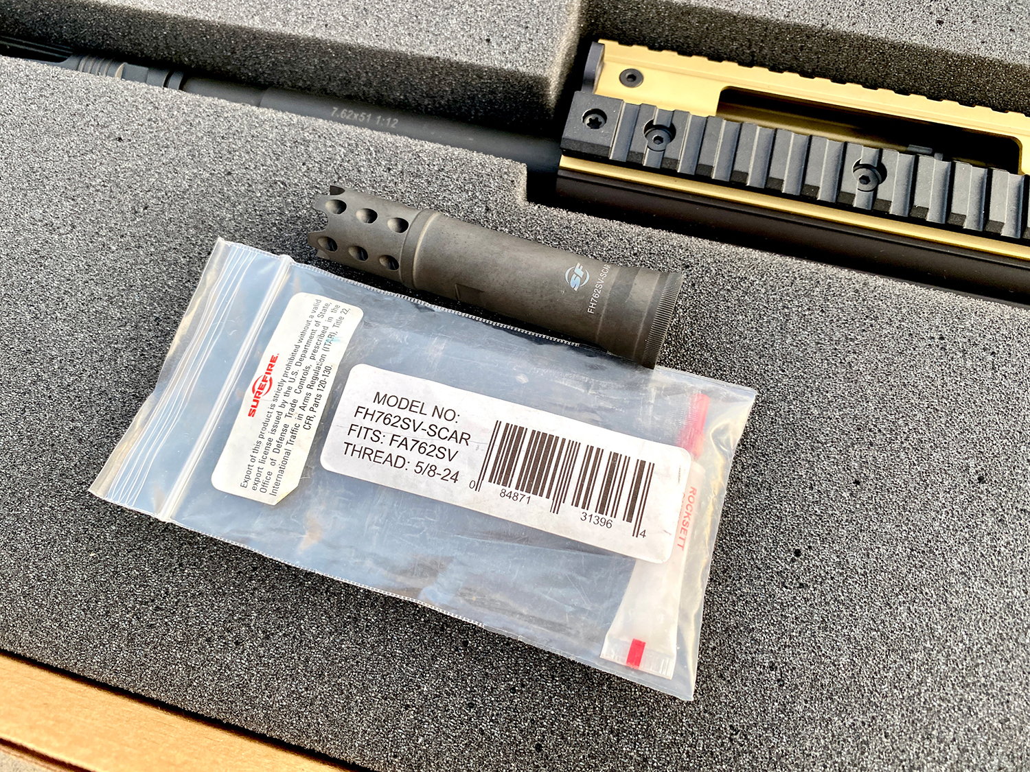

Have I ruined my Accuracy International AT?
SPRword
Sep 24, 2022
54
19
Minnesota
Well gents, for those of you who remember, I posted a week or two ago about an AI AW that I come across locally. I took everyone’s advice and passed on it. To my profit, I came across a very reasonably priced AT pretty soon after this that arrived today. It came with a surefire muzzle device installed that I attempted to replaced with an ASR mount.
In the process of removing the extremely tight Surefire, the barrel itself came loose in the action. Remembering that these have removable barrels, but with no idea beyond the basics of how they work, I removed the barrel lock screw completely, unthreaded the barrel from the action to continue working on removing the muzzle device in my vice, and rethreaded the screw back in so as to not lose it. Now, after googling how to reinstall the barrel, it’s come to my attention that removing that barrel lock screw entirely is explicitly prohibited in the manual, as is threading it back in without a barrel in the action. Basically I did this entire process exactly the wrong way. I should say that based on the feedback that my Allen wrench gave me, when I unthreaded the barrel lock screw it was not torqued to the recommended 49 inch pounds. I also didn’t thread it in very tight after that. Hopefully that helps me here, but I’m not an expert as my conduct clearly shows.
Key take always- when it comes to an expensive gun with a unique feature, read the manual BEFORE you do this. With all that said, I’m wondering if anyone here, maybe an AI armorer or similar, can tell me how screwed I am? Thanks in advance everyone. Learning experience for sure….
I personally don’t think you’re screwed at all. I know several member who have taken them completely out. I’m sure some have stripped the head and replaced them
I wouldn’t gorilla wrench it back in without the barrel. I’m assuming they don’t want you removing so you don’t cross thread it back in the action
I may be completely wrong but it’s just a clamp on the threads of the barrel. Pending you don’t cross thread the screw or pinch the action so tight you can’t thread a barrel I can’t see where it be an issue
Call mile high. I’d be interested in what they say. I’ve seen this in the manual as well
Reactions: kthomas and SPRword
The only worry removing the lock screw is dropping the washer into the cavity under the action, it can be nearly impossible to get back out without debonding the action and removing it from the chassis.
If you really want to screw things up, tighten the lock screw without a barrel installed in the action...
Reactions: vh20
Considering I did tighten it back in without the barrel (not super tight,) what kinda trouble am I looking at?
As an aside, what is the torque spec for the actual barrel mating up to the receiver? May as well do that right if nothing else.
I go hand tight on the barrel. Then snug with this tiny barrel wrench I have. Enough I can remove with the same small wrench when needed.
Loosen two turns and see if the barrel threads in smoothly to the action.
I doubt you hurt anything
If you tighten the lock screw down without a barrel in the action you can pinch the H-cuts in the action together further than they were designed to deflect and potentially damage the action, making it difficult to install a barrel in the best case or breaking one or both of the H-cuts off the action in the worst case.

Surefire brakes (not breaks) come with a packet of "Rocksett" *stuff*.
It's kind of like locktite for familiarity sake.
You'll have to heat the brake so it will come off (that is, if they used the rocksett shit) .
Been there, done that.
Don't lose the timing shims if there are any on there.
Acetone should remove any rocksett residue if need be.
Don't get any on anything but the barrel.....it will fuck up most finishes.....like on the chassis.

Someone just posted a surefire brake in the for sale section.....scuse me for ganking the pic.
You can clearly see the rocksett tube/packet thing in the package.
