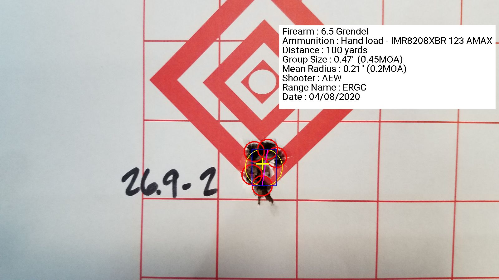

I've been working on my Grendel and I seem to have a very low node and another not really close to top end. I'm going to work those two and see which I choose.

Think I'm going to stick around this node and play up or down in tenths.
