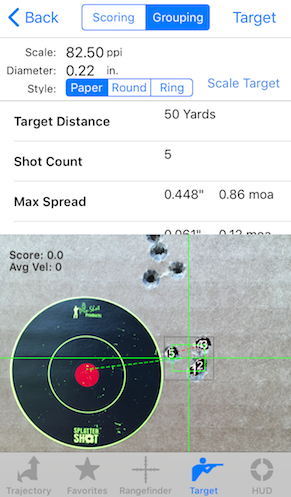

With CCI SV I can get about .5" at 50 yds on a good day if I do my part.
Haven't really taken the time to shoot good match stuff through it.

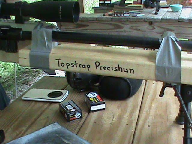

I've experimented going the opposite direction with one of my better shooting long-range rimfires. It shoots just as good now as it did in it's original stock. I've thought about having a bounty for beating it at my matches. Win 52-C that shoots incredible, no bedding, action just hangs off the back of a 2x4, poweraide bottle for a cheek rest. Call it Ugly Beddy.
