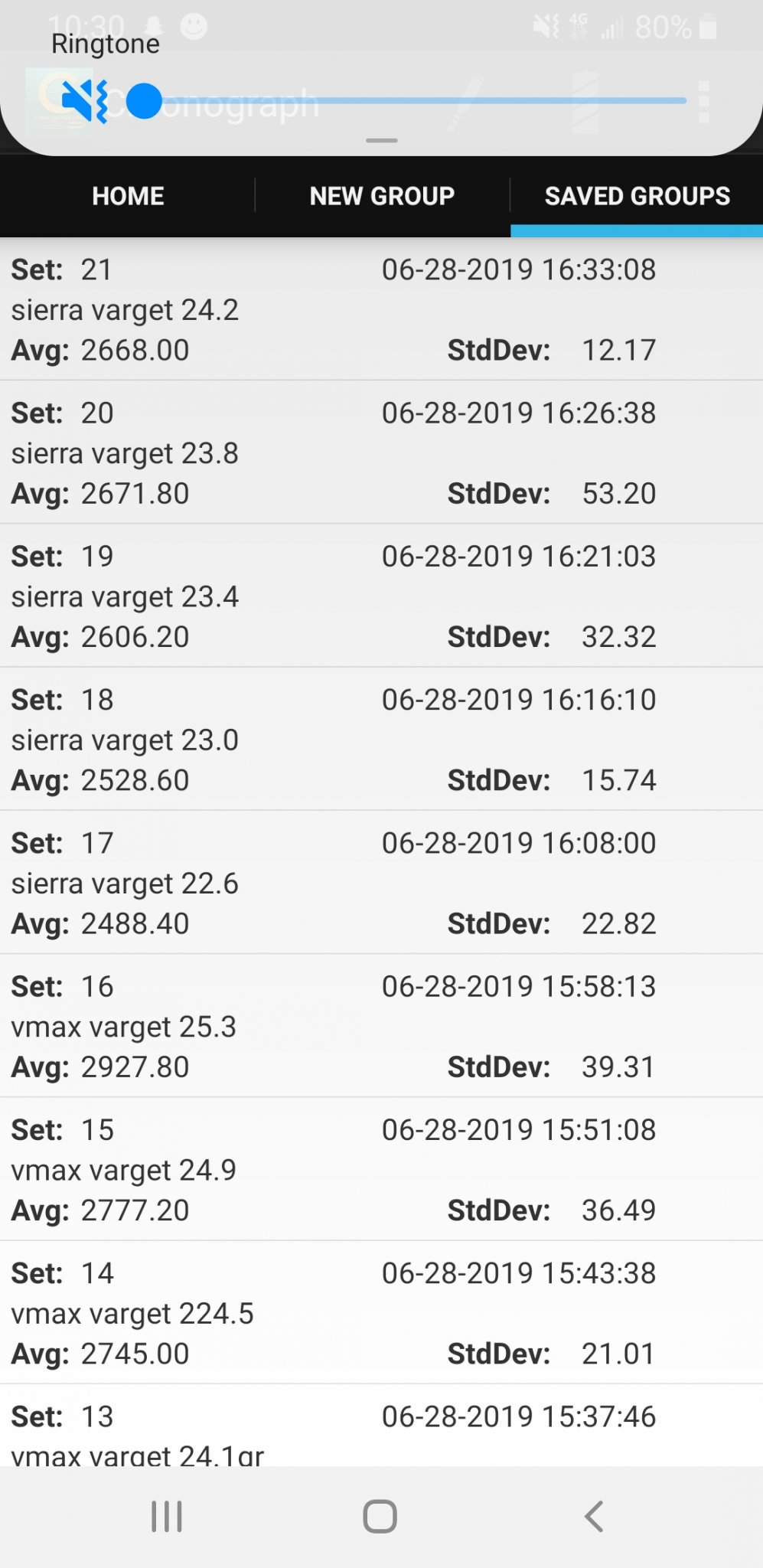

So I worked up some loads for my 20" woa using varget. I went to do some testing working in .4gr increments from minimim charge. My standard deviations were atrocious most of the groups. Im talking from mid 30's up to 50's with 1 group going down to 11. I also shot some 60gr V-maxs on varget with similar results. Has anyone else had this experience? Using BR-4's and Frontier brass. Any input would be helpful because im scratching my head. Of course new as I am I dont have a lot of reloading experiance.

I am using a gas gun. And yes that is my SD I was thinking it may have possibly been my fault. Cant rule out human error. Im pushing my shoulders .002" with a possible .001 variation. My seating die isnt leaving marks on the projectile that I can feel or see. Ill admit im not sure how to test my neck tension after crimp. Im using the lee factory crimp die if that helps. No shavings on anything that I have seen.
I'd bet it's just variation in neck tension. Run a ladder test, find a good velocity node, then tighten up your group by adjusting seating depth and shoot. Don't spend hundreds of rounds on load development
Would neck tension really result in such wild variations? And if you saw my picture earlier, I had one decent group with decent sd. Would it not throw all of them off. It seems that the one group is the exception. And they were all 5 shot groups. I would imagine in 5 shots at least one would have the same problem throwwing my velocities off.
You shot the test at 100 yards so SD variance won't show up as well as it would at say 400-500 yards. Neck tension can effect SD, but depending on the variance it may not effect it much. Once you start stacking inconsistencies such as neck tension, a tenth or two variance in powder and a few thousandths in seating depth, yes SD will really start to grow. Best and fastest way to find a load to minimize the impact variances will have at distance is to find a good velocity node and run it. In regards to your groups, have you ruled out any possibility of shooter error or inconsistencies that could have effected the group sizes?
As I said I cant rule out any human error. Are you suggesting that my high SD may not be affecting the large groups I encountered? Im not a precision shooter (yet) but i do believe my skill to be better than the groups i was seeing. Maybe an off day is possible. Most of the shots felt good. Zoning in on that one good group/sd seems to be a start
